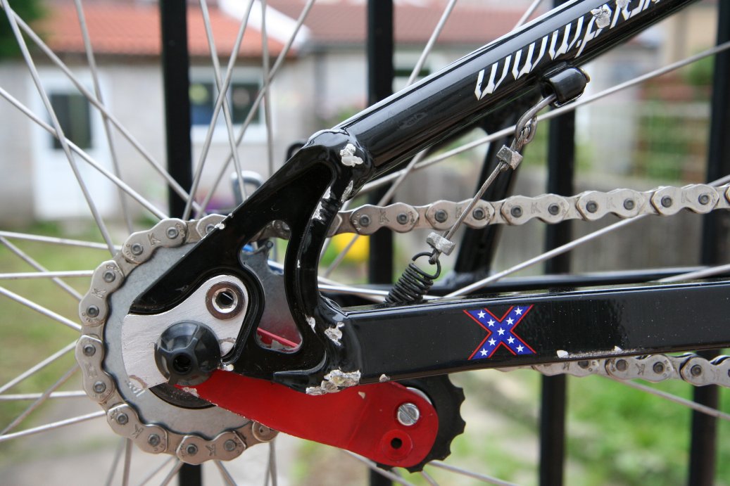

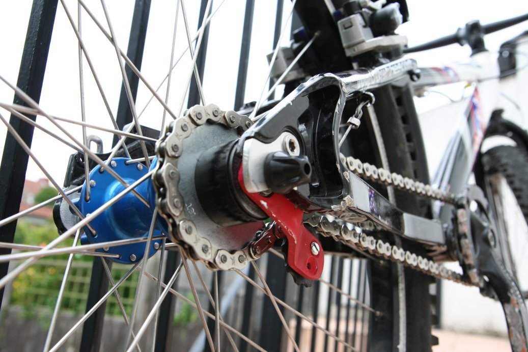

The spring is from a dead sora mech The arm fits over the axle and is free to move. There is no way it will ever get snagged. Check it out next time I see you out Rowan and decide for yourself. A pivot half way isnt necessary. The spring is essential to hold the tension in this version. If I go to a frame with no cable guide then i'll make a clamp to suit the seat stay. You can set the tension by the length of the cable holding the spring but it doesnt need much to hold it.
The 3 i've made work a treat. This is the latest configuration. I keep making them because I find simpler ways of doing it. This is a keeper. Now complete with blanking replaceable dropout plate.
