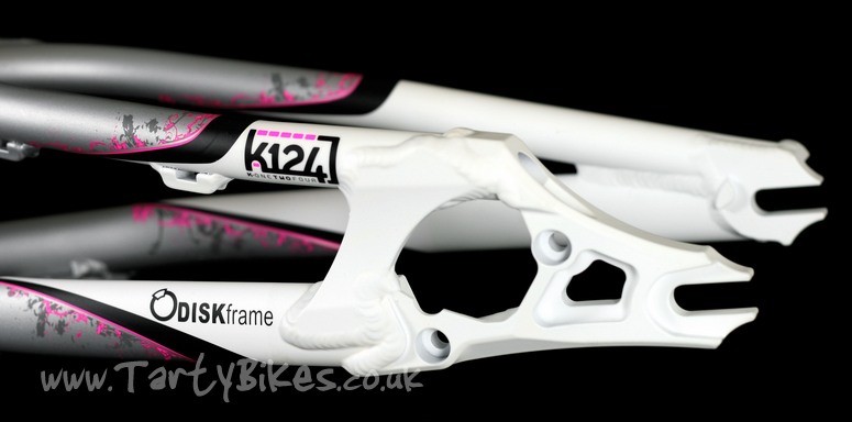

Laurence--Trials, on 15 December 2010 - 01:55 PM, said:
why they go to postmount? what are the advantages of it?
1. Increases brake power / bite
2.Now you can use another disc brake , not only Hope brakes on Koxx frames
3.You can adjust your caliper ( left-right position in each bolt) -there are a lot of advantages under this one for Hope brakes !!!
4. Maybe some grams saved
5.It`s something new in trial sports :lol:
Cheers
Edited by kristaps
1. Why/how?
2. Fair point, however we all know that the Mono Trial is the best trials brake available.
3. You can do that with IS mount, and it;s more guesswork with post mount than with IS - at least with IS you KNOW how much you are adjusting the caliper by (the thickness of the shim used).
4. Nope, it's heavier
5. That's bad, it means we now have two different types of brake mount in trials. As soon as any adaptors are required customers get confused as it is, this makes it even worse!

My english isn`t good and I can`t say all what I want to say, but I will try to answer.
1. IS mount are much more flexible . Compare those 2 distances. Post mont is much more stable on frame.
2. Not for all riders. A lot of people prefer another brakes ;)
3. With IS mount you can change only distance from frame mount to brake mount. You can`t change caliper angle. (ok with shims-but it`s absolutely wrong)
With post mount you can adjust your caliper in almost all directions
4. You now the weight of new hope mono trial?
Exactly, soon we will not be abble to change a frame only anymore...or other parts...
If you want to ride Atomz frame you need a specific hub, i you want to ride this frame you will need postmount brake, maybe a specific fork for the rockman frame with tapered headtube...etc....
This leads us to have to change the whole bike when you want to ride a different frame....maybe it is what they want...
It is nice to see some really good improvments in trials parts.
But some choices are questionnable.
In this case 116mm spaced frame...why?
And indeed even if these frames are probably high end frames they quite look like "cheap" neon frames....
If it is not stronger than a Rockman frame, it does not worth the extra cost......
You shouldn't really need to do that though, so it's not really a benefit as such? It just makes setup more time-consuming...
