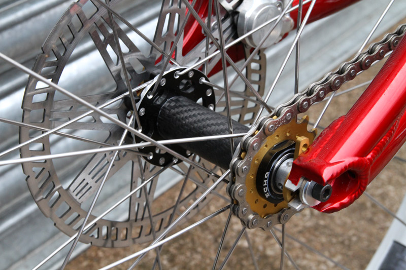

I'm amazed that the bond between the flanges and carbon fibre bit are strong enough to cope with the forces in the rear wheel.
Laquer the cf (Y)
Glue for the win!
I would have said the forces in the carbon part of the flange are more likely going outwards/inwards axially myself, rather than torsionally, which as stated, is handled by the spokes and the invisible hand of GOD.

The hub has actually died to an extent - however nothing to do with the bits that people speculated might break! The fibreglass inner layer was too soft and deformed, so the hub started creaking and it was really annoying. The carbon was intact and the glue held well, but I had to destroy it to remove the flanges. Got another centre piece curing at the moment made of 100% carbon - braided sleeve and pressure tape - hoping my freezer will be cold enough to shrink the mandrel to release it...
Im not sure how the coefficient of expansion of carbon compares to aluminium. The only recent experience of thermal expansion I have is heating crankcases in the oven and freezing bearings, they just drop in where as cold you cant even hammer them in; of course thats taking extremes of 100°c aluminium and -5°c steel.
If you can cap one end of the mandrel (assuming its tube), spray a load of plumbers freeze spray inside, all being well the aluminium will contract enough; maybe even try it with a warmed piece to begin with.
