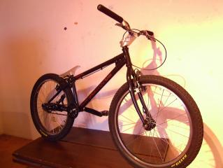

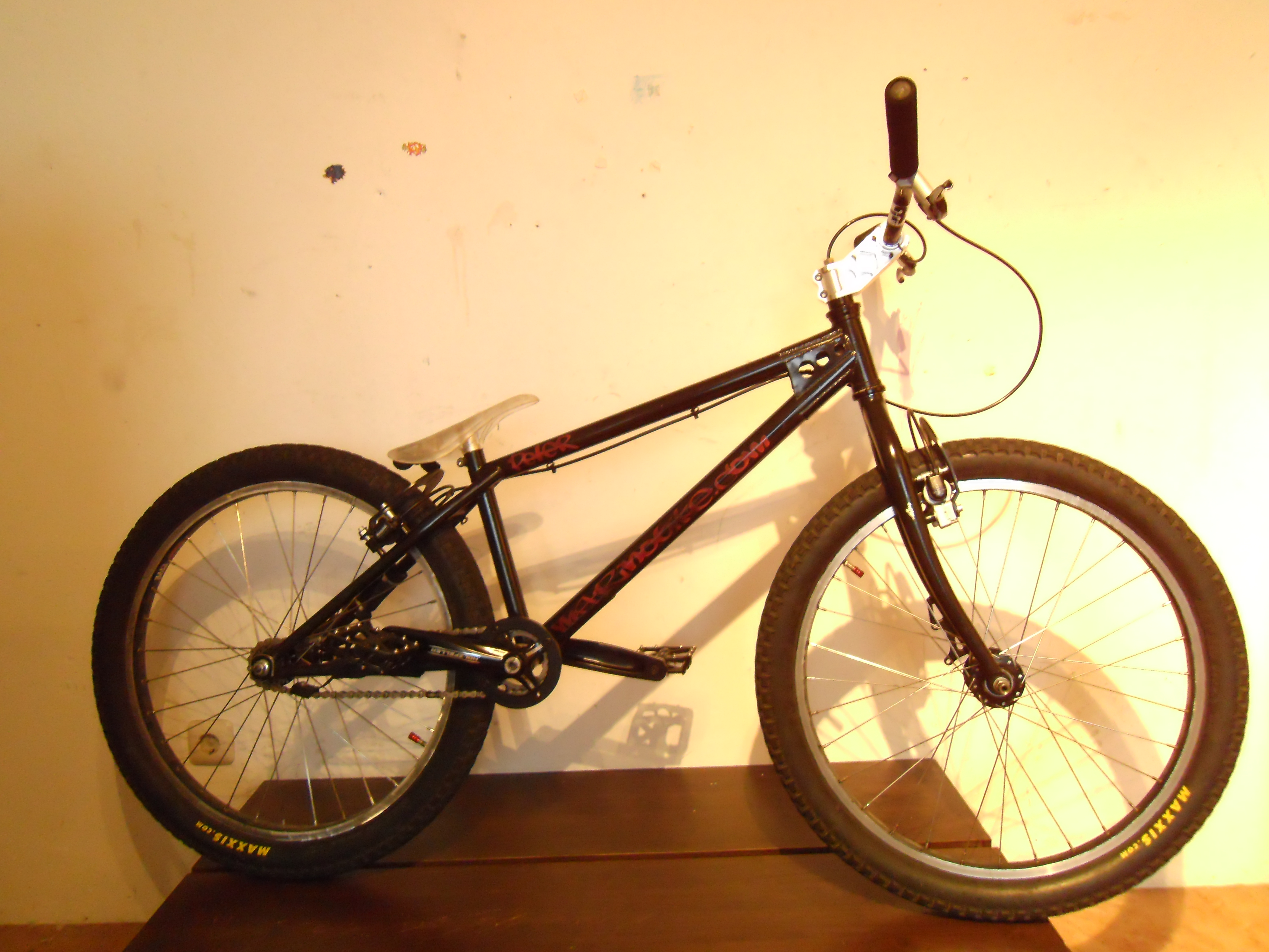

hi there
my bike:
Frame:Marino custom
WB:1000
CS:365
HT/ST:73/74 deg.
Fork :Onza Zoot 405/45,steel
Bar :Brave Slammer 35mm rise,CrMo
Stem:Azonic WF 100/25deg.
Headset:FSA Pig DH Pro
Hubs:Front:Marzocchi QR20,converted to 9mm hollow axle
Rear:Veltec SS,converted it myself to 54 clicks(2long,2short pawls)
Rims:Sun Rhyno Lite
Tyres:Maxxis HolyRoller
Spokes:Alpina butted
Brakes:Magura HS33 2009 with red magura pads
Saddle:KHE integrated
Crankset:Holzfeller Trials 22T,Howitzer Team
Pedals:Wellgo
weight 13kgs
post-30389-0-14087300-1316370721_thumb.j
thanks guys
it looks shorter than it rides,with that stem it shoots you up an obstacle from standing next to it with the front wheel nearly touching it.
i had a kore lite3d stem on it(also oldskool) but it was too low.
i wish i coul paint over the graphics,maybe in winter.

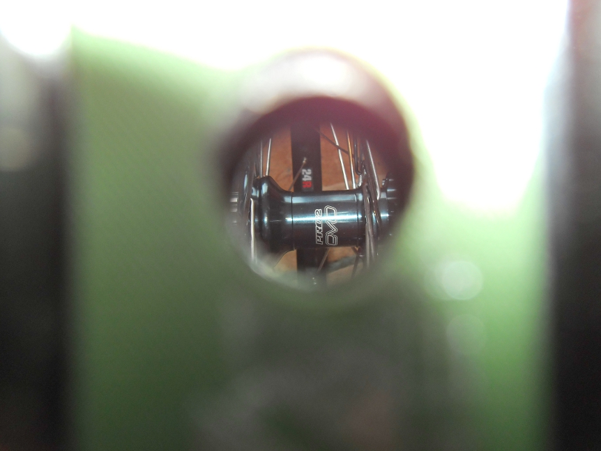

this baby is gonna get into my rear triangle soon.just finished lacing 5 minutes ago.
finally a member of the hope club.hope hope deserve their good name hope.hope so.
hub:hope pro 2 evo ss/trials gunsmoke
rim:atomlab G.I.
spokes:sapim strong
no comments about the rim and spoke wight please,i´m not a weight weenie at all.

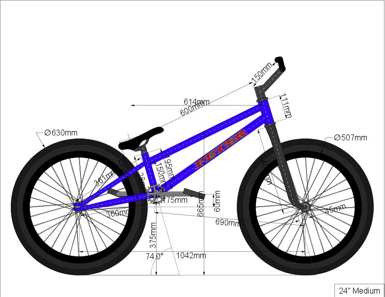

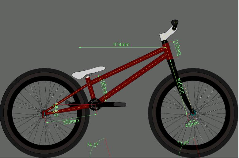

new frame coming soon...
post-30389-0-26416000-1323121098_thumb.j
as a wheel builder as my trade, I can't help but call you out for not having the Hope logo showing when looking down the valve hole :-
Should be a good strong combo, I build Hope hubs onto Atomlab rims very often and those rims are extremely stiff.
