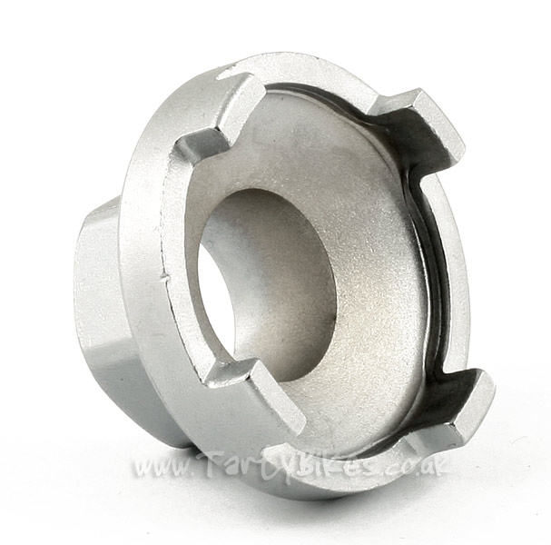

Im needing to remove my echo SL freewheel to fit a new half ring but im in need of the tool to remove it!
I live 5 minutes away from a pretty large car shop, they have lots of tools, I was wondering if anyone has any ideas of a similar looking car tool that i could use to remove the freewheel. Has 4 prongs that slot into the grooves. i know its a long shot but was wondering if anyone had any ideas.
Got a mig and some steel? grind some bits up and stick them together with the mig to make a 6 prong tool...clamp it in the vice, drill a whole down through it ( m8 ) use a long m8 with penny washers to bolt the crank to the tool. Scaffold bar off the end ( pedal removed ) and hope your tool holds :)
Edit: Or if you have some round solid/ very thick tubing ( 40mm ish od ) grind some chunks out to tie in with the cutouts in the SL and use that instead of the bits of steel welded together.
Edit 2: OPr even better an appropriate size socket that you could grind to fit :D
Edited by Alex Dark
Even a Halfords or somewhere like that would have a freewheel tool and would be open on a weekend. I'd have thought that would've been a million times easier to sort out - especially if your bodge job fails and you're back to square one anyway.
One thing worth mentioning is that if you get a bike shop to do it, I'm pretty sure they'll do the usual thing of clamping the crank arm in a vice, then trying to use the tool with an adjustable spanner to remove the freewheel. We've had plenty of customers phone up complaining their local shops can't get their freewheels off because they're trying it like that (apparently it's "because TartyBikes threadlock freewheels on" - even though that's obviously not the case), so make sure you tell them to do it by clamping the tool in the vice, bolting it to the crank then using an extension bar on the crank arm.
Standard, 4-prong freewheel removal tools fit Echos. If they don't have a normal tool I'd be pretty shocked (although it is Halfords, a store of which earlier in the month couldn't work out how to assemble an already assembled headset...).

Well that was a fail! Two of my mates work at halfords so was trying to get it off with above tool but the vice was letting go, and we didnt have that much leverage. so was pretty sad.
So my mates lent me the tool from halfords and taking it to my work tomorrow where we have massive vices and big bars for leverage !!
Why is that, out of interest?
On the times I've done it (granted, only a few), I've always had the crank in the vice and an adjustable + bar on top, and it's worked easy enough.
Is it just better for super-stiff ones, and I've been lucky all this time?

And in regards to the freewheel, when I tried to take my ENO off. It took a few grown men and a 4-5 foot long scaffolding pole over the cranks for leverage to get it off. Freewheels are bastards. If they come off easily with no extra leverage you're either hulk or something is wrong with the threads!

Well I took it to work, we put it in a massive vice and got a 6ft big bar of metal on it, straight off! I love the laws of physics.
