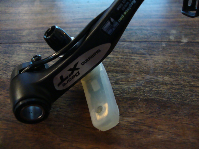

Largely personal preference , but I'm very satisfied with
  • Avid SD 7 levers
  • Oddesey Linear slick cable
  • Shimano XT arms
  • Generic clear pads a la Trialtech etc
  • Lightly ground Onza Ronnie rim
  • Stiff booster
post-3439-0-16213200-1323593700_thumb.jp
Beyond that it's all about careful setup ,cutting the cable cleanly and ensuring that the cable / noodle don't exert force on the brake arms . In my case running a full length cable seems better than interrupting the outer at the frame's stops .
