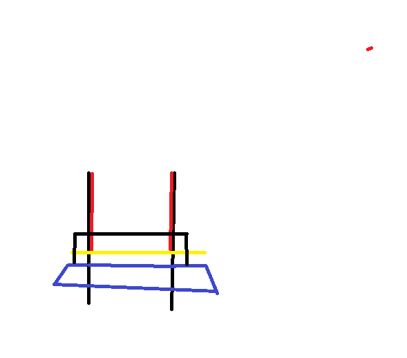

the red is the insert in the tube
the blue is top of headset
black being the spacer
yellow the shear point
its kool if tarty have agreed to using the spacer, but just take care and keep an eye on them
The spacer is underneath the cup, not above it and no, Tarty did not agree to this because I only just came up with the idea. It saves having to make a new top cup, instead all one needs to make is a nice fat and tight spacer which will go underneath the cup. Would need to buy a headset which has really long inserts but that's not a problem.

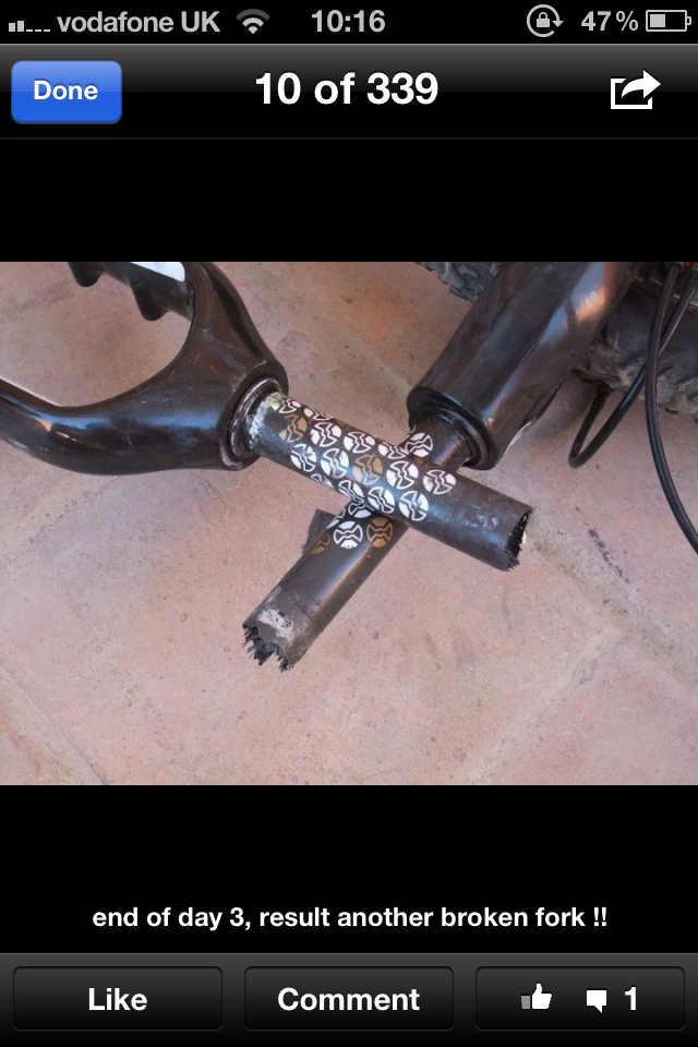

That's not 100% true... I'd say run an insert or risk loosing your front teeth!

Maybe it's because he was trying to sell me some, looks like that incert is the answer!
Any pics where you can see the frame he's uses ben ?
Which frame does Iciar use? I recognise the name but don't really know much about him. If it's a Sky 2, it'd be interesting to know whether he's got the 'new' Sky 2 or the 'old' Sky 2...
He now has the newer sky 2 but I would guess that he was on the sky 1 when he snapped the forks, same frame as vince was on when he snapped his forks at val d seare
What's the stack head of the sky 1 mark ? Around 117mm with the headset at a guess ?
