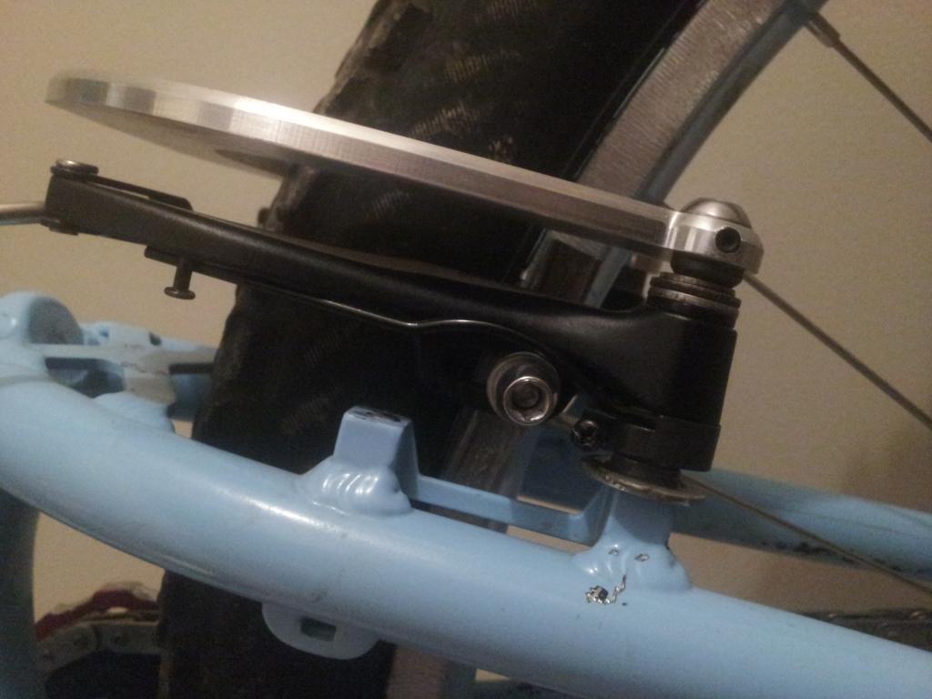

Recently started using a rear v-brake as I have suffered with arm pump for years using a rear Magura and so far I've had zero arm pump with the v-brake :) Only trouble I'm currently having is the hold the brake offers isn't as much as my old Magura was and also the look of the adaptors then v-brake then booster brings it so far off the seat stays it looks like a piece scaffolding hanging off the seat stays lol.
My current set up:
Shimano Xt lever
Odyssey linner cable oiled
Avid Ultimate

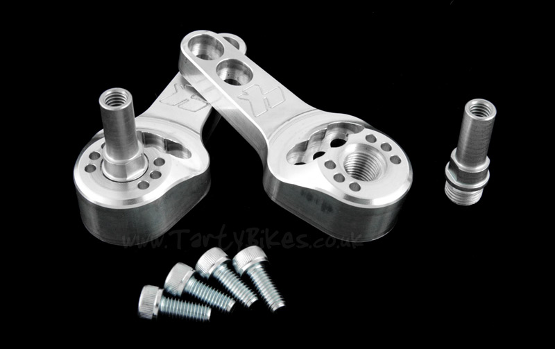

Tried Heatsink adaptors and Neon adaptors
TNN lgv pads
Generic alloy booster
Onza Limey 4 frame
I've googled the subject a fair bit and done some reading and found how to do it, Adam from Tarty said on another site "Bottom 4-Bolt hole + 6.5mm drill bit + M8x1.25 tap + M8 V post = job done."
Is it really as easy as that and also are there any potential issues I should look out for? I'm a competent mechanic working in the trade for over 10 years so pretty sure I could carry this mod out easy enough, just a little worried if it doesn't work out and I wreck my frame.

Looked to have a set up like this ideally
post-7131-0-52703300-1359150837_thumb.jp
