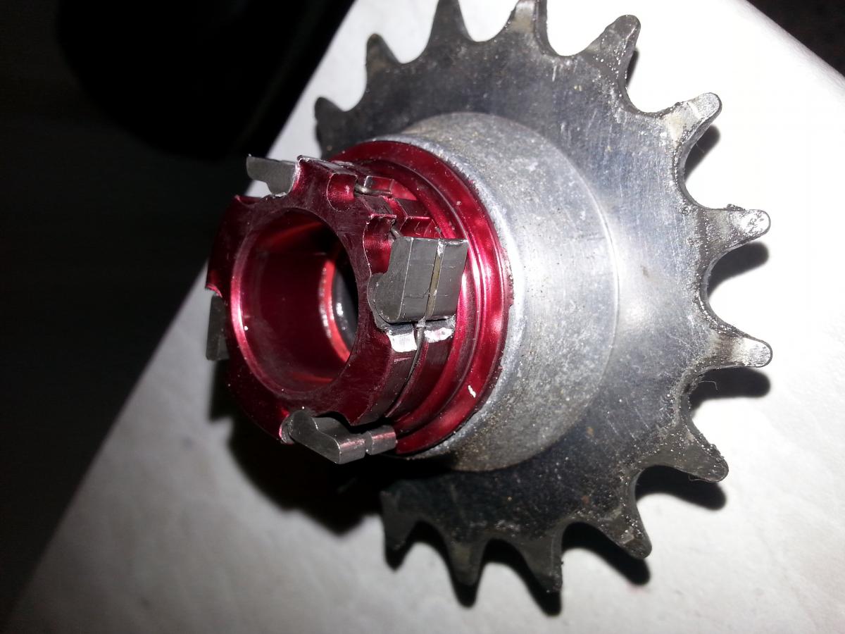

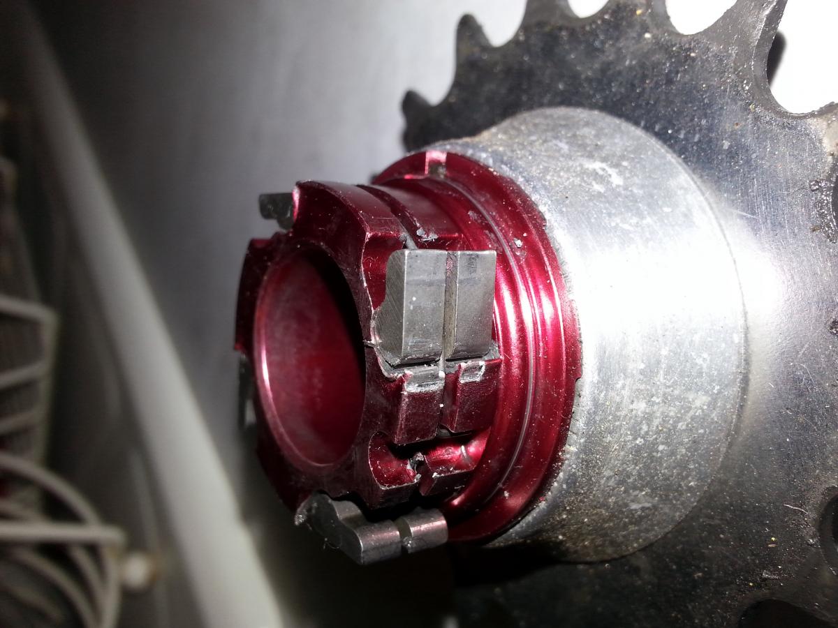

Well the enevitable happened. The Quanta XC hub with alloy freehub died. I know, who'd have guessed.
I'm pretty much decided on the Hope SS, but it is a lot of money. Are there any other alternatives currently available? I was looking at freewheel hubs, various brands offer hubs for around £50, then another £50+ for a reasonable freewheel. So as far as I'm concerned for a 'mere' £50 extra i could have a 'hub for life' ie; once I'm too old for trials, i can use on a regular bike.
Thoughts? Ideas?
