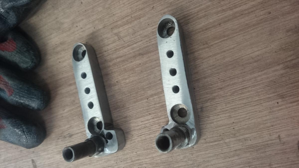

This is mine, set of rustled up vbrake adapters, the prices of these things made me think I could probably make a set for pittance, rather then fork out £20/30.
Pleased with the outcome of these, not threaded in the brake bosses, just welded the back and tac'd the front edge.
Show me youres!post-37711-0-82653600-1431190760_thumb.j

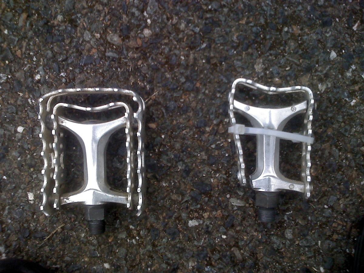

Not incredible, but I lostall my bashring spacers, so I took a disc rotor spacer and filed it out a bit, and because it has the 6 holes for the rotor bolt, the bashring sort of "locked" into the holes and didn't rotate when i tightened the freewheel. That or the immense amount of tape wrapped around my barends so they actually stay in place :P
I found the bashring spacers a week later, but this one is better. It's a perfect size so that it completely covers all of the freewheel bar the rotating cog itself.

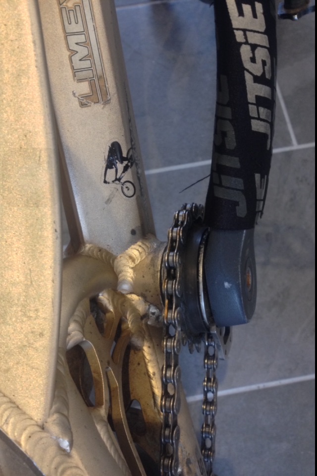

How about what the BB i made up out of bits off the 'shelf o' sh*te' over last christmas that I've dubbed the 'frankenbracket'
Truvativ ISIS axle
Drive side onza bearing
The centre tube section is from a shimano un54 square taper
NDS bearing is try-all
The BB cups are onza and try-all
The spacers the cranks butt up against are filed down onza ones, then faced on some wet n dry, as it's a 118mm axle
And the bolts are Trialtech m12.
5 manufactures, one BB! Works just fine.

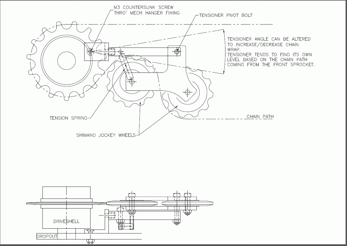

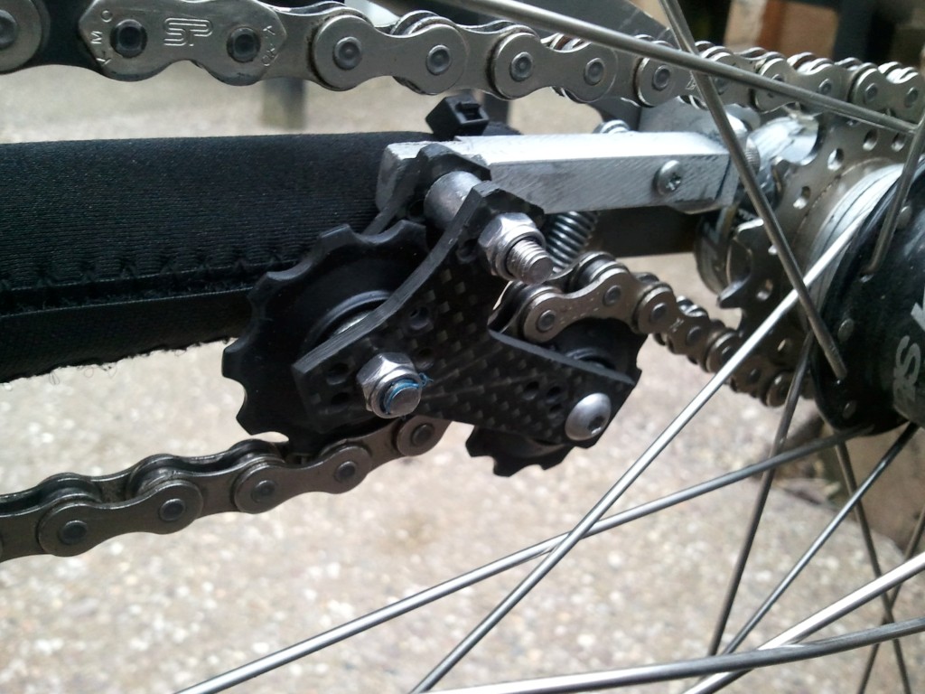

Forrteh, that tensioner is sick! I'm going to make something similar, iv bin thinking through ideas similar actually as I need a hub mounted setup but I need lots of chainwrap, exactly like youres, we're the pivot is did u use a bolt? Or a bearing? Interested to know how you got it to pivot freely
Edited by DAMON WATSON.
I'll do a drawing later when I get to work, it mounts of the standard mech hanger bolt. Weighs about 48g, tensions perfectly and cannot be hit unless something physically goes between the spokes and chainstay :)
Quick autocad drawing of the tensioner, I made up the dimensions/proportions as I don't have it here to measure but it's about right.
The carbon frame pivots around the top bolt whilst the tension spring pulls the rear pulley upwards. The chain wrap over both jockey wheels gives a perfect natural chainline with 18:15.
post-6335-0-55868400-1431509318_thumb.gi
looks perfect, i hope it will work with 18-14 just as well (A) thanks pal
Yup will work fine with smaller sprockets, to accommodate a larger rear sprocket the tensioner arm needs extending which can then start clashing with the inside of the chainstays.
Mine fitted just perfectly in the triton frame but there shouldn't be so much difference between frames that a little design work won't get around.

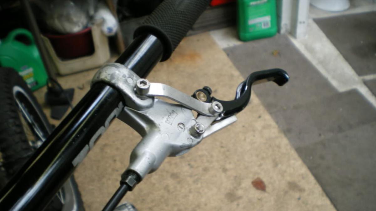

Mine. :P
Hope mono trial lever blade on an upside down 04 maggy body, because that's what I had and I wanted to ride the next day. :lol:
Worked really well, ran it on that bike for a few months.

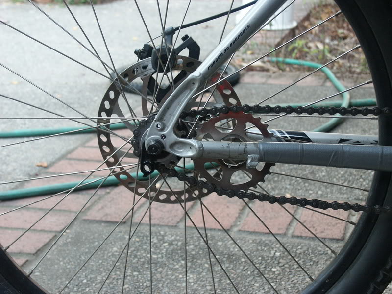

My first tensioner I made. Worked awesome and was super light.
My homemade v adapters. It uses the bottom 4 magura mount as the pivot point. One long 4mm bolt clamps the arm and adapter down.
Edited by toyota200x

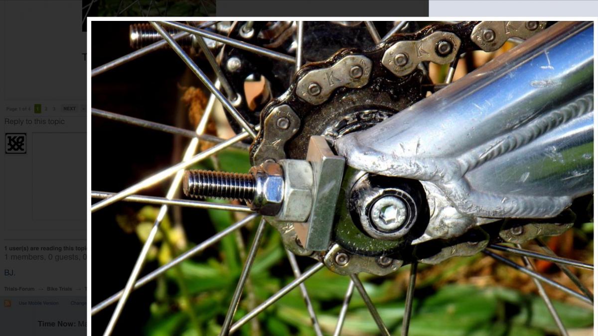

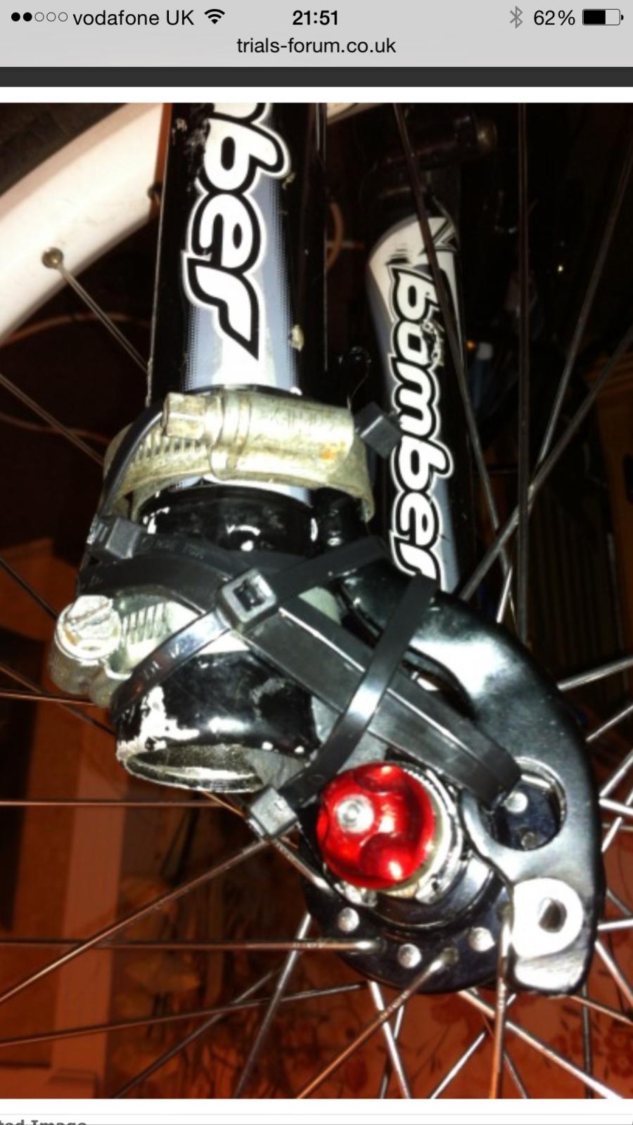

Not a pic of the my bike, but I did this once just to keep tension for a group ride. Its called a 'ghost tensioner.' Snapped my hanger the night before and couldn't get the spoke tensioner to work out. This made things extra sketchy fun :) had it fall out a few times, but for the most part it worked.
