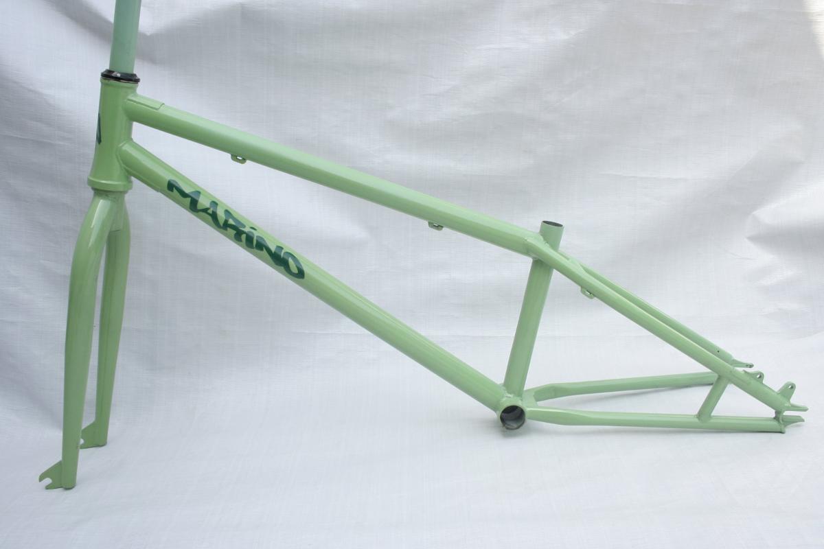

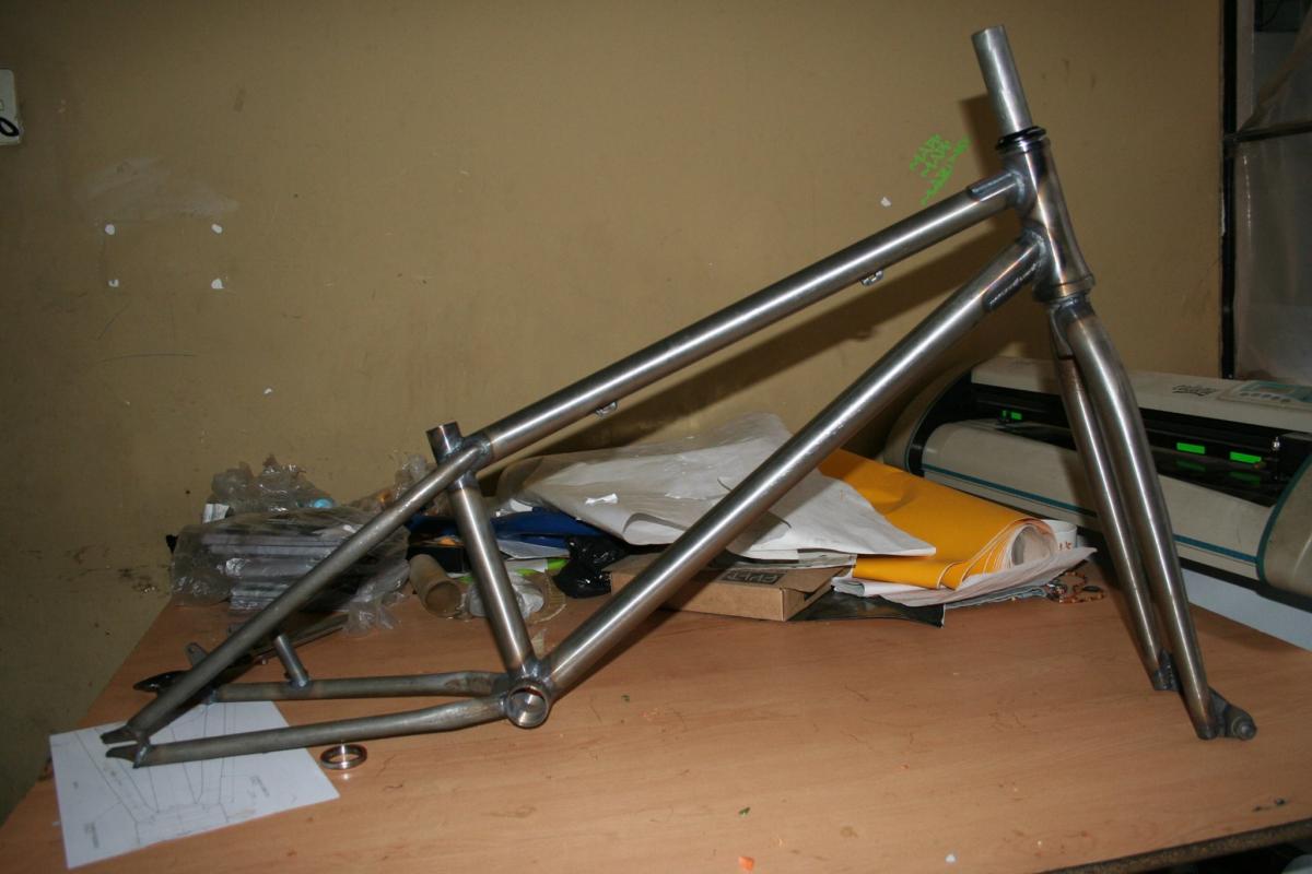

Marino frame, forks and headset.
Freshly welded, heat treated and finished
post-22185-0-94163600-1431857471_thumb.jpost-22185-0-40373900-1431857483_thumb.j post-22185-0-80980300-1431857495_thumb.j

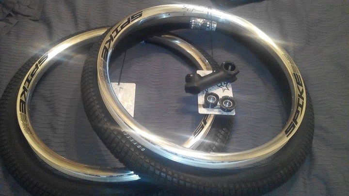

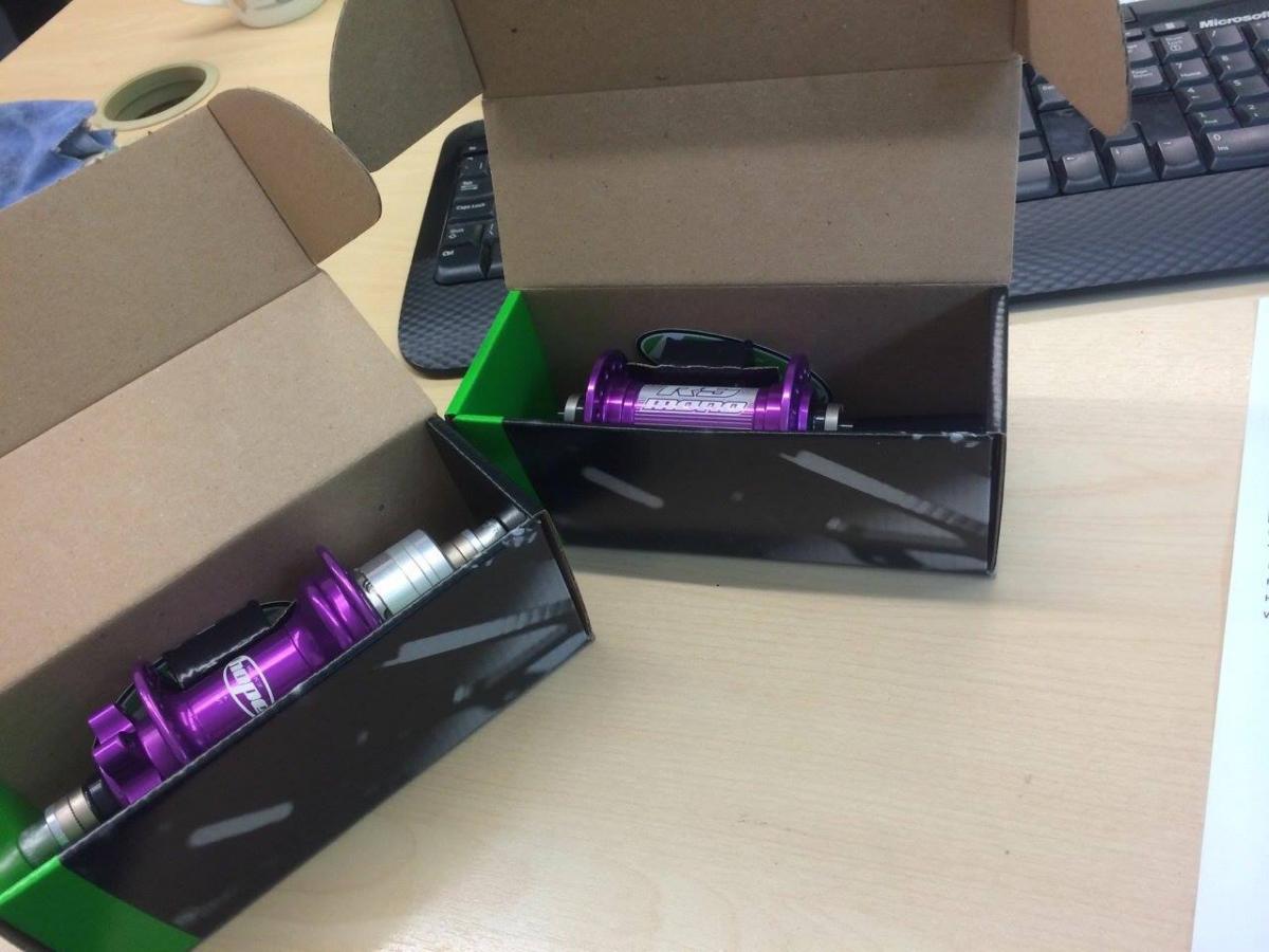

The first of the parts arrived little bit's and bats that seem to be always really cheap on chain reaction cycles.
post-22185-0-21597600-1431858021_thumb.j
The majority of the parts are coming from Trials addict who I have been lucky enough to have been on the team for the last 2 years now. The hubs, spokes, nipples, rear cog, lockring, tyres, chain, adaptor and rotor are all from Ben. The rims are from Sponge.

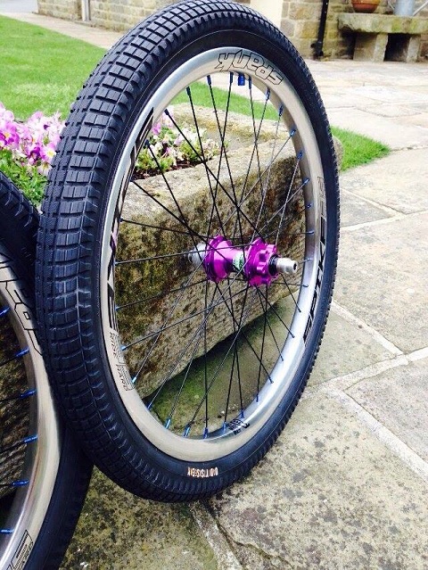

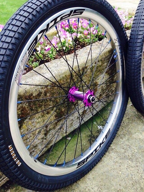

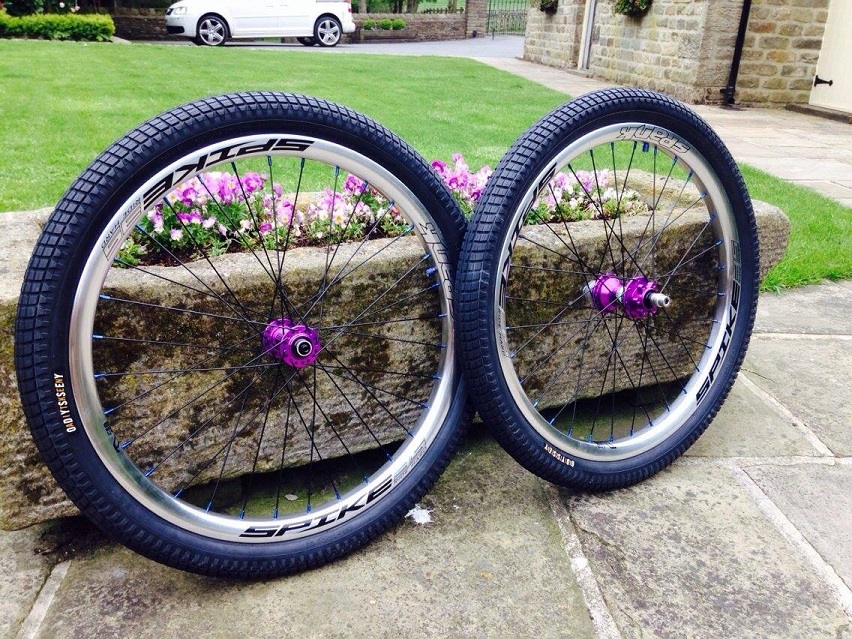

Laced my wheels up this morning and ran them over on the truing stand and pretty happy with how the colours came out in the end, for the last year or more I have had purple hubs, silver spokes on purple nipples and thought that I'd quite like to mix things up slightly so opted for black and blue spoke/nipple combo.
post-22185-0-79910500-1432554844_thumb.jpost-22185-0-18053700-1432554850_thumb.jpost-22185-0-38787300-1432554856_thumb.j

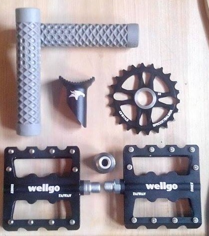

The parts left to get for the build now are,
Saddle,
Pair of cranks from DMAN,
Pair of Arcade bars,
Pair of brake pads (I will be using my spare m810 with new rotor also).

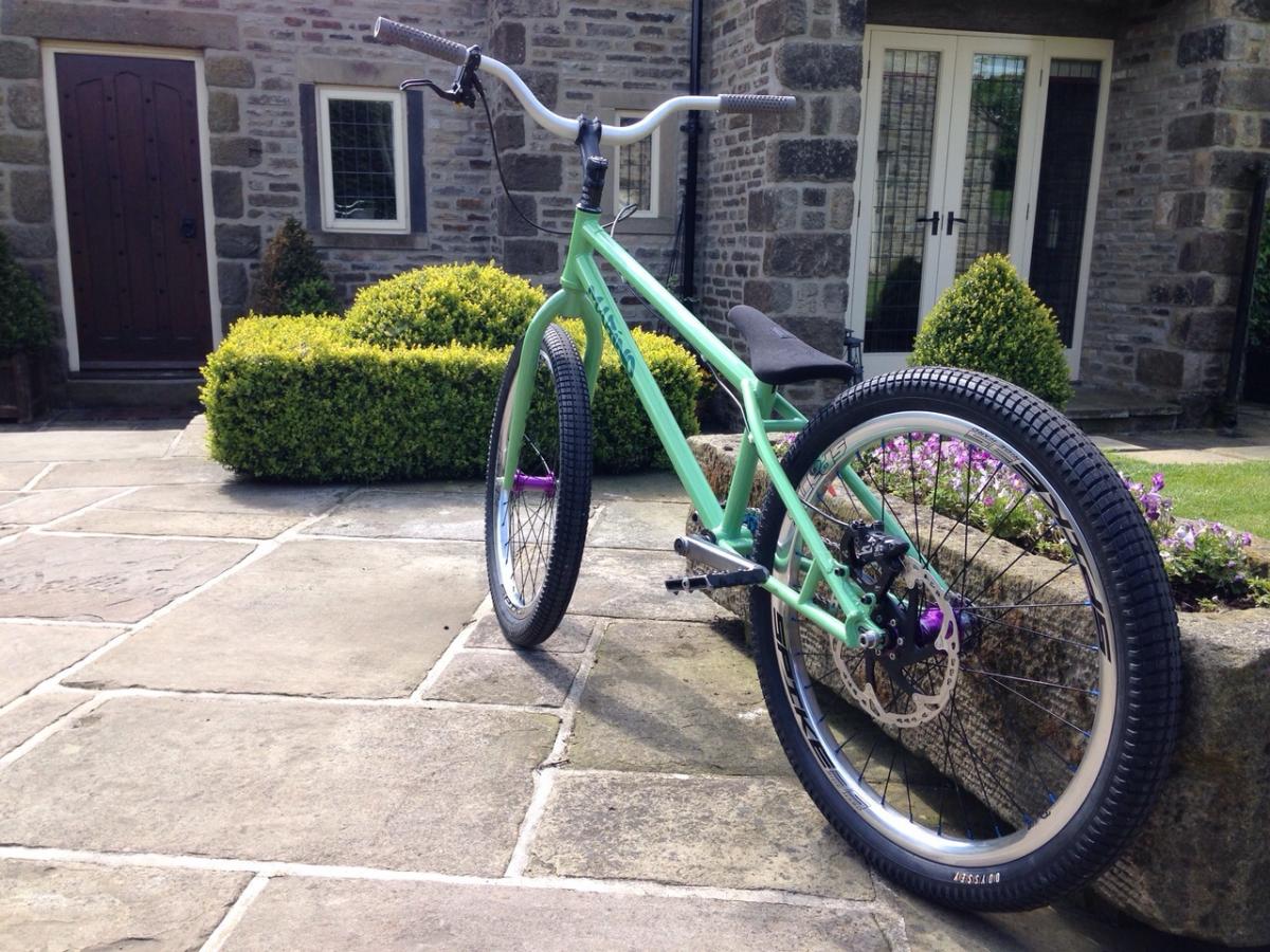

Ain't finished totally yet but here's it so far....post-22185-0-82112700-1433415462_thumb.j

You saying the headangle is 0.5 steeper than the Arcade. That's brave going to 75.
I'm sure there's a few people repping 75, I think Ben Rowlands was on 75.5 at one point. I'll be moving up to 74 though so don't worry, it'll be more like a longer console, my current geo is,
1015 wb
+20 bb
73.5 ha
367 cs
670 reach
so it should work out at
1012 wb
+25 bb
74 ha
371 cs
674 reach
The forks will be 30 rake like my current ones only with no disc tabs and I also wanted the dropouts to not be machined away like the current ones (for looks only).
Wait, wait, wait, wait. You mean I had to listen to you chatting shit about the BB height on the Arcade being wrong for as long as I did then on your own frame you make it the same height? You f**ker :P
  • Like 2
Ha pretty much, it's kinda the only thing I might regret about the frame but it's also a tad longer so I felt that might make it feel about right (for me). Going back from the Inspired to my older geo felt good for some things but also felt like a step back on other's so I'm hoping the slight change's make for the best of both. I'm now just toying with what stem to run with the Arcade bars that is niggling me.
Nice wheels, might try thrse tyres after seeing you ride yours.
Yeah I really like and get along with the tyres, they're slightly narrower than the Contis but not in a negative way. Their pretty clean with the lack of logos also.
