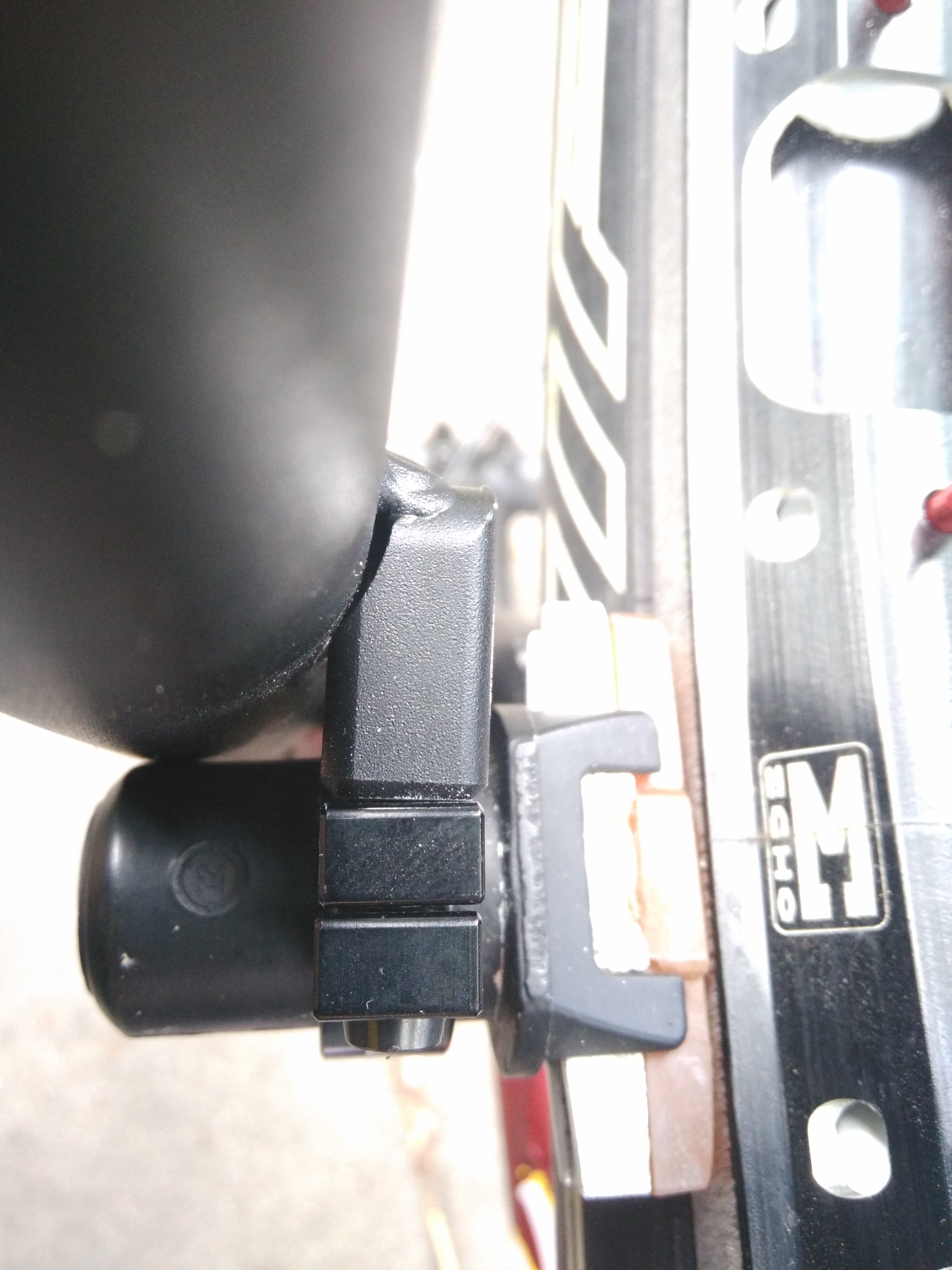

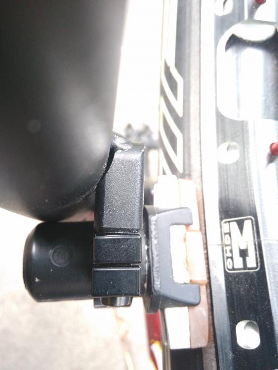

As you can see in the picture it doesn't really align so well as the Magura slave hits the leg of the fork. Would it be possible to put some washers under the clamps or are there any clamps that are a bit higher? It's in both sides.

Ok. Too bad that this has to be done. I'm curious whether the other forks have the same issue. Didn't expect that from Trialtech.

When we first got them in the mounts looked pretty low - checked them with a few different clamps and they fitted fine.  The Racing Line clamps are anomalous in a way, they're not made with the same dimensions as other clamps in the sense they have a weird slot spacing, but they're also mega thin/low profile to save weight.  This means the cylinders sit nearer the frame/fork, so in this case it's catching the fork.

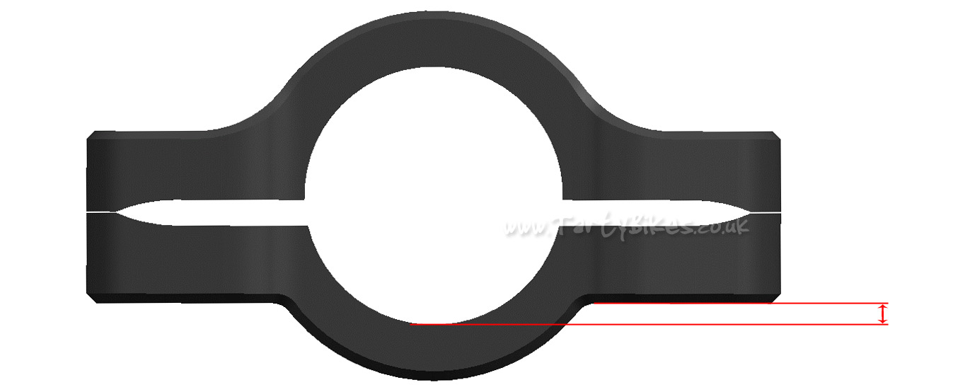

The curve on the rear of the brake mount itself doesn't quite match the curve of the fork leg, but they still seem to be square (having checked a set of ours):
Apologies for the shit photo, it's dark-ish in here so hard to really get it to show up.

Nice red arrows. So if Sport Lite isn't SL, what is SL?
