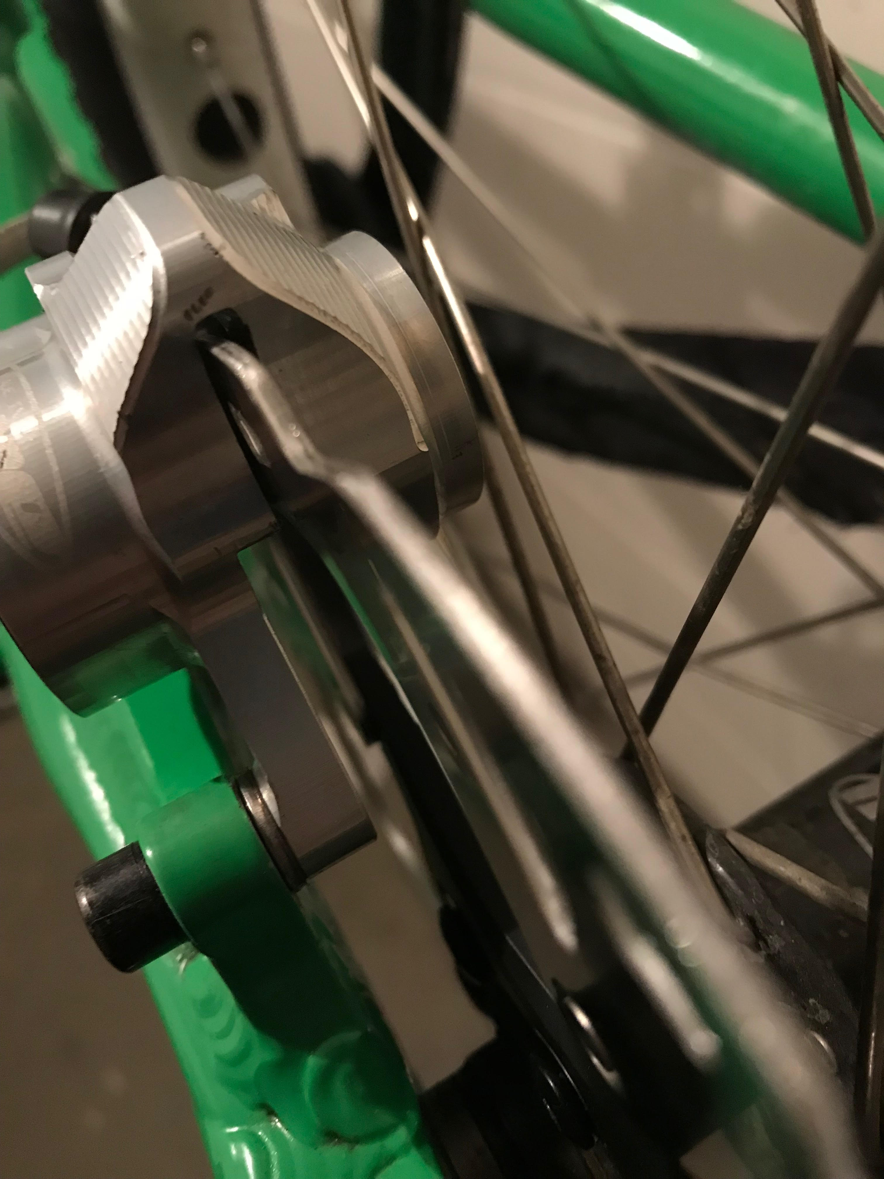

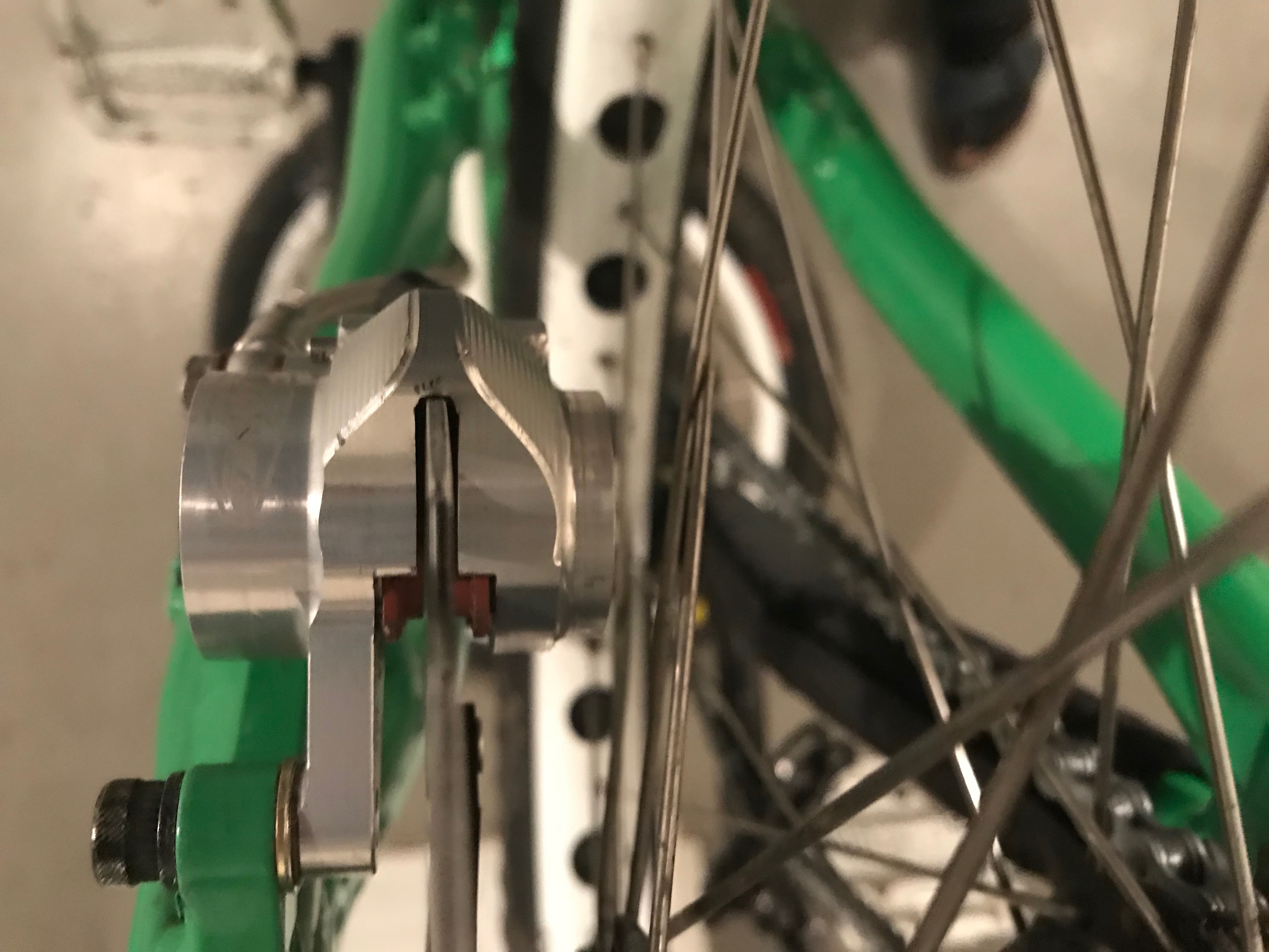

The problem is, when installed this way, the brake rotor interferes with the brake caliper vertically and i cant spin the wheel.
If i loosen the axle ab bit on the nds and move it a bit further down, the rotor is free. (See picture)
But im unsure if the wheel sits secure then...

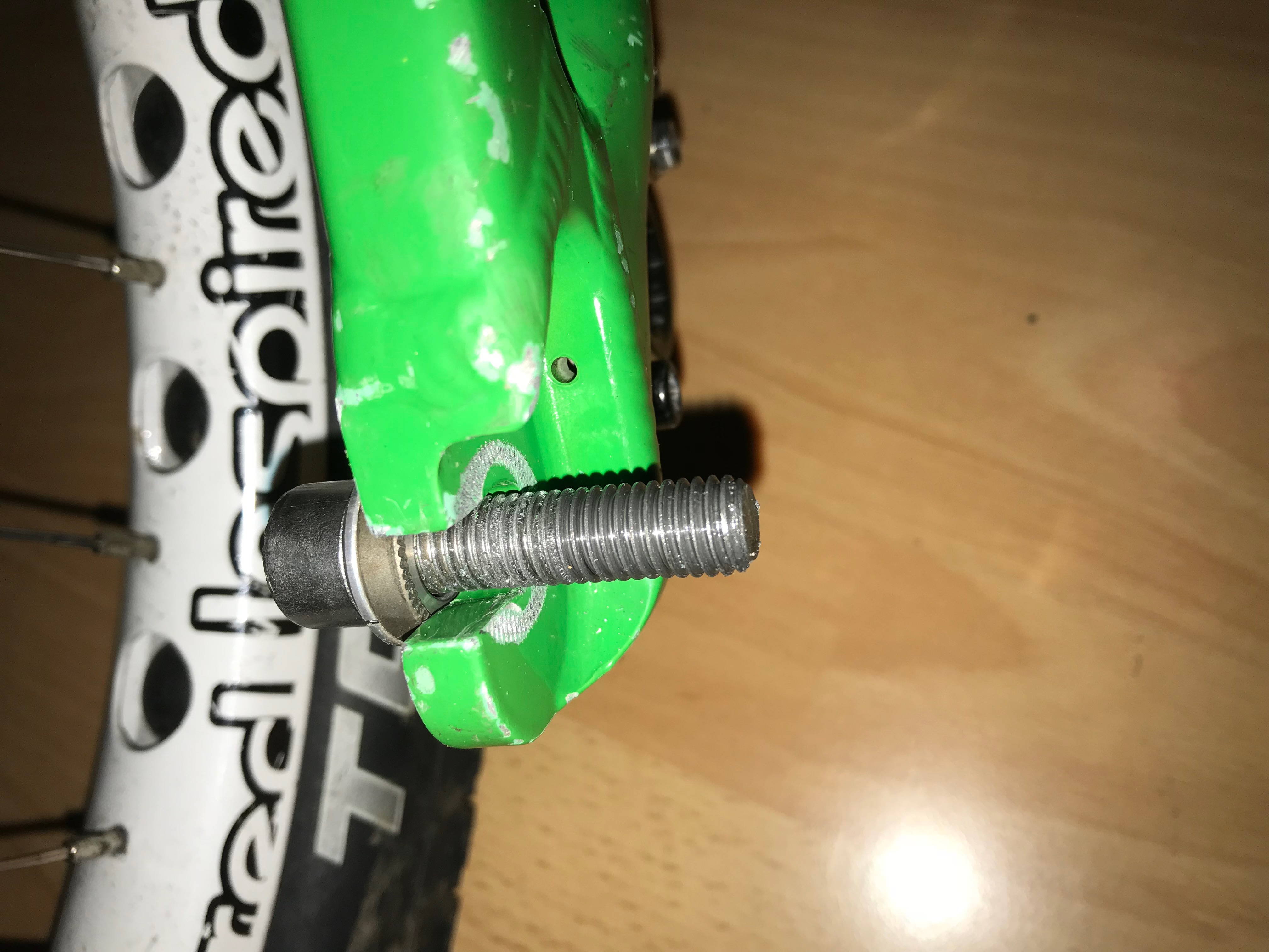

I measured the dropouts, and its about 10mm.

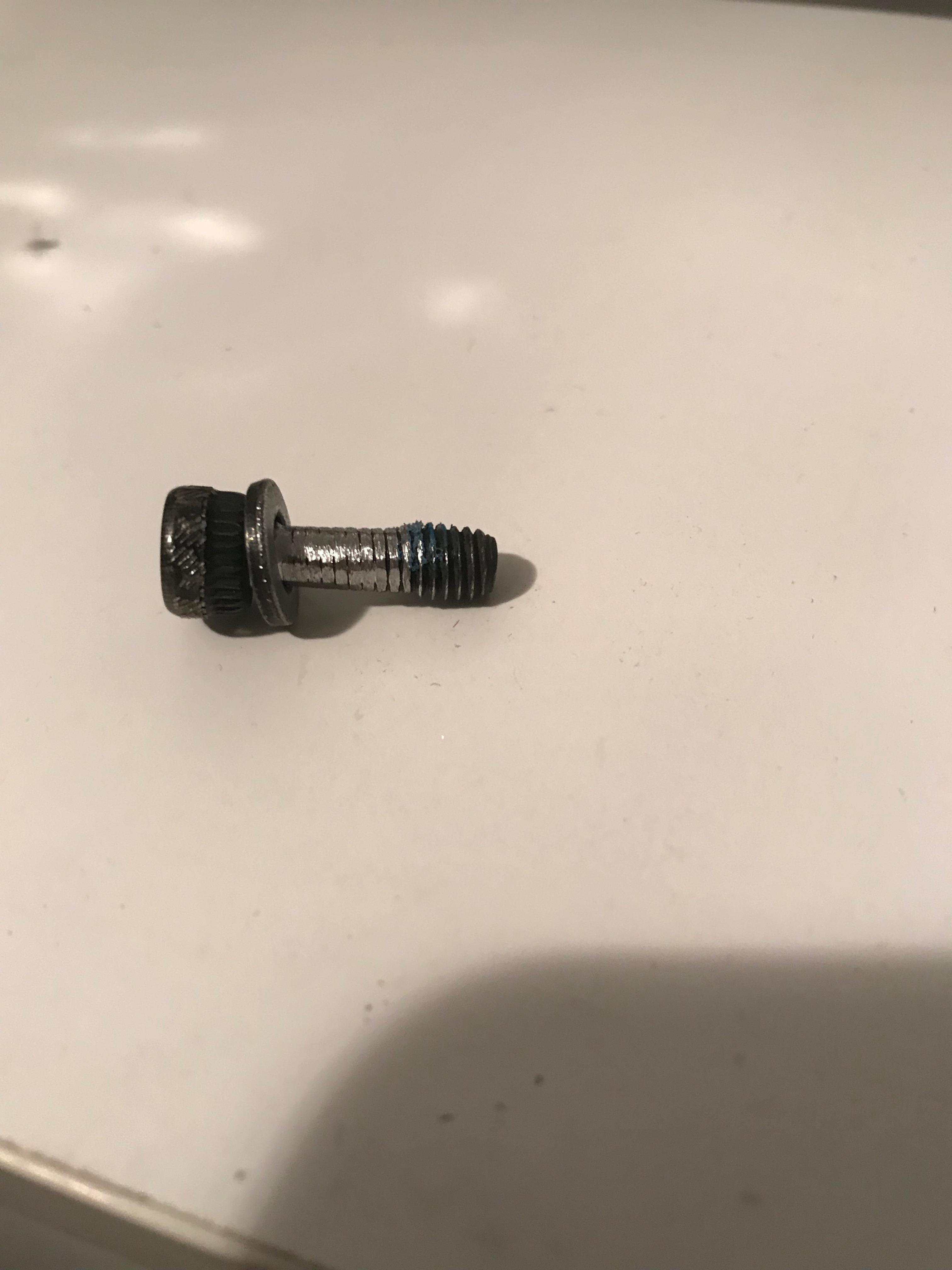

The 2 bolts, wich will be screw from both sides a slightly smaller , about 9.8mm.
I think it the right size.
I tried today layering some small metal plates in the dropouts, now the rotor isnt touching, but it is hard to get the wheel in and out. To alignin the brake caliper then is a tough job :S

Oh sh...
This could be the problem
I bought the bike 2nd hand and had an 180mm hope rotor installed.
How can i tell what type of caliper im running?
there is only the Hope icon and a 3 written on it.
And of course, no one has a 175mm rotor in stock :'(
It's a Hope #3 caliper, for 180 rotor.
The 175 rotor is a custom size, nobody will have it in stock.
Other option is to file the threads off the bolts for the section that goes inside the frame, this will allow you to lift the caliper up a little - usually does the trick.
