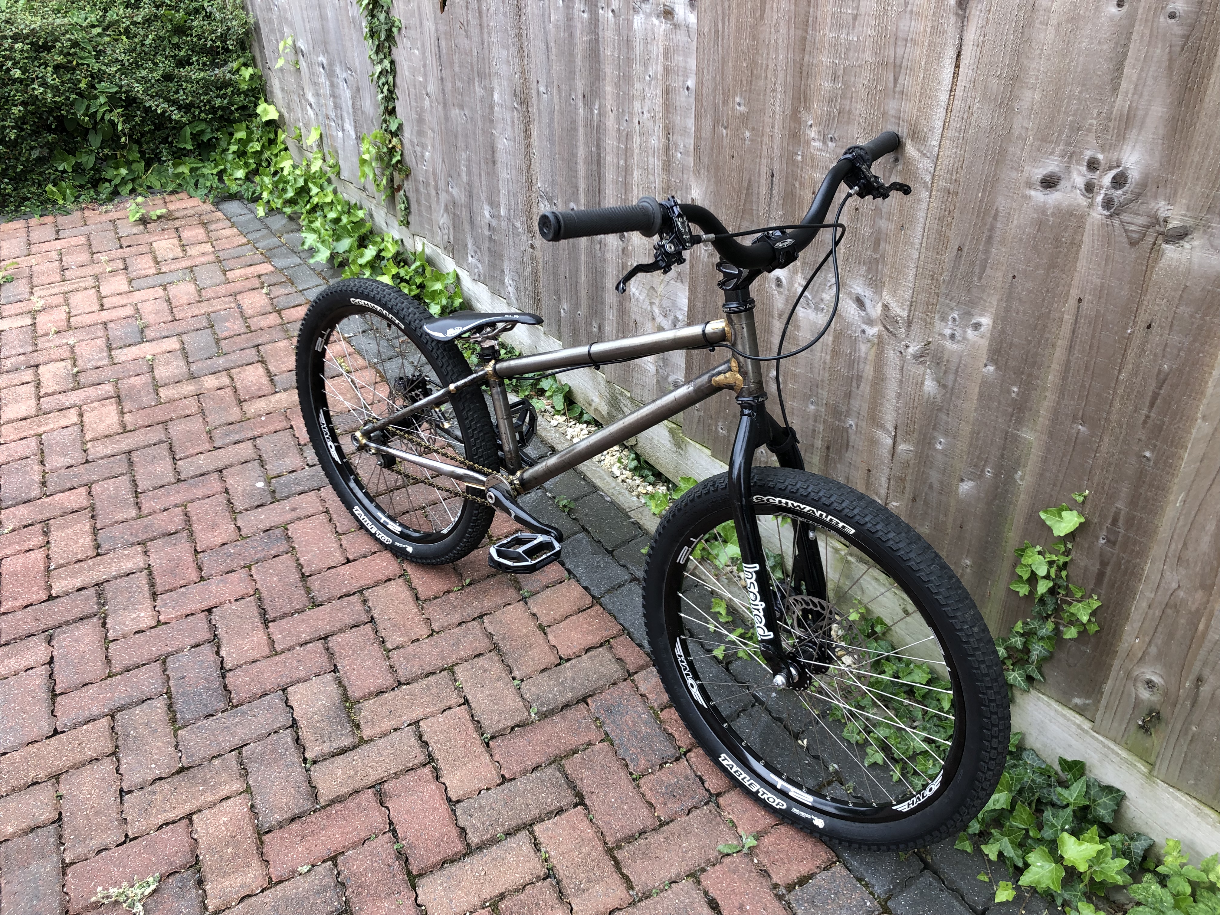

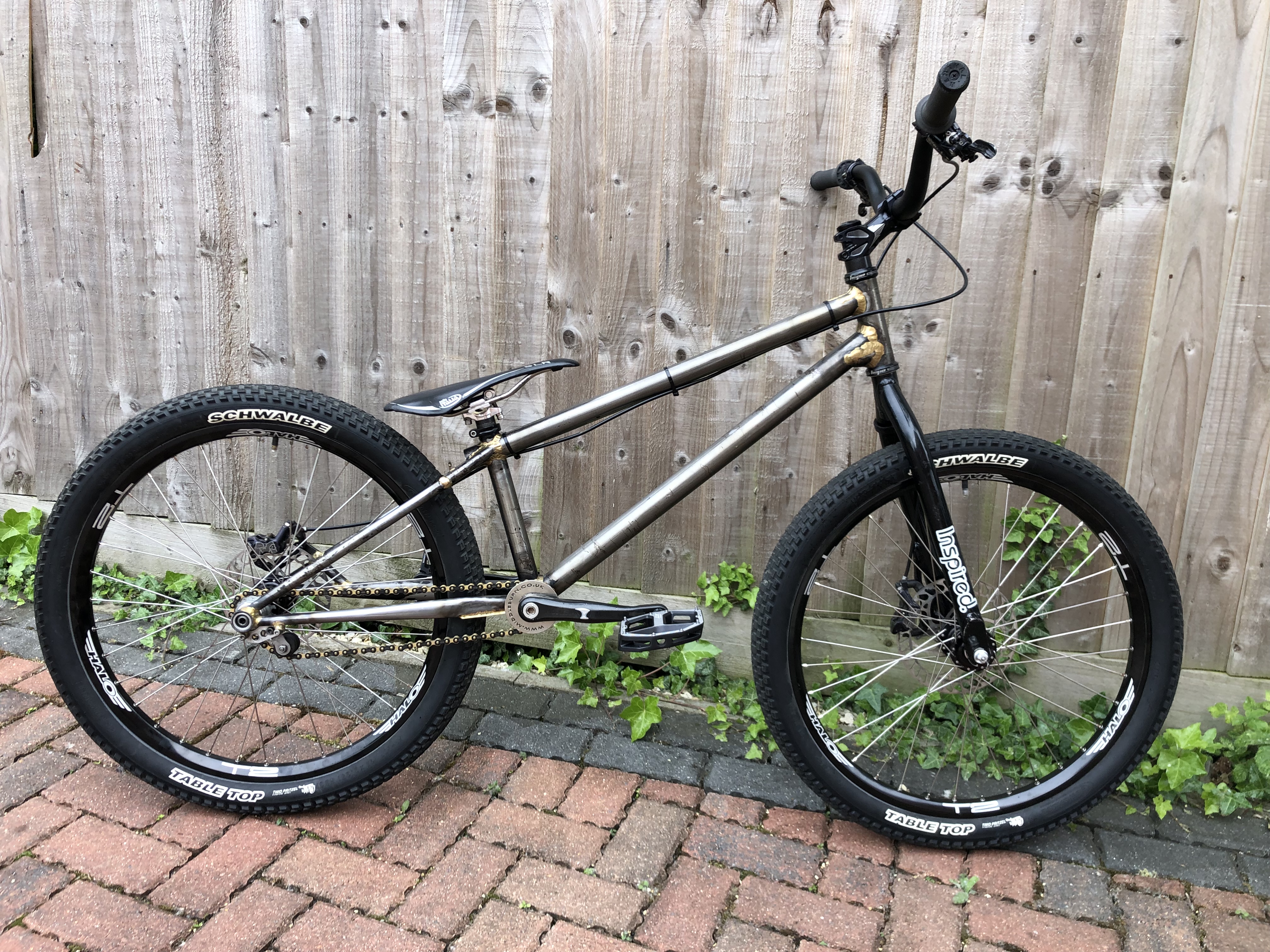

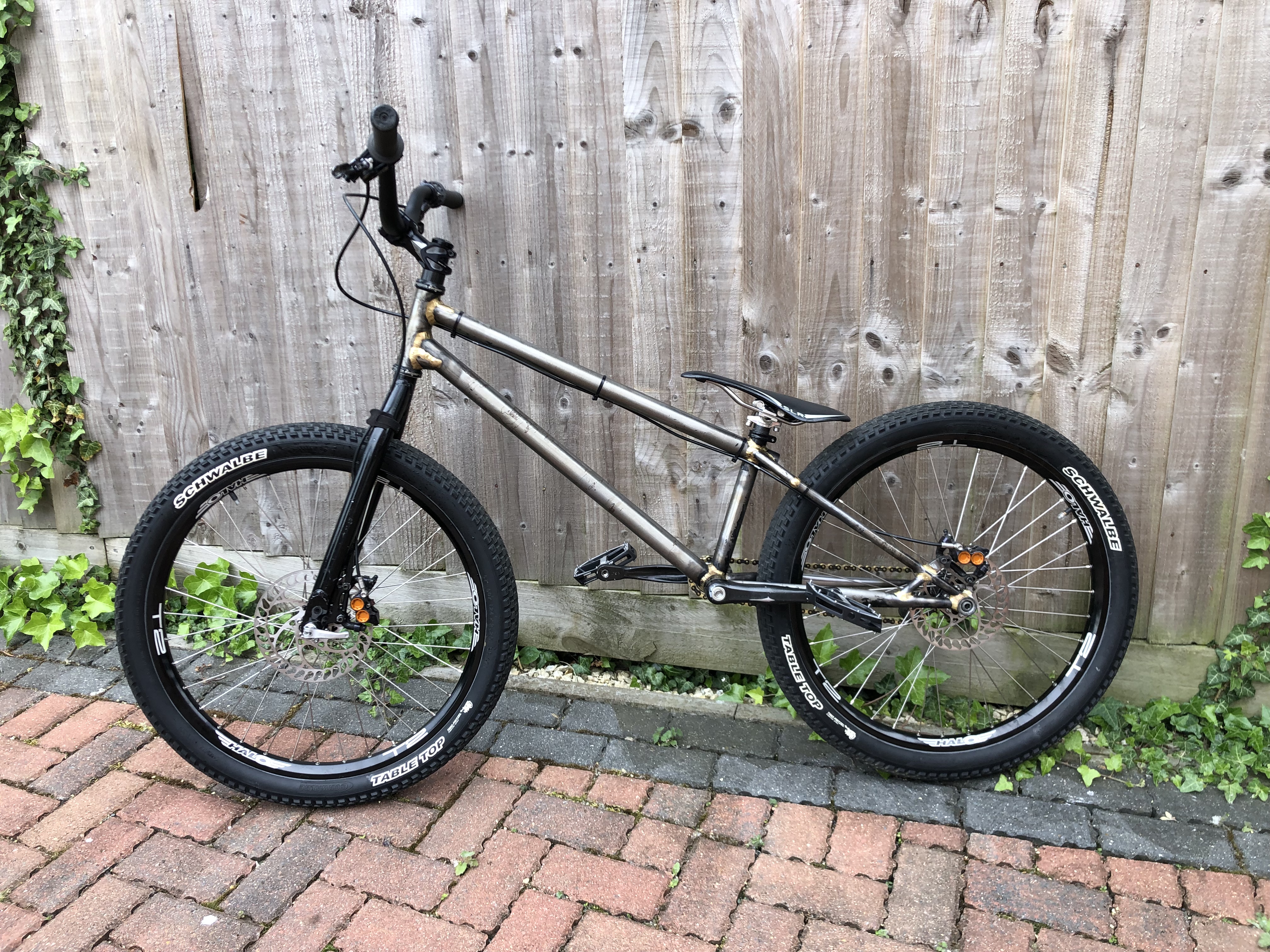

finally got round to getting this frame repaired and re built.
A new drive side chainstay fitted, rear disc mount and stripped the paint job off.
Going to have some cable guides fitted in the near future.
Lighter than my Fourplay it’s replaced and super short, very happy with it. Running 16/14 ratio and feels a little too easy so have ordered a 13t cog.
Spec :
Leeson 609 - later longer version
inspired forks
inspired arcade bars - hope 90x25 stem
Hope headset
hope m4 brakes
middleburn rs7 with trials superbash
Izumi super tough track chain
shimano xt large pedals
chris king SS ISO rear ISO front hubs on Halo T2 rims 36h
Schwalbe table top tyres
Sell Italia SLR Carbon Ti saddle - unbranded Carbon seat post
Hope you enjoy looking at it as much as I do!

Looks great. Who did the disc weld? Would be really tempted to get mine with a disc mount on it......
A friend of mine @bearframesupplies added the mount for me. I'm sure any frame builder would be able/happy to do it for you.
I have a pair of Hope Ti glide hubs with removable disc mounts in silver that would match your Pashley build if you ever did decide to go disc on it.
