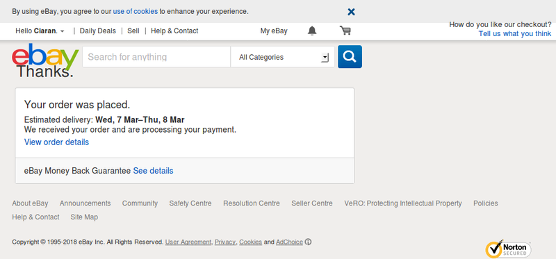

Target acquired. My face whilst pressing that blue button felt it looked like this. Now I've got that same nervous buzz that you get in the aftermath of oh so nearly eating it when you miss the front wheel on a sidehop or heading straight towards a tree on the mtb at point blank range

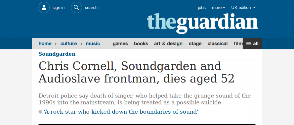

My instant reaction when I was told in dismay "Chris Cornell's dead" was "What!!???" The Beeb are reporting that he was found on the bathroom floor after the show last night. http://www.bbc.co.uk/news/entertainment-arts-39960066 So I'm sat here blasting Audioslave's first album as I don't have any Soundgarden to hand on CD.
