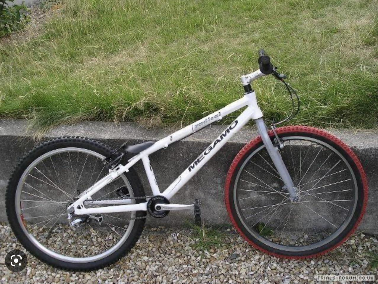

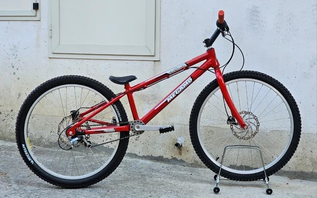

Geometry and stabilty of old bikes (Megamo, Atomz)
La Bourde replied to La Bourde's topic in Trials Chat
So I found at least some threads in this forum with the geometry of the Atomz Evo3: Wheelbase: 1055mm, but found also 1045mm (might be the case depending of the forks) Bottom bracket height: 0, but +20mm in some other threads Chainstay length: 390mm Head angle: 71° Frame weight: around 1,8kg Regarding the megamo equip pro I found that the rear disc mount is +40. -
Hi, Would like to know the geometry of the Megamo Radical (the one with semi integrated headset), Equip pro and Atomz Evo 3. And what was your experience with these frames? Did they crack and where? Thanks. Atomz evo III: Megamo equip pro (not the original paint) Megamo Radical:
