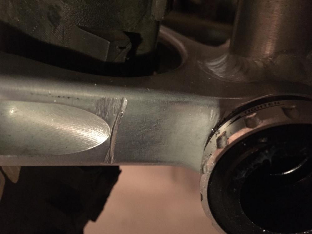

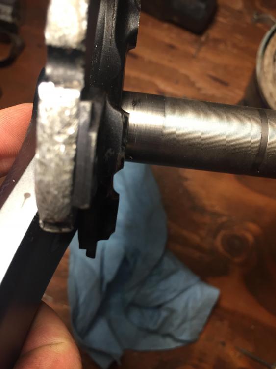

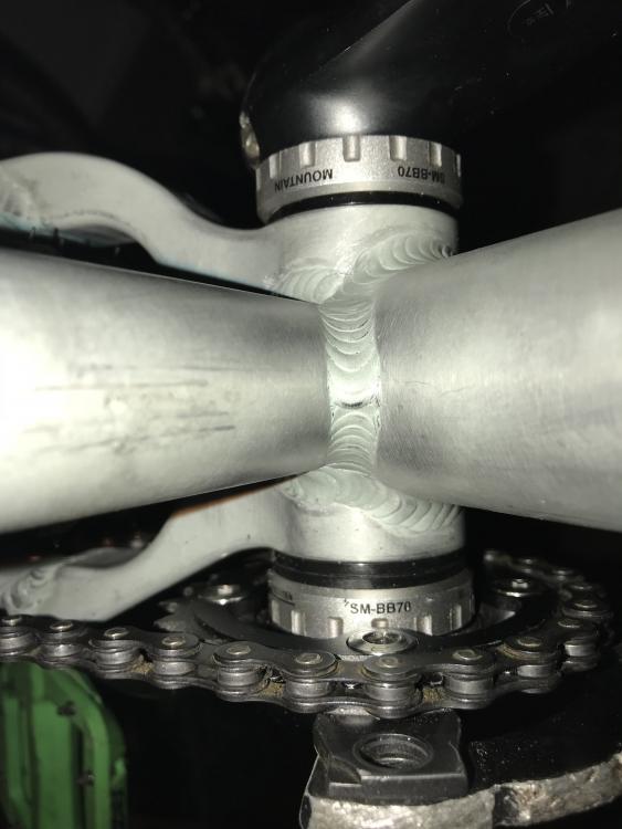

  9. Aye I used to have all 3 on the drive side, but someone said I would prematurely ruin the B.B. cup as there wouldn’t be enough thread contacting the frame... that’s how his whole thing started! A new longer B.B. cup like what was posted in here would be my next idea... unless all 3 are fine to work on the drive side, and this whole thread has no meaning and shouldn’t of been started Ive got free moving cranks, better than before- the teeth just stuck into the chain stay. Cheers for the help, I won’t know if it really works till I properly ride the bike... but yes it is CLOSE
  10. Seems to be in good order now thanks to you guys ! went to my lbs and got a 25mm spacer, same width as the 24mm shimano spacers. Worked a treat, hopefully nothing goes foul when I pedal kick- I’ve got ~1mm or so of clearance now... I will end up grinding a tiny bit off the teeth if such a thing happens, for future readers- just added the spacer on the drive side crank before I slipped it on like they suggested here. Fired up to get back on this bike... crashed hard January ‘16 and haven’t properly been able to ride since... slowly recovering with the help of a good pt. Life’s a b#### sometimes

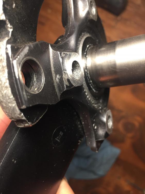

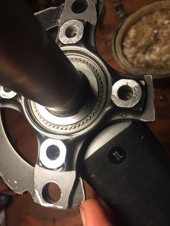

  16. Wow, three of my favorite riders writing in a row... thanks for the help guys!! @Ali C - fantastic idea why did i not think of such a thing @monkeyseemonkeydo Adding a spacer after the cup is already in... huntin in my spacers drawer now. @John Shrewsbury thanks... i slowly filed it down, would check clearance and put a chain on there - making sure it still fits. There is still a lot of thread inside each bolt so I’m hoping they stay strong, may use some blue loctite. @ben_travis awesome, thank you! Now if anyone can magically make the hashtag cranks go to 25% of its price my pogo will have its drivetrain issues corrected...”when i was a kid cranks cost $75!” will edit when I figure everything out and get it working !
  17. If you are unfamiliar with the slx it comes with 3 spacers to be used on the bottom bracket- two drive side and one non drive... I had been running all three on the drive side for a while when a friend said beware doing that- not good for the bottom bracket! When the cranks are run properly, 2 spacers drive and 1 non drive the chainring is just stuck into the bb yoke. I’ve been spending the last two days filing the four bolts that the chainring links to, still no good... need another mm at least if not 2. Afraid I’m going to fully ruin the crank if it goes another 2 mm away. @Ali C didn’t you run slx cranks on the hex?? What was the secret?? I’m light and a light rider, is 3 spacers on driveside going to lead to a premature failure?? Not enough thread in the frame? Would like to keep as they are the greatest cranks I’ve ever had. Do they sell driveside cups with extra long BB threads?? Ala hope?
  18. Taking a redo on my hex, that paint was BRUTAL. Paid someon $50 to strip it, wasn’t even a good job- had to take 000 steel wool and much time with an exacto knife to get al the little chips out of the welds... frame feels much lighter, doesn’t show it on the scale. Looking forward to riding it again!! whats up with the new model hex- different geo? 5mm longer wheelbase all I could see? All I could do last night after a long day.. today in our ever summer land: Another edit...I think I have to change from 22-17 to 20-15/16... what should I go for? Can’t get the chainring to clear from carving into frame without putting all 3 spacers on drive side w these slx cranks- which I fear will lead to a premature bb death...
