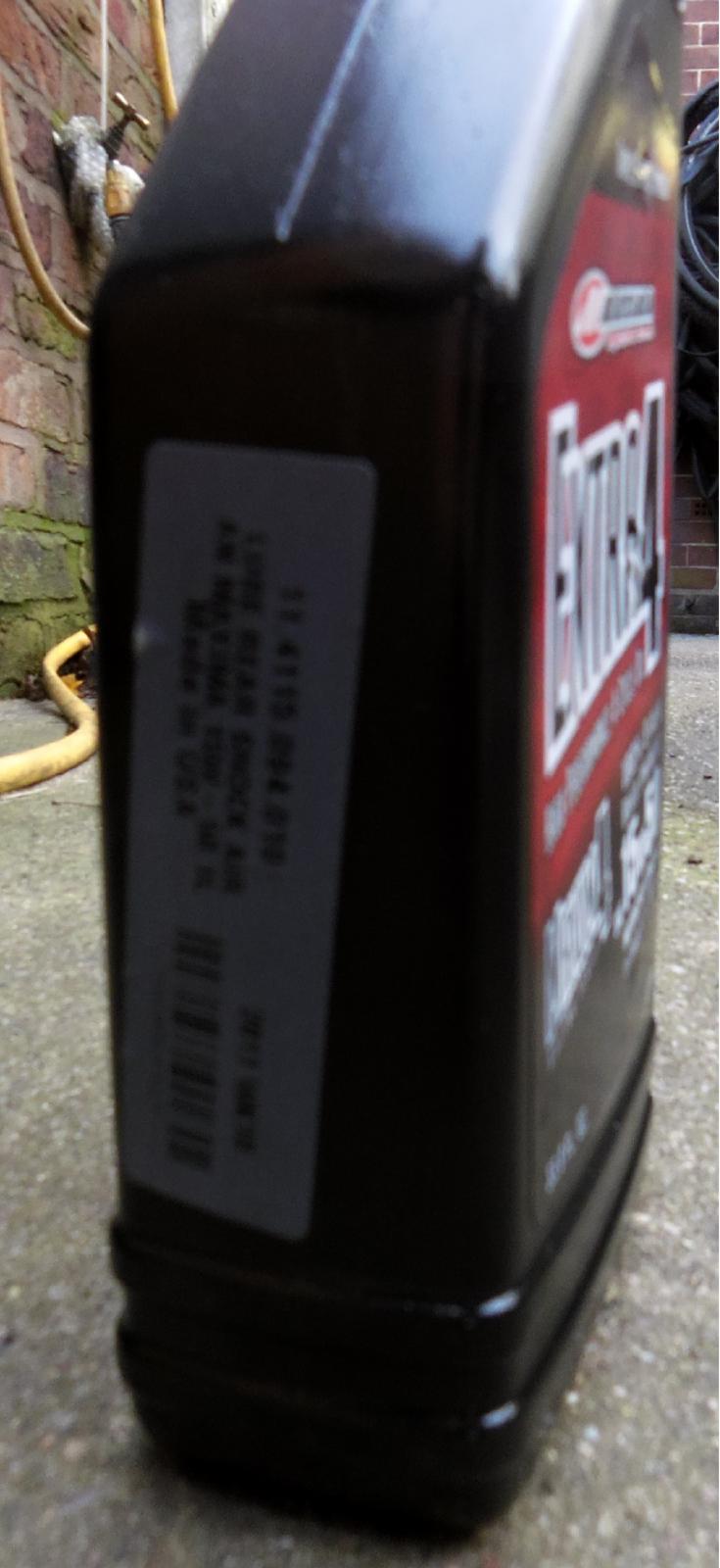

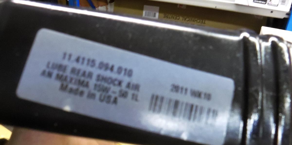

The newer bottles aren't labled as rockshox anymore I will get you a picture at work tommorow. The newer bottles aren't labled as rockshox anymore I will get you a picture at work tommorow.
The lower leg fork oil supplyed by rockshox now is maxima 4 stroke oil. http://www.motorcycle-superstore.com/7376/i/maxima-maxum4-extra-oil http://www.fisheroutdoor.co.uk//product.asp?category=840&part%5Fno=PS15WT&find%5Fcategory=840&find%5Fdescription=&find%5Fpart%5Fdesc=
To lubricate the lower leg on suspension forks you can use 15/50w fully synthetic engine oil which is what rockshox are using atm. What ever you do don't use gt85 or tf2 or any spray oil that's not for suspension or a silicon spray. The substance in gt85 that penetrates rusted bolts and make the ptfe oil thin enough to work as intended is petrolum based, meaning it will penetrate the rubber seals take hold of the oils in the rubber and evaporate/ degreace the this will cause the seals to dry and crack. If your seals ate cracked it isn't worn out you broke it. Under normal use with good maintenance those seals wont crack for 10-15 years
