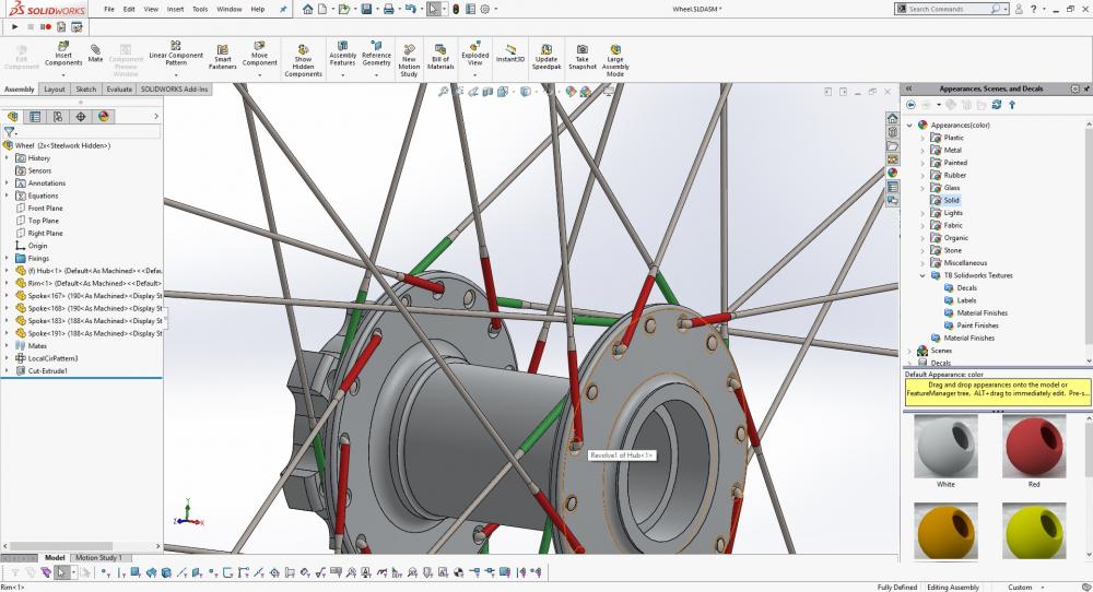

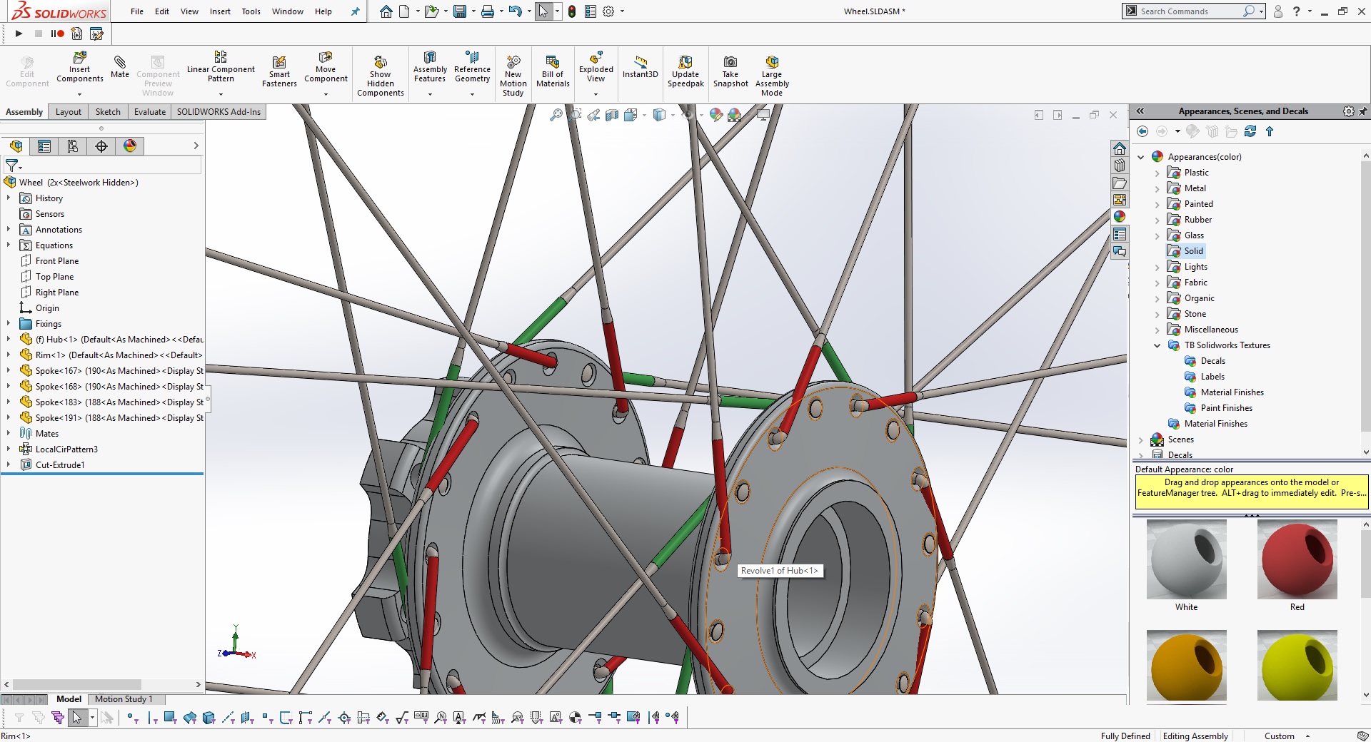

Had another play and got it to 3x, spokes are now 190 and 188 but will obviously give a stiffer wheel Reckon I'll get away with this level of spoke/flange interface at the hub? Obviously I will be prebending the outside spokes inwards as I lace it.
Pedal car weight will be in the region of 20kg + driver, problem with radial lacing is that we need to be able to drive and brake with the wheels as well I did fiddle around with the angles to try to get 3x but it does go a but squiffy and the spoke lengths seemed to go off on one! I'll have another hack around with it on the model when I have a fresher head (not 1am) and see if I can't balance them up a little. The car should be used on fairly smooth tracks (possibly some road use as well) so wheel strength isn't of utmost importance (with regards to bashing), as long as they can stay straight and not noodle all the time then jobs a good un. @Mark W, thanks for the heads up, I could probably get by with 175 and 177; I've used the same set of spokes on the triton for the last 8 years, despite changing rims and hubs - fiddle with the lacing . We do have a couple of local bike shops on board who would be preferential (as they'll do them for trade price) but push comes to shove we've still got money in the kitty

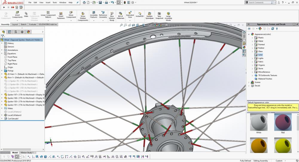

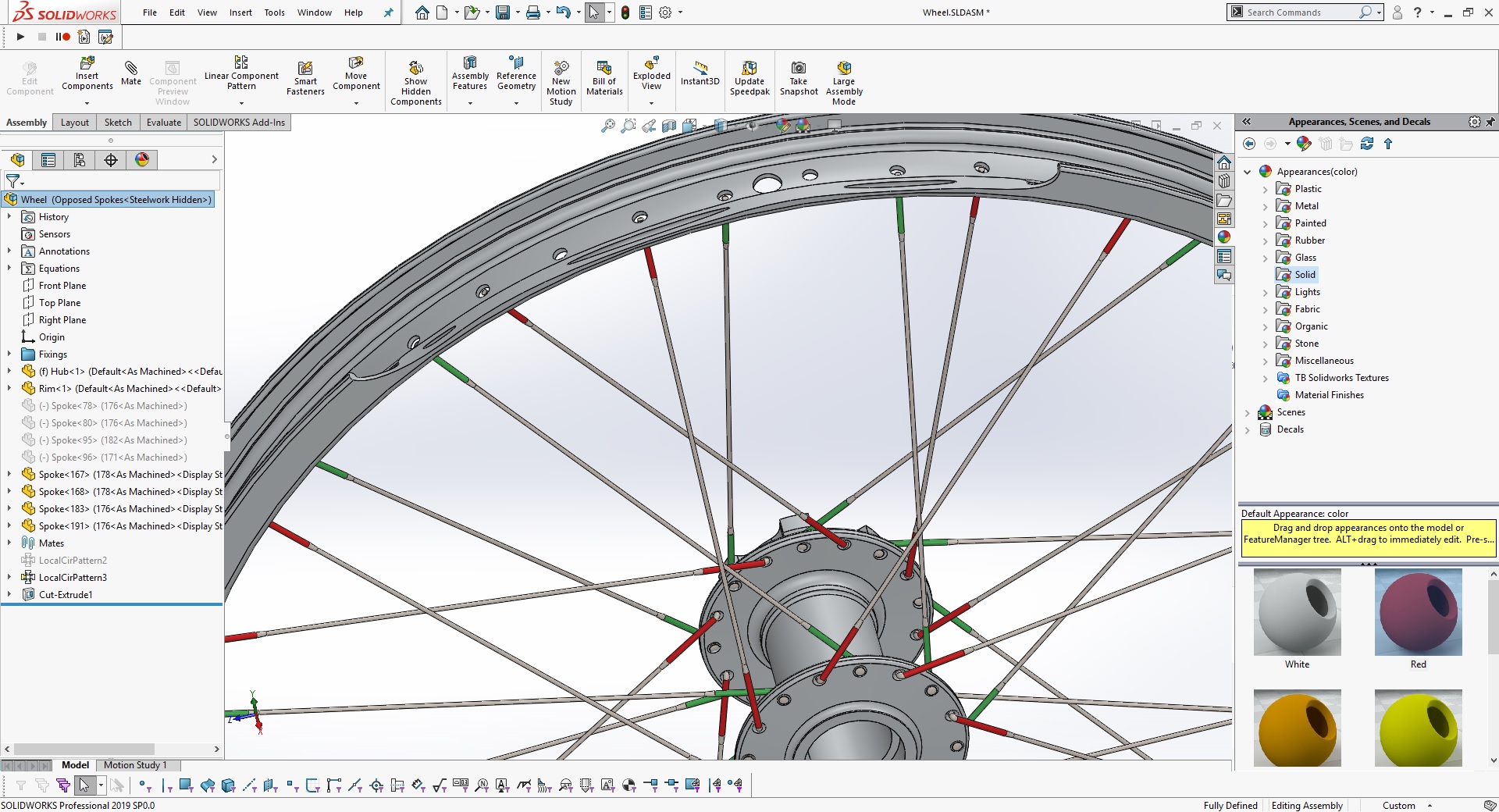

Good info, I've now accurately measured and modelled both rim and hub so I can play more with the lacing. The spoke holes are offset from the rim CL by 1.7mm ±0.1mm, will play with putting them in the wrong hole (fnaarrr!) and see what happens. I'll see how laying it up on your sketch works out and fiddle with lengths accordingly, the beauty of having it fully modelled is I can play around with the position of the first 4 spokes and instantly pattern them around the rim to see how it looks Would have been sooo much easier if tarty had 4 of the 32h monty rims in stock instead of 3 edit: Something like this, red spokes are 178mm, green spokes are 176mm; both lengths are within 1.2mm of the spoke bed which is plenty of scope to take up with nipples. Not sure how I've ended up with 2x but setting it as 3x really seemed to screw things up, as it is the spokes are evenly spaced and pulling from the correct sides of the flanges so should be much easier to tension! Now where can I get 178 and 176 (64 of each) from?

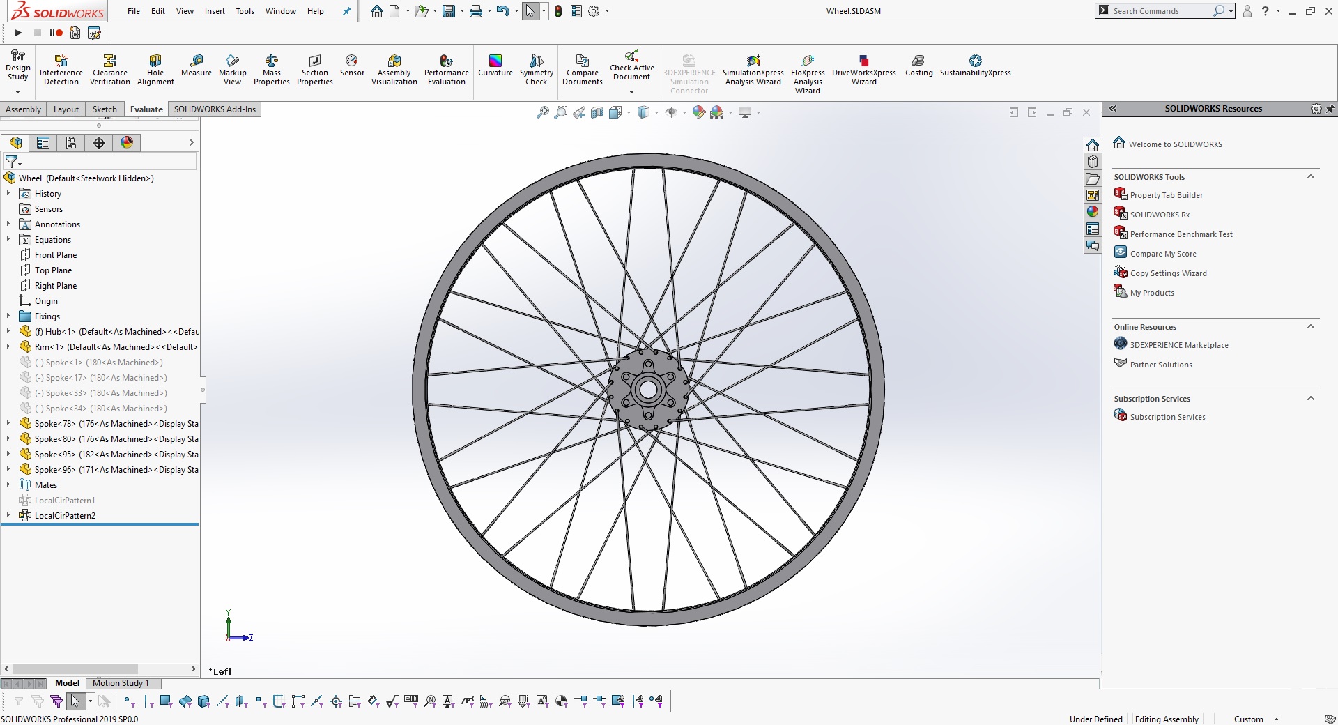

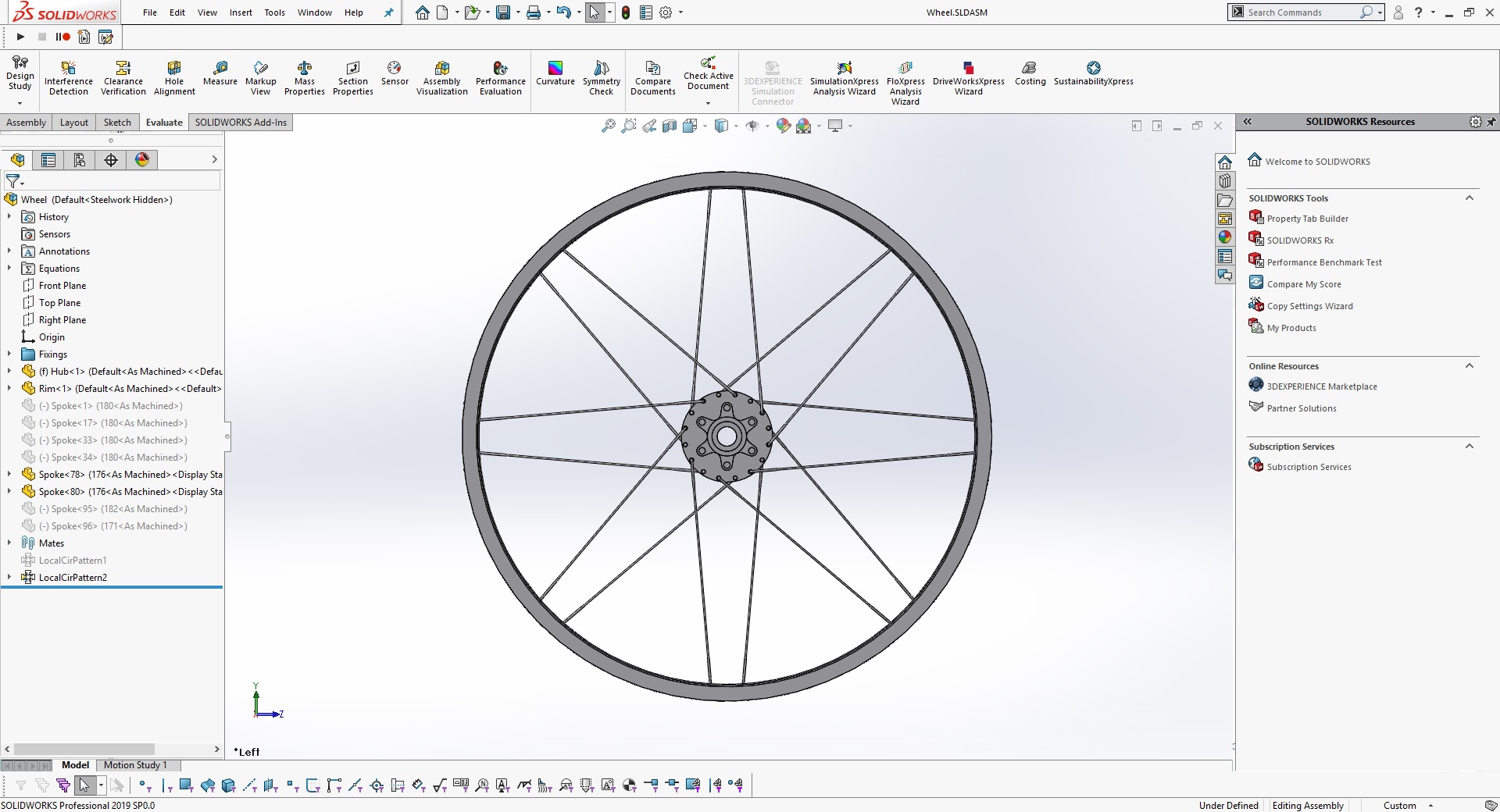

So I've got the wheel modelled in 3D now, based on completely arbitrary rim and hub dimensions I can build it with equal length spokes on the disk side, valve hole is at 12 oclock. The non disk side then needs alternating spoke lengths 7mm longer and 5mm shorter respectively, this puts all of the spoke thread ends within 0.5mm of the rim bed, empty nipple holes inbetween each group of two spokes. It's not ideal because I currently don't have directly opposing spokes so relying more on the rim strength than the build as it won't be possible to tension it quite as high. Only a case of rejigging the assembly model and tweaking the lengths
Long nipples is a good idea! I've modelled the wheel in solidworks, I can play around with spoke lacing and lengths to see what I can get away with and then try to make it work from there. Looking at building it as a dishless wheel (it's for a pedal car so offset isn't an issue) which should help.
