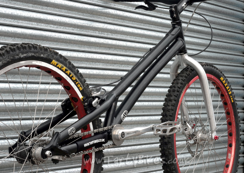

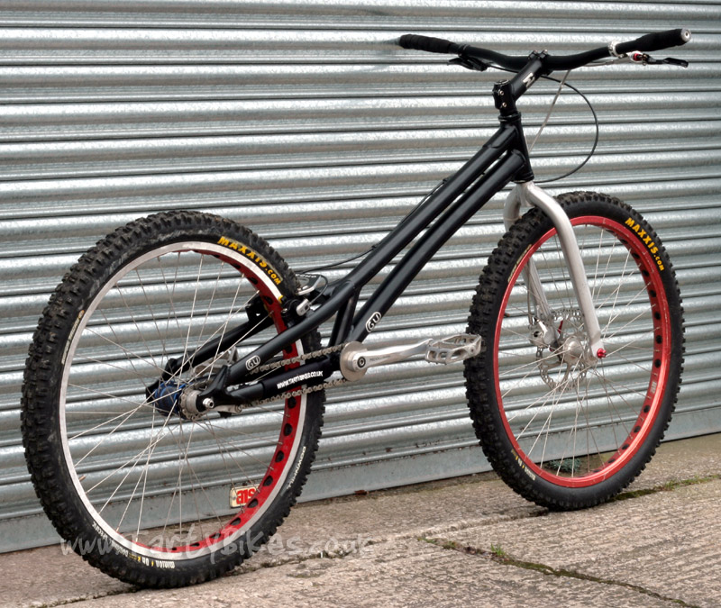

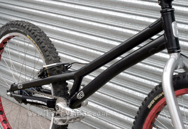

AdamR28 Posted January 5, 2008 Report Share Posted January 5, 2008 Just built this up today, got some riding pics also which I will stick up shortly after editing.Geo is: 1085 wheelbase, +40mm BB, 383mm chainstays, 660mm reach, 72 degree head angle, weight 1.842kg (very Ozonys-like also!).Ads Quote Link to comment Share on other sites More sharing options...

philking Posted January 6, 2008 Report Share Posted January 6, 2008 Rides very nice, i have just changed from a gu typhoon 06' so its slightly different, and definitely prefer it. Its a lot lighter which is actually noticeable (very light for a deng frame), and the slightly shorter wheelbase is better for someone my height (5'7") and with longer stays and a lower bb i can gap further, and it feels more stable for natural riding which is always good! Quote Link to comment Share on other sites More sharing options...

stevecoust Posted January 6, 2008 Report Share Posted January 6, 2008 nice pics ads and very nice bike phil. kinda reminds me of a kot ms2 frame. by the way the geometry sounds perfect, look forward to seeing it phil. good job as allways on the build ads. steve Quote Link to comment Share on other sites More sharing options...

Ash-Kennard Posted January 6, 2008 Report Share Posted January 6, 2008 b*****d, now i do want one, dans headtube looked way longer than this ones Quote Link to comment Share on other sites More sharing options...
Jed Posted January 6, 2008 Report Share Posted January 6, 2008 Looks nice. All the pics look like the hub is blue but in the last one its black... may just be me lol Quote Link to comment Share on other sites More sharing options...
craigjames Posted January 6, 2008 Report Share Posted January 6, 2008 very very nice! quite liking the clean lines and simplicity of ithow nicely did you have to speak to the guys at hope to get a moto lever with that brake or did you buy it seperately? Quote Link to comment Share on other sites More sharing options...
AdamR28 Posted January 6, 2008 Author Report Share Posted January 6, 2008 Looks nice. All the pics look like the hub is blue but in the last one its black... may just be me lolHaha, photoshoppage... have a for noticing!how nicely did you have to speak to the guys at hope to get a moto lever with that brake or did you buy it seperately?The Moto brake was a proto one we had to test/decide which lever would be best. After we'd finished with it Phil bought it Quote Link to comment Share on other sites More sharing options...
