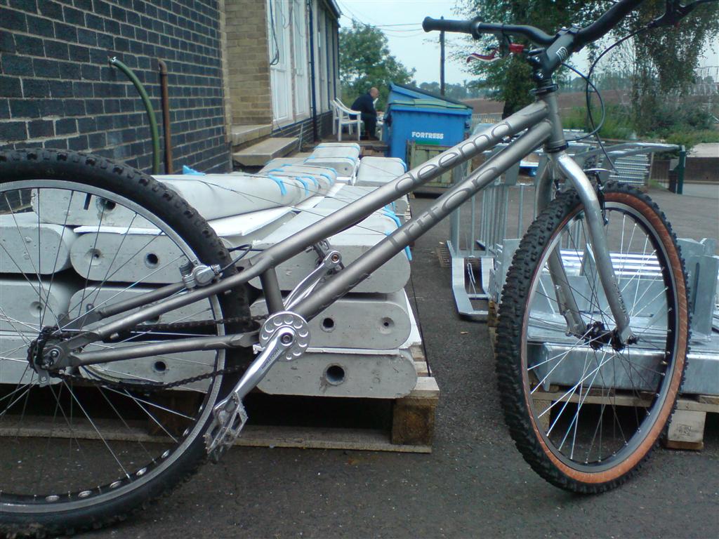

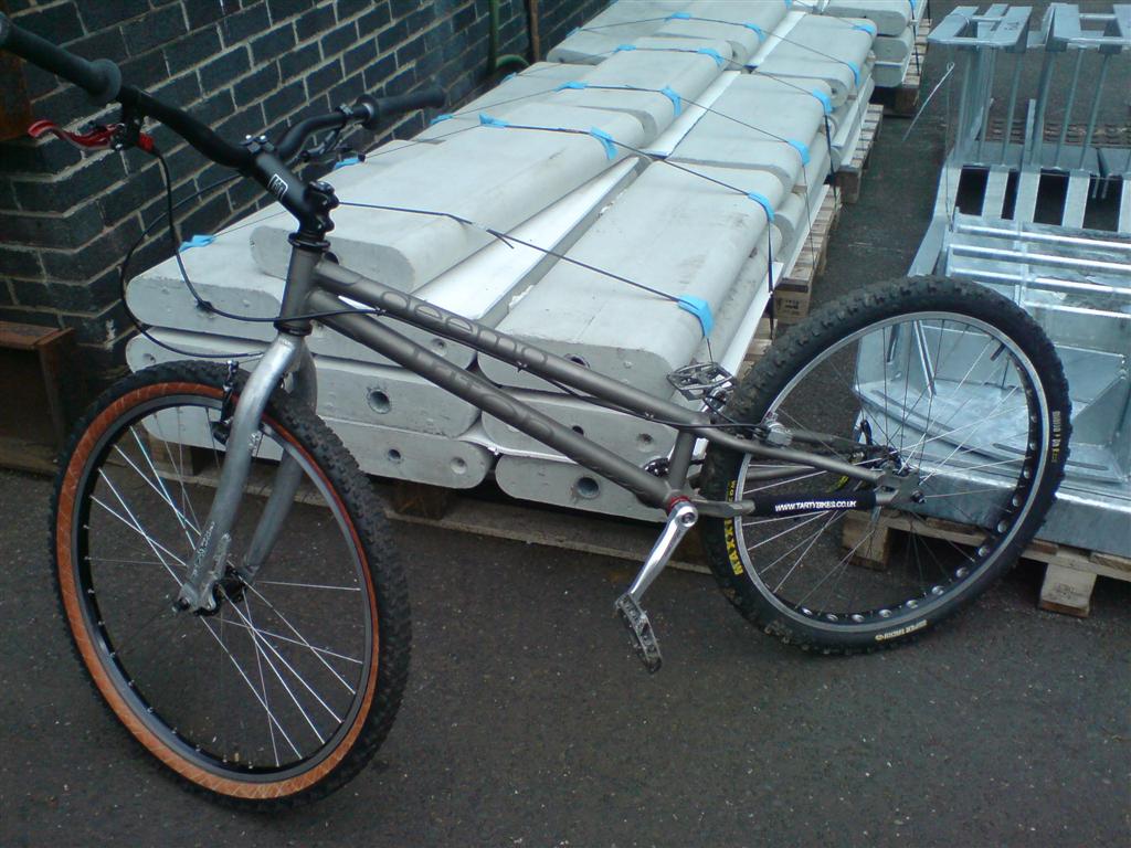

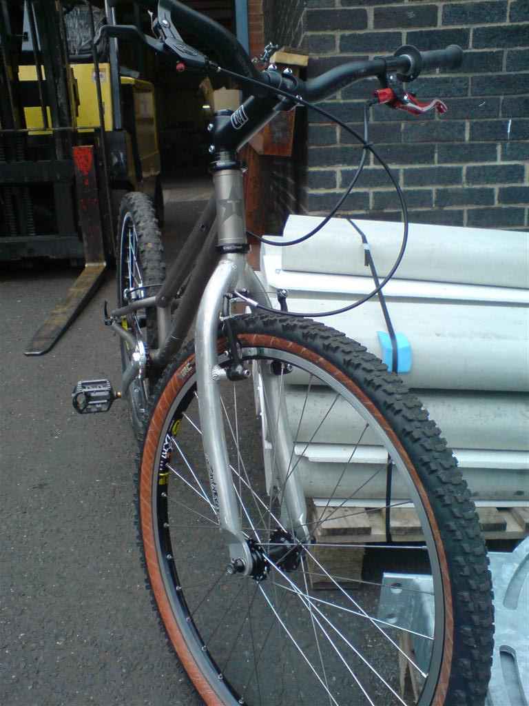

Triton Deema 9.1 Kg (updated - Now 8.88kg)
forteh
...rear maggie is much nicer on stock than disk :)
Ive also turned into a weight weenie :$

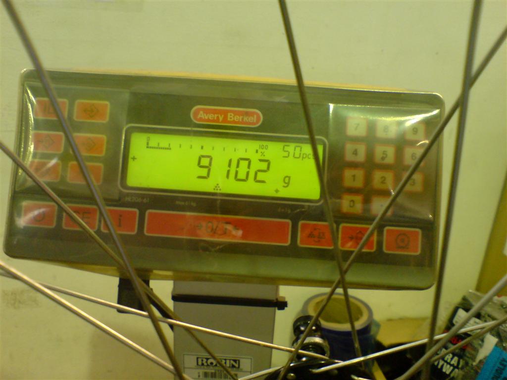

Total weight of the bike is 9.102kg, the only modified part is the drilled dx32 and chopped rear minion
Current spec is:-
Triton Deema frame
BT f6 fork
Atomz oversize stem
32" Monty PR bars
FSA orbit extreme headset
Hope ti BB
Middleburn RS7/HSB cloud9 bash
Wellgo MG1 Ti pedals
SD7 arms/lever with coustsinks
Maggie slaves/RB lever with cnc reds
Mavic xc717 (smooth) laced onto hope xc with sapim DB spokes
Drilled DX32 (light grind) laced onto king discotech with sapim DB spokes
IRC mythos xc front/minion 2.35 single ply rear
Rides so effortlessly :)
Thought I would make a new topic rather than update the old one a third time >_<

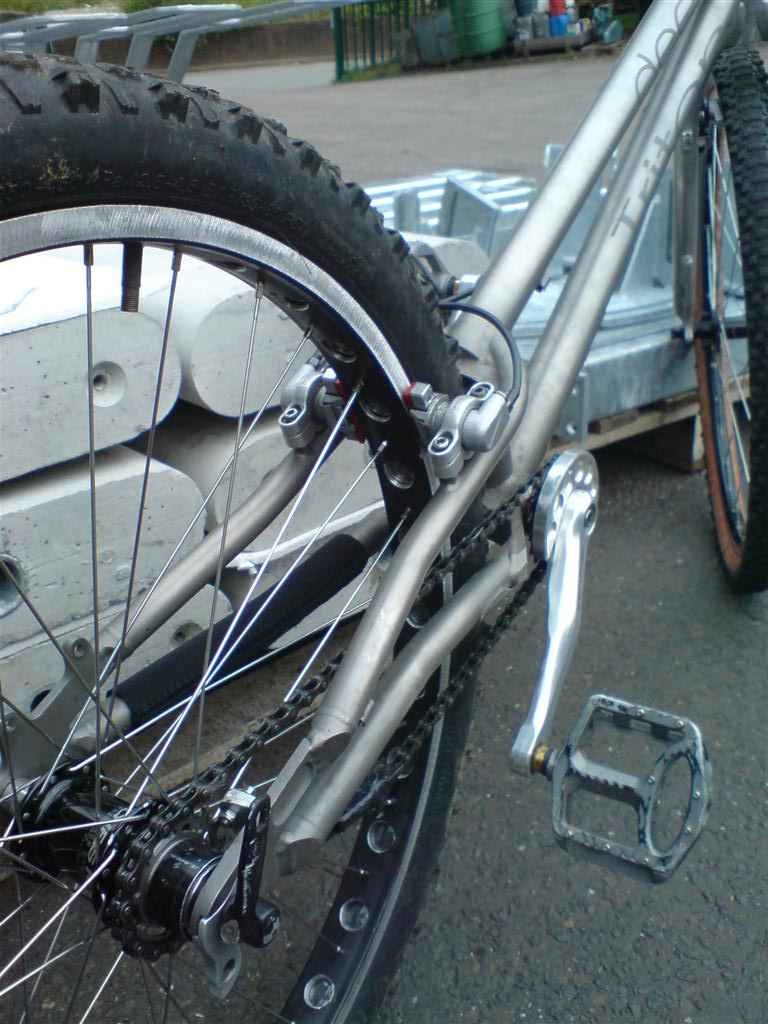

That ones looking sweet dude!! Oh and I'd suggest putting a booster on the frame mate, the flex in the rear end (being titanium) might cause it to crack without one.
Don't be silly it will add weight :-

I agree on the booster front. I cracked my base frame around the seat tube because I didnt run a booster. Grab a trialtech carbon jobbie and youll be laughing!! would be a total whalap to the under carage if you cracked that beast!!
Im still debating a small booster, when I put a control 4bolt on there the brake was shockingly bad, no bite or hold. Think Ive still got an old carbon 2 bolt maggie booster floating that Ill test :)
Given the naturally elastic nature of titanium Im not too worried about it cracking, my old zoo boa cracked on the seatstay (probably from no booster) but that was aluminium which fatigues like a bitch when flexed. Even so, I crack the frame its not too much of a hardship getting it re-welded.

Though i have never heard of the brake loosing performance when a booster was fitted? Very strange.... anyone like to explain this to me please??
http://www.bikedock.com/posit/shop/product...2Fposit%2Fshop%
Alex rims a plenty.
If the brake is too stiff the pads cant bite, the brake uses the flex of the frame (in addition to the force through the lever) to really dig the pads in and bite :)
With the 4 bolt booster on the triton the brake is appalling :( (and heavier :D )
Will remember bike dock if I want a new dx32, you could have pointed that out to me a couple of weeks ago :P
Sorry man my crystal ball has been on holiday. :P
Yea the brake thing...Still doesnt make sense to me. The way I see it is, if the frame flex's, the lever pulls further into the bar making the brake feel spongy. Thats one of the reasons why metal baking bads were designed is it not?...Brakes were feeling spongy because the plastic backings were flexing/braking.
The stiffer the brake set up the more power transfer through the lever to pistons to the pads against the rim. Well thats the way I see it anyway. Im actually sitting pushing my finger through my other finger and thumb on my other hand trying to think about how this can be right..I let my finger and thumb have 'flex' and the single finger passes through easy. I hold my finger and thumb solid/stiff with no flex and its harder for my single diget to pass through, like a rim through a brake! :giggle:
Man, im not preaching anything to you, just so you know. You obviously know what your on about, im just giving my opinion. :)
I always believed you needed a brake booster until I took it off, and holy shit me brakes working better than it ever did :)
Im not too sure on the mechanics of it but it seems to work if there is alittle flex in there.
Cool man if it works it works....im very intregued now though. Im off to start a thread. lol
