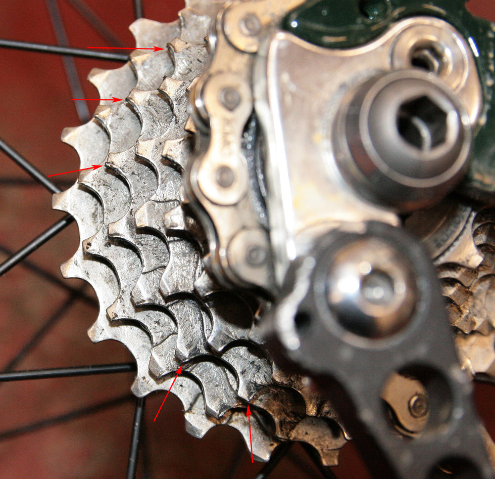

I don't mean this as an insult to your intelligence I'm just doing what Sherlock Holmes would suggest - "When you have eliminated the impossible, whatever remains, however improbable, must be the truth"
If you have just bought the hub then are you running your old chain on the old cog that came with the hub? (or a new chain with an old cog or and old chain with a new cog - you get my drift!)
It could be this causing the chain to slip, resulting in a knee stem moment, and not actually a skip of the hub internals.
Just one to rule out that's all.
looks like you were right boyo!
thanks adam
i feel a bit daft thats its turned out sommat as trivial as that
but the good news is there is no hub problem
thanks tarty for your patience and you are quite welcome to give me a rub of the head and a told you so hahaha
happy chris king owner !!!!!
