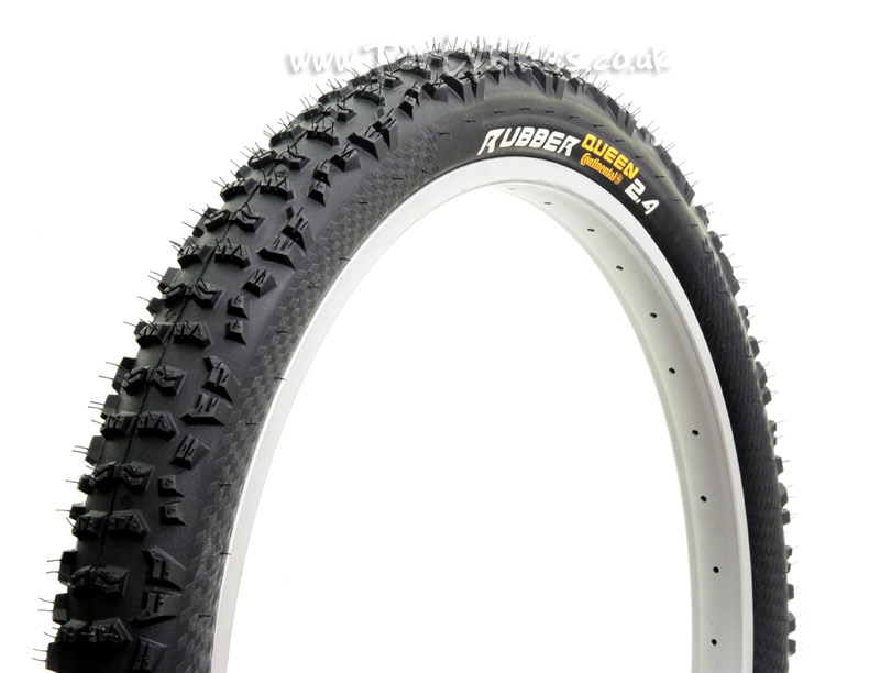

I got a 2nd hand RQ from a mate, it's pretty much new but I've got an odd problem. I can't get it to run true. It's bouncing up and down and sideways. I've tried the soap trick, high pressure, low pressure, bouncing, pulling/pushing the tyre into the rim and nothing seems to help. It's pretty bad, it keeps rubbing against the chainstay yoke. Any other ideas? Or is it safe to say that the German who made my tyre was drunk that day?
The bead is actualy wider than a normal tyre bead > 26" So just need to pump the tire bit by bit a press it in, get it nice and round then pump the tyre till the wanted pressure. I think it's common for prety much every tire.

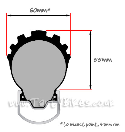

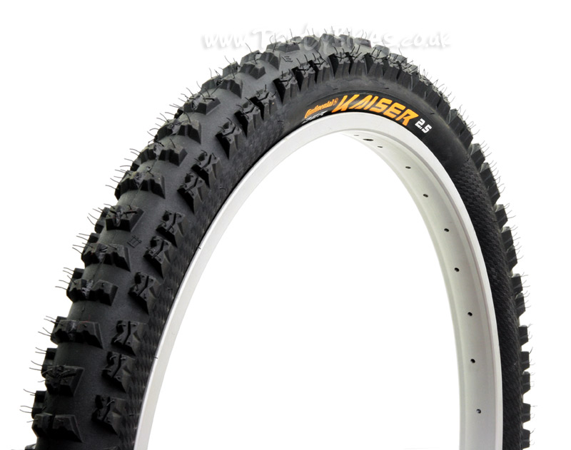

It should fit more frames than the Der Kaiser, seeing as the Der Kaiser's 1mm wider...

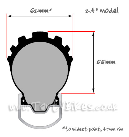

The Rubber Queen looks like it's bigger 'cos the actual carcass appears to be bigger, although when you take into account tread heights they're simlar:
Our heights are measured from the very tip of the tread to the rim, which is why they work out the same.
'Crikey', a 2.4" Rubber Queen up front, Ruse? It even fits?! Would've thought any good old 2.1 or 2.2 tyre'd do, nevermind that RQ which seems more like a traditional 2.7!

the rain kings and de kaisers have THE grippiest compound available, plus they have the stiffest sidewalls I have ever felt which makes them the most stable tyres on off camber and points as well as being the most puncture proof. they also weigh about the same as a maxxis.

The RQ gives such a good bounce because it is paper thin and has a very pliable sidewall (the carcass has a high TPI count made with fine threads and not a lot of rubber.) The downside is that it pinches easier than the heavier rear tyres available, and is less stable.
