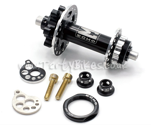

I based it around a 116mm Echo SL Rear Disc hub. The reason for using the 116mm hub is that the disc side bearing is in a much better place (further outboard) than all the other disc hubs available right now.

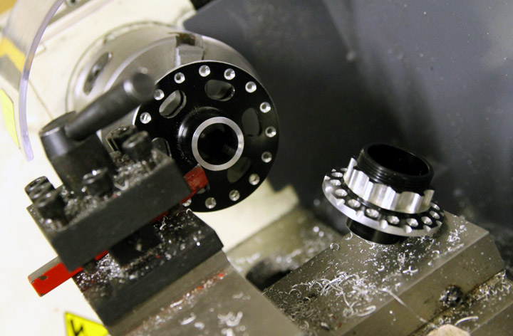

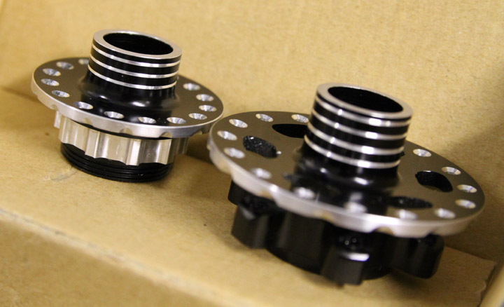

Took the hub apart and cut the hub shell up, then tidied it up.
Put some grooves in to help the glue (and sanded off the anodising for a better key).

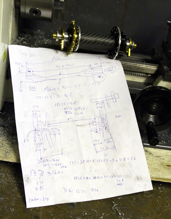

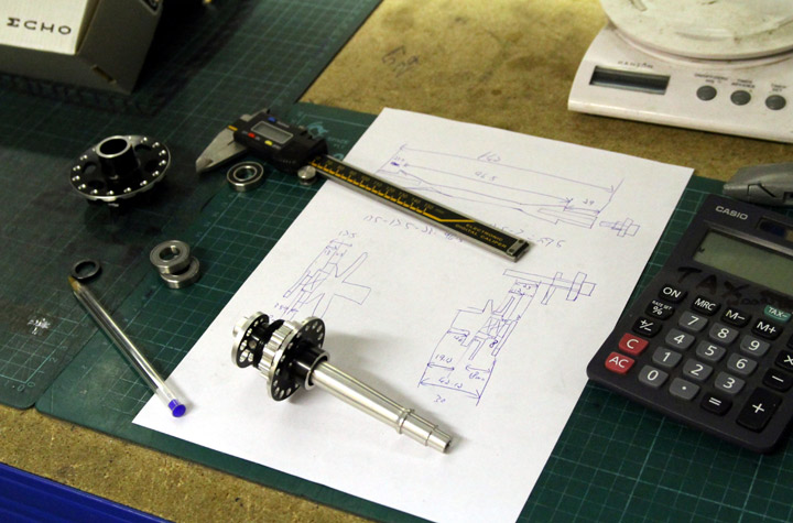

Doodles/calculations...

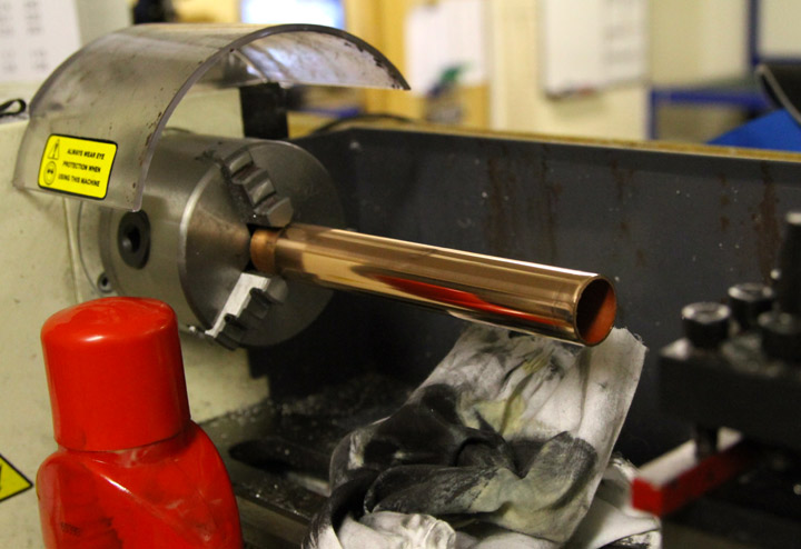

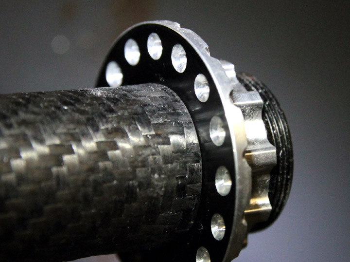

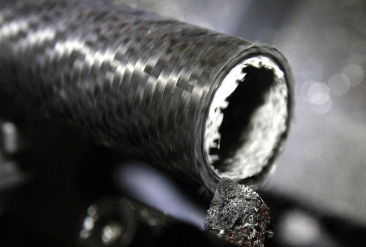

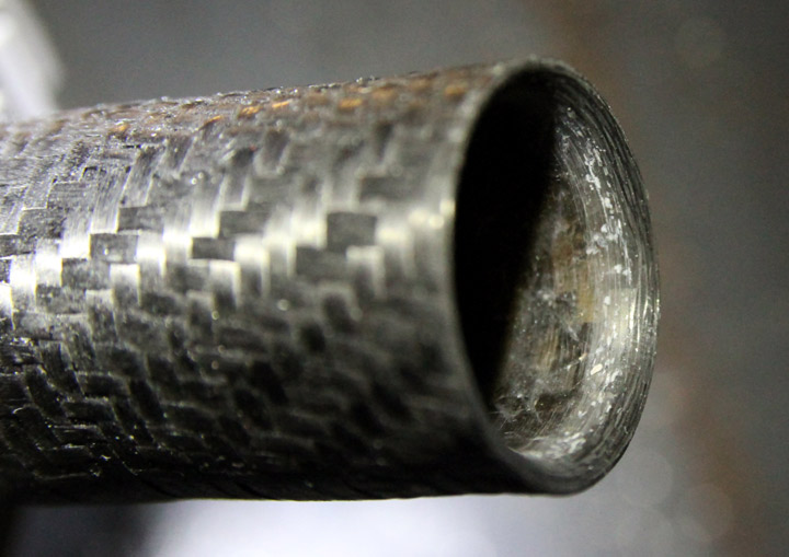

Making the carbon part was fairly tricky but with the right tools not too bad. Started with a copper pipe, polished up:

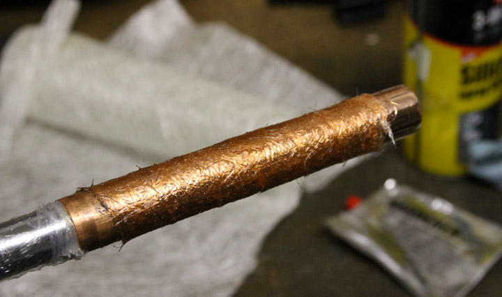

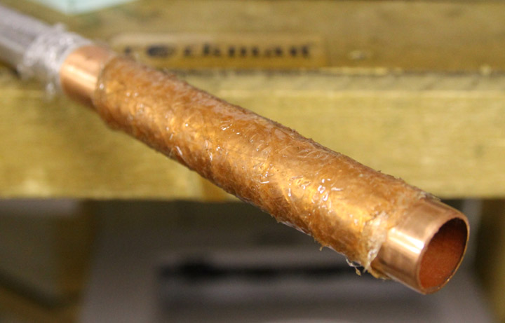

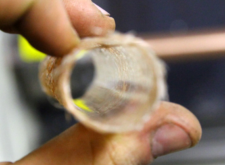

Wrapped it in fibreglass

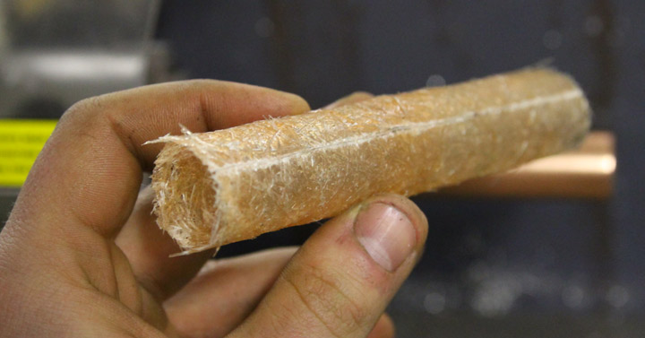

Sliced it off once cured
Shiny inside, exactly 22.00mm diameter to match the flanges where it would be pressed onto. Should have sanded it smooth at this point, since the 'lumps' show right through the carbon on the final piece :(

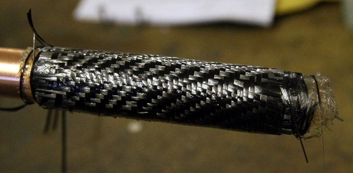

Back on the mandrel, then coated with carbon fibre resin - you let the resin go off a bit so it's tacky and the carbon cloth sticks to it
Carbon ready to cure

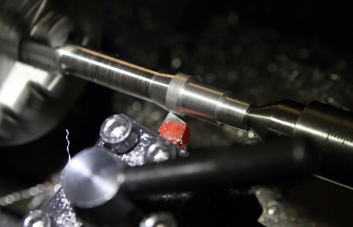

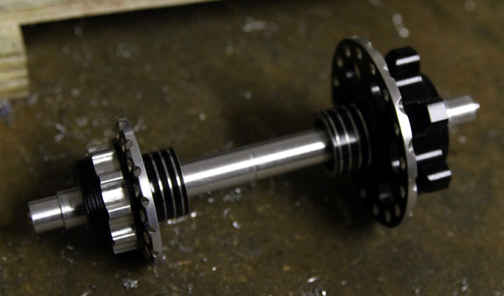

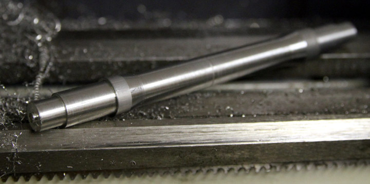

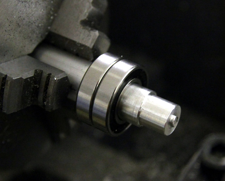

While that was doing, started on the axle

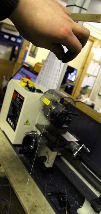

Cool swarf, hehe
Further along doing the axle
'Roughed' axle - with hindsight I should have done the axle last so I knew all the exact measurements. This would have meant I didn't need to re-clamp it which causes alignment issues and takes extra time and reduces accuracy a bit.

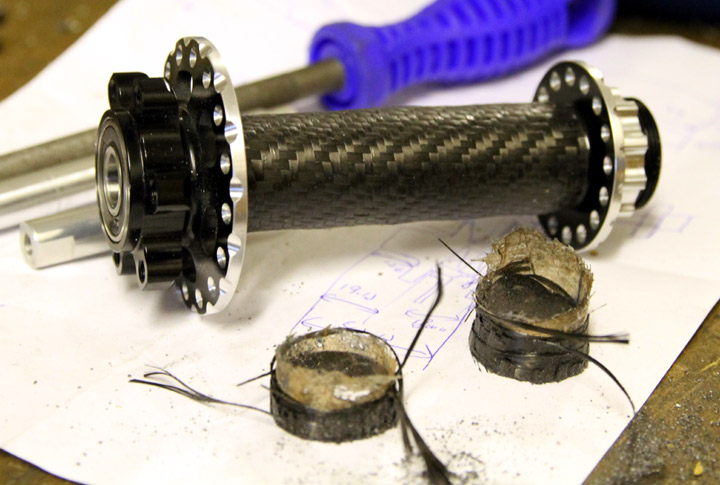

Carbon cured and ends cut off, testing fit - carbon was a nice press fit onto the flanges, win.
Checking fit
Turning the carbon down to the right length
Rads on the bore to match those on the flanges

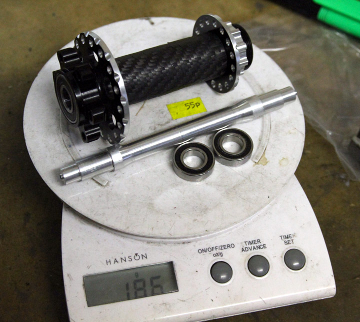

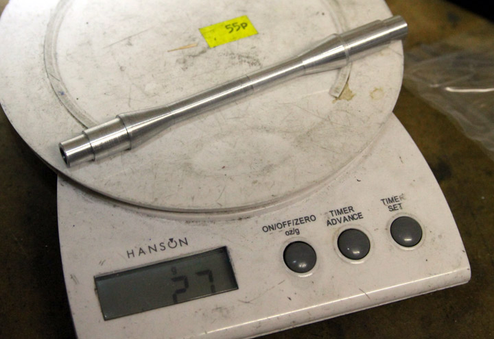

All the parts on the scales before the axle was finished

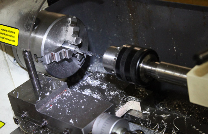

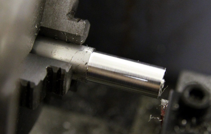

Drilling the axle out
More axle work

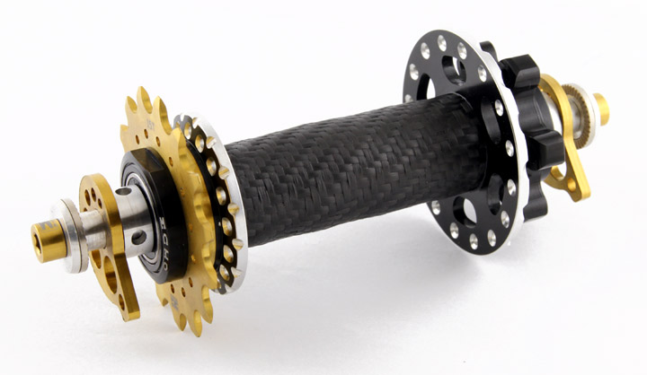

Finished axle (middle is solid, 7mm diameter so plenty strong enough, cold maybe remove a few more grams here but probably won't bother)

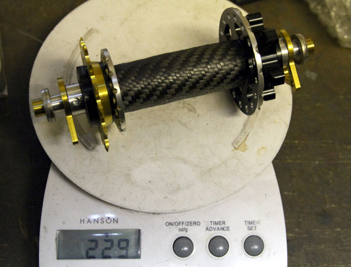

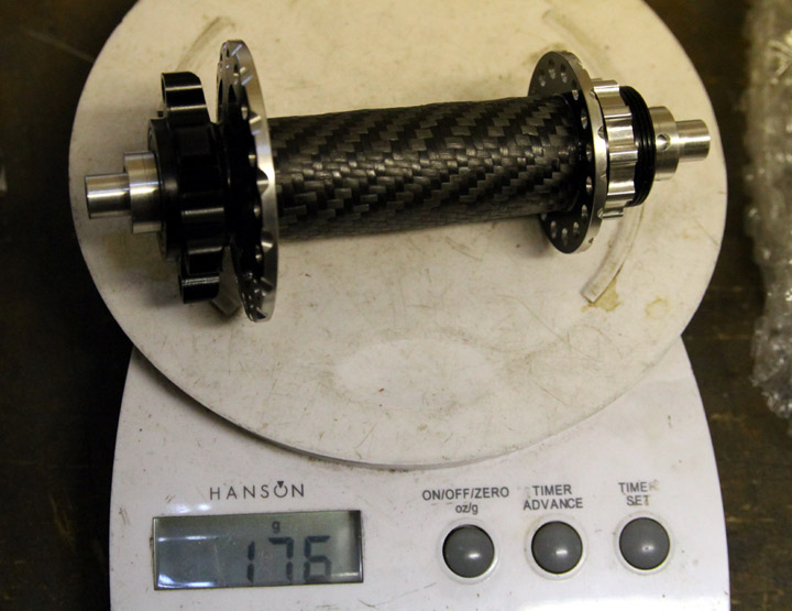

Complete hub. 'Official' Echo 135mm Disc rear version is 194g :)
Weight including all the hardware
More doodles and calculations...
Finished hub! Should be able to get it built up tonight :)

Carbon is done by hand (which is why it looks a bit poop - plus I needed the bore to be the smooth bit in this case). I should have sanded the fibreglass down a bit first but that's hindsight... The mandrel doesn't need heating, everything is done cold. With some polish and release agent the fibreglass doesn't stick well and came off pretty easily after it was split with a stanley knife (you can see the cut line in one of the pics). The fibreglass goes off after about 20 mins and the carbon takes around 12 hours (6-8 hours to go 'tacky').
