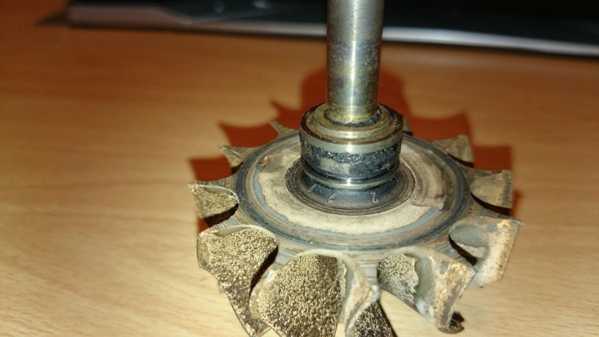

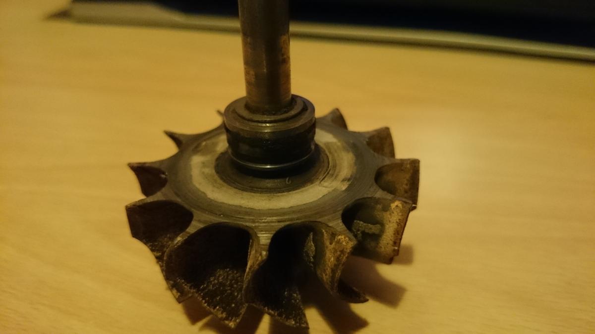

Any turbo masters here? Back side of the turbine wheel is pretty scored, how much of an issue is this?
There's also some bizarrely tough corrosion/deposit that I can't seem to just scrape off. Any ideas for removing that?
My concern is that the turbo re-balancing place will refuse to balance it due it not being in tip top condition (which they seem to require).
And I really really don't want to shell out for a new turbine wheel because that'll cost more than I bought this turbo for. (TD04-15G)

Personally, I'd say that's f**ked.
In something that's going to spin at around 100000 rpm, I'd want it mint too.
Shaft and bearing face don't look that great, and I'd say the turbine damage is a result of thrust bearing failure and spinning on the back plate of the CHRA.
Usually, wheels are bead blasted when a turbo is rebuilt to get them like new again.
