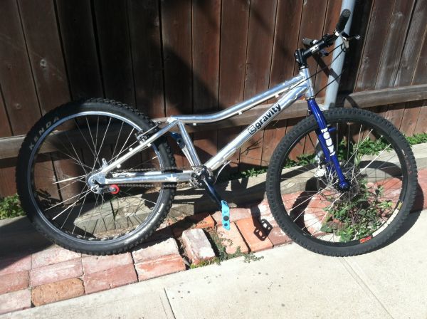

Do you generally have to lean back, pedal forward, and pull up with all your might to wheelie?
(And even then I can only get the front tyre about 30cm off the ground.)
Maybe its my setup that could use some help?
26" wheel, 170mm crank arm, 100mm 25 degree stem, 22T chainring, and 18T cog.
Sound ok or should i change something?
Ps. was thinking of changing the cog to 22T and putting a 30mm 25 degree stem on for the time being.
Better?

Stand up on the pedals, move your hips towards the bars, pull up while putting a half pedal stroke in to get the front wheel off the floor, as its coming up lean back and get your bum low/sit down. A half pedal stroke and a fluid movement of weight from over the front of the bike to the back of the bike low down should be enough to get you to the balance point, then continue pedalling like a boss, using your back brake to help keep you on the balance point.
You'll know when you get it because it'll happen in a split second, and you'll be on the floor clutching your arse/coccyx in massive amounts of pain :)

If you find it hard to do it without pedals; try compressing down and then moving your body weight backwards horizontally and then pull up once the front wheel is off the floor, rather than just moving up and back. Seems to work for me on bikes with a lower bb.

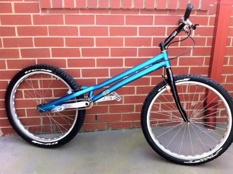

In riding my bike a little more last evening I am getting the front tyre a bit higher but it is really difficult. Looking at my bike and comparing to some of the really nice bike pictures posted on-line it looks like my hands are a little too far forward over the front axle. See the angle of the stem in this pic. Where could I buy something like this?

I'd like to get a high angle long stem but just don't know where to go.
The reason you see long high stems on modern bikes is because the BB is so high.
Your bike looks like it has 0 or very little BB rise so maybe a long high stem isn't the best option.

I don’t understand the correlation between the bottom bracket and stem. When I look at my bike it seems the BB is lower and further forward which would seemingly make it more difficult to get the front end up because my weight is further forward of the rear axle, no? Are you saying it’s not going to make much of a difference what stem I put on because its more of a BB geometry issue?
J Mc it seems like the bike is front loaded or front heavy. I just touch the front brake and I'm up on the bars with the rear wheel way high in the air. Super easy to do front endo's! I was hoping a higher stem might get some weight back on the rear wheel but CalopS may have a good point about the geo of the BB & chain stays now that I'm thinking about it.
I was just trying to point out that just because modern bikes come with high long stems that it doesn't mean it'l work on yours.
If you looks at frames from past to now as the bb has gotten higher the stems have gotten bigger to balance it out
Fair enough. I was on the Tarty website just now looking at the stems and saw this little video from them pop up on the screen. It was an informational video which indicated a taller stem is good for taller riders. Since I'm 185cm I'm thinking I might give it a shot to see if it makes a difference. Stay tuned. ;)

Basically if you have a high BB you need a high rise stem to compensate the fact your stood up higher than you would be with a low BB bike. Being tall does come into it to a degree but the difference between say a 120 x 17° which would probably suit your bike to a 165 x 35° mod stem is a hell of a lot. It may seem easier to lift the front with a very high stem but due to the BB height when on the back wheel the front end will be quite low which will make it hard to balance, a lower stem will allow the front end to come higher helping get the centre of gravity more over the rear wheel and help balance.

On a street 24 the requirements for components is different to a traditional trials bike. Your setup is going to be focused more towards general 2 wheel control to help bunnyhops, spins, etc whereas a traditional bike is focused more (not completely) towards rear wheel control and static moves
