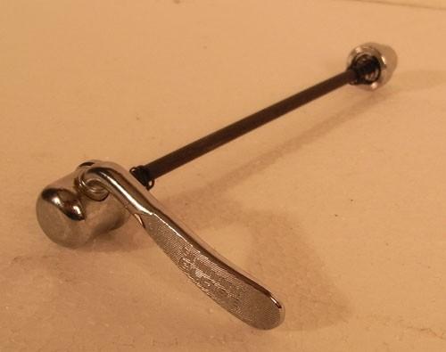

Basically i have two issues with my inspired currently.
One is the fact it has a QR on the front with my hope hub, has anyone came up with a successful bolt through answer for 9mm hope hubs.

What trouble are you having with the front ? My hope pro 2 hub used bolts, not QR and it was all good.

My first version was a 15mm od alloy bar, drilled and tapped to take 10mm bolts and then I used Hope's 15mm end caps and just slid the bar in. Works well but my tapping skills were sub par that day so I'm a little worried it may strip one day.
My second version (that Adam Tart made) is an old Echo axle turned on a lathe (and drilled and tapped to take 10mm bolts) so it its on the INSIDE of the normal Hope end caps and cut to length so it fits inside the hub lengthways, I then drilled the 9mm QR parts so it was a 10mm hole for the bolts to go through. Much neater than the first version.
