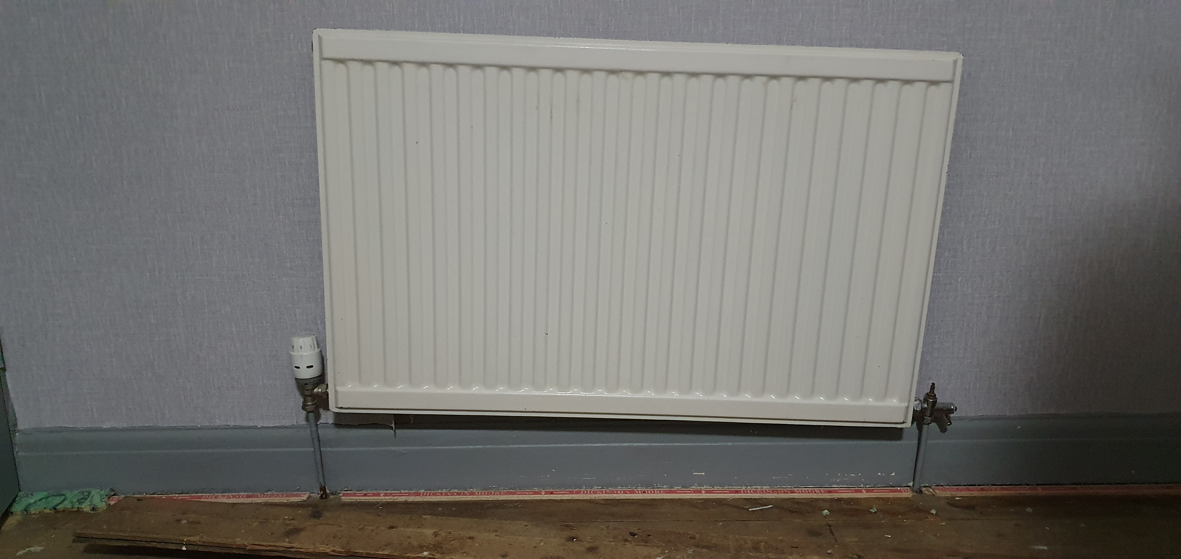

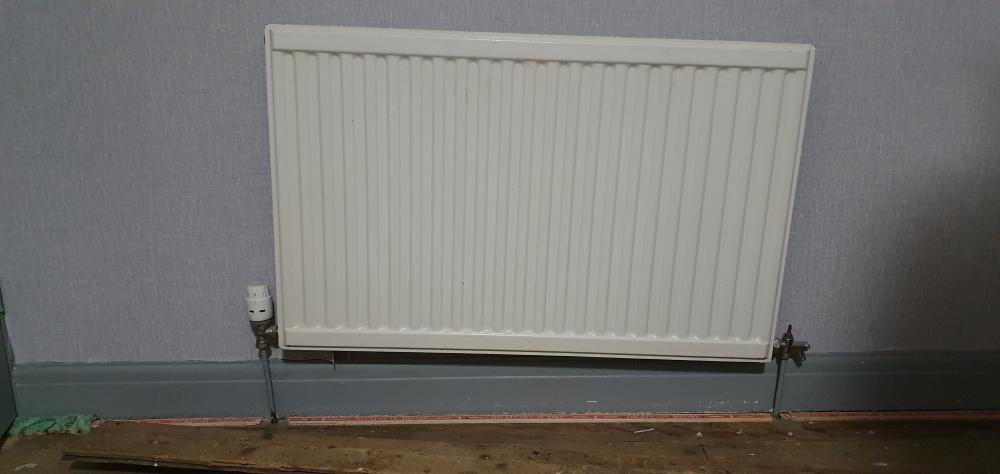

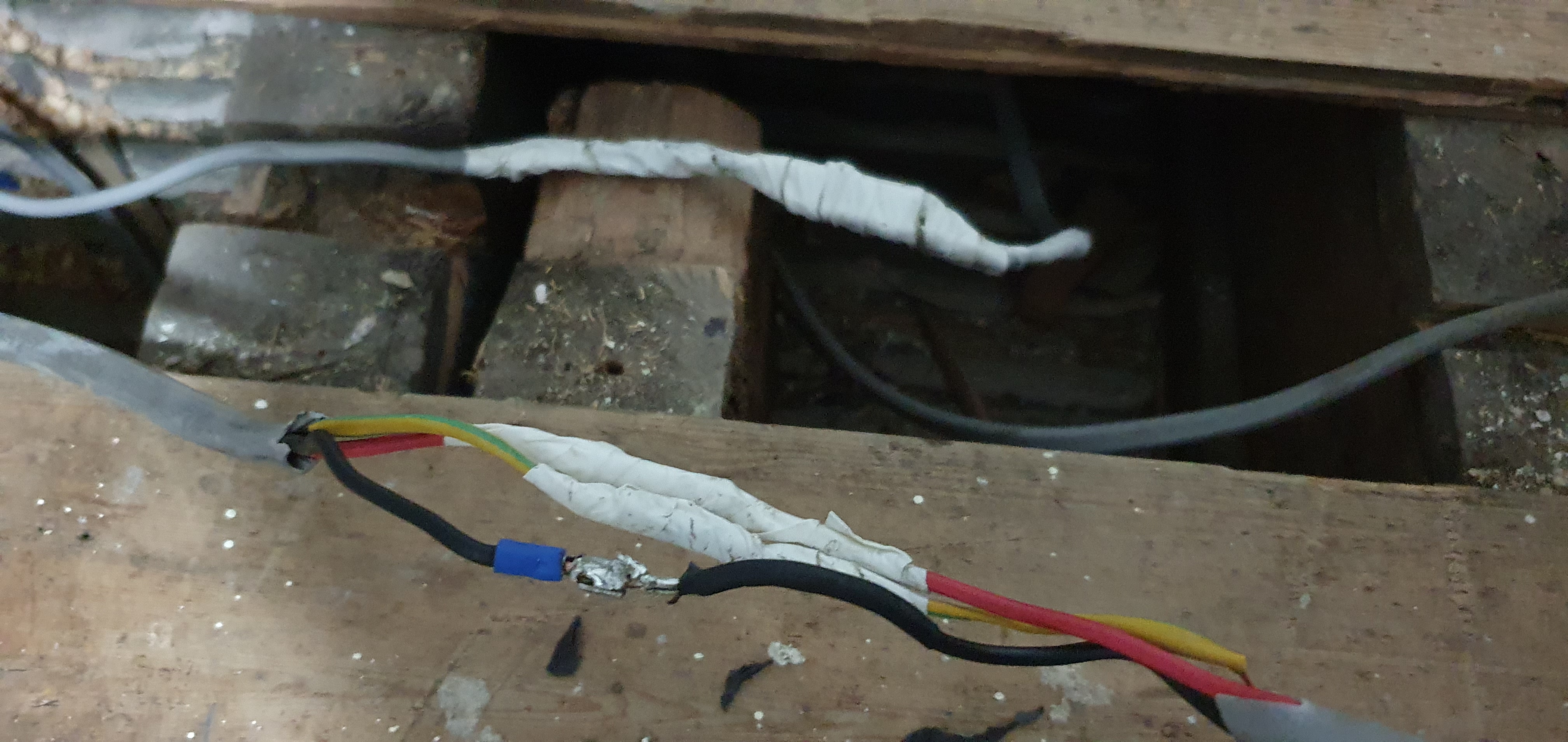

  10. I've recently just purchased a house, also had no issues with tripping switches or flickering lights, while messing with other stuff and running network cable etc. I have found some scary shit including: 6mm cooker cable live and not attached to anything behind the cupboards The kitchen was just a spur off the ring main A socket in the kitchen was wired with 1mm 4 core lighting wire with the extra core just bent over Spurs on spurs on spurs in most bedrooms (the record was 6 double sockets on a spur in a small bedroom) Loose connections in sockets/switches and even in connectors under the floorboards The most annoying thing that I have found so far I only spotted the other day when moving some stuff that had been dumped in the spare room, how the f**k you can fit a radiator like that and thing "that will do" is beyond me, It has also been attached to the wall with M5x1.0 bolts, I have no idea how that is still on, I only know what bolts are used as one is at 45 degrees and only half in. Some people should not be allowed to do any kind of DIY. All the dangerous fire starting shit that has been found has been fixed and we are now finally able to decorate the living room, I think we have gone for a similar colour to Ali as it fits in with some built in furniture that's in there. VID-20211111-WA0007.mp4
