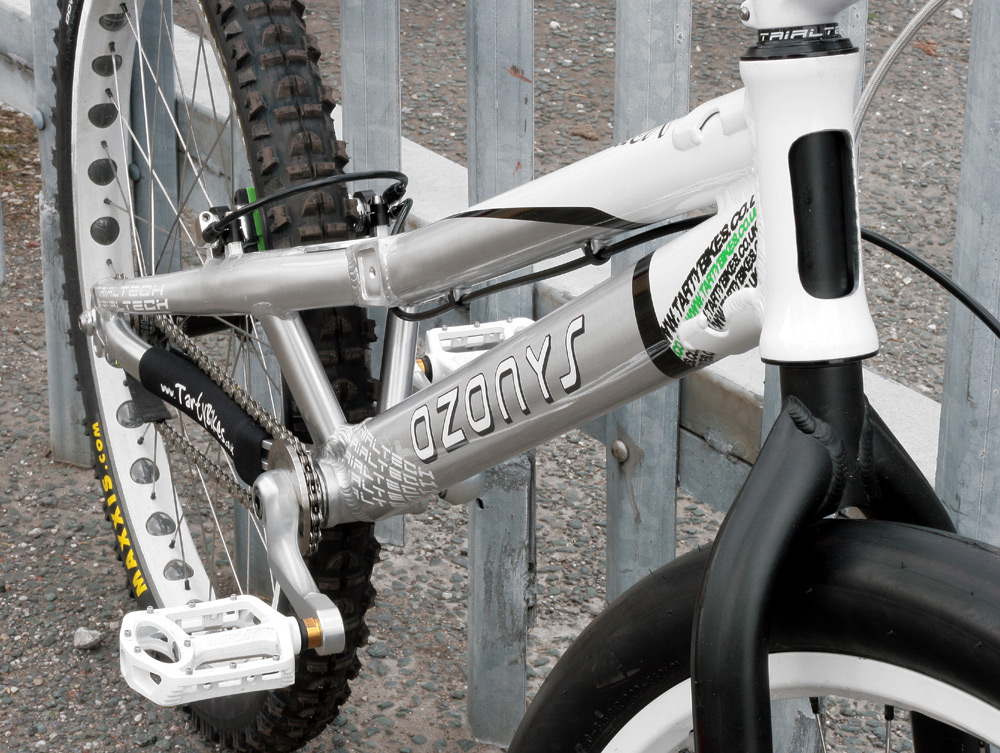

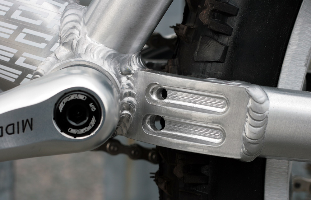

Ello all. Finally built my new Ozonys XR26 frame after doing some modifications to it and sourcing some parts. Tried to get it as light as possible, weighs in at 9.26kg which I am happy with.
Been for a ride tonight and I really like it! Geo is similar to the Cannibal but the wheelbase is slightly longer. Feels really stable on the rear wheel and with the bike being lighter, it feels really nippy. The front tyre is awesome!!! It was a pure experiment to see if would be good and so far on street its ace. Also got some new updated Echo Cylinders which seem very good so far, they are a much nicer shape. These are being held in place by some prototype Try-all clamps which are pretty pimp.

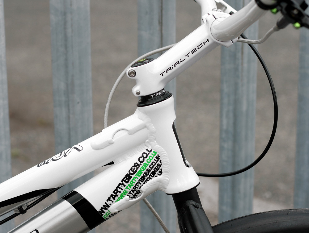

White for the win! :) Stem looks pimp and is super light!

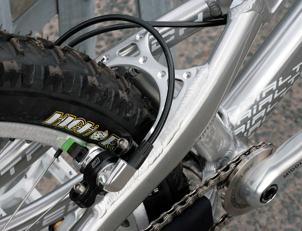

New Echo Cylinders..

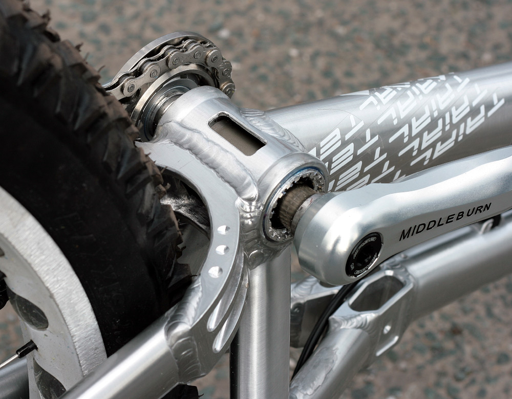

Taken a lot of material out of the yoke, you can see right through the back of the BB yoke and out of the headtube.

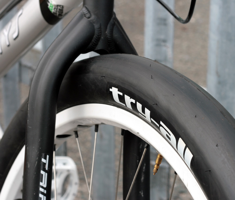

A proper slick tyre!

Not sure on the front tyre, looks like you forgot to put a tyre on all together... However if it performs, fair enough. Saves cutting the knobbles off I suppose..

Front tyre looks nasty, but how's it performing under different conditions?

Only rode with that tyre for 2/3hrs, but so far I like it more than one with tread. You get more feel through the tyre, and its suuuuuuper stable, basically there are no knobbles to bend or squirm so it feels very sturdy! Seems to grip your average street stuff very well. Not tried on natural yet, but will do this weekend. The only downside I can see of the tyre is wet conditions, but it only takes 2 mins to change it.

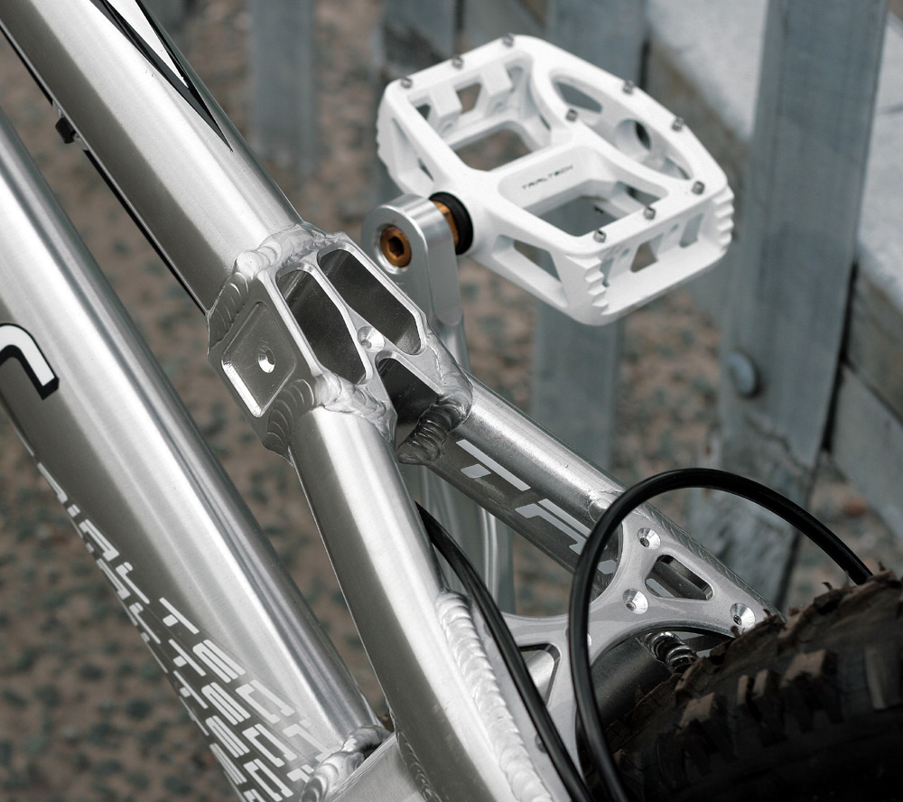

EDIT: also are the reflector bracket things on the pedals really needed, could cut them out surely. Suppose DMR pedals have a support there for a reason.

I assume the rubber is either a bit of a thicker layer than standard, or is a slightly harder compound than the regular Try Alls to compensate for wear?
Definitely intriguing, though wet conditions could be pretty interesting which puts me off a little
Have you tried one on the rear yet?!
loads of little neat mods! i want to do that to my headtube, i saw a bmxer that had the shell drilled out on the bb shell too, i thought it looked neat until realising how much dirt can get in! but nevertheless good effort.
im sure all them stickers weigh a few gram or 2 :P
im very curious what that front tyre is like, what is it intended for?

The compound seems pretty soft! The main area of the tyre is just slightly thicker than the sidewalls. It weighs in at 591g which is forkin light! A slick tyre will take ages to wear anyway as the pressure/grip is spread around the surface rather forced onto a couple of knobbles.
Not tried one on the rear, as I think the rear tyre is worked much harder and in different ways so it needs the knobbles. I suppose it could be worth a shot, but I'm not sure.
