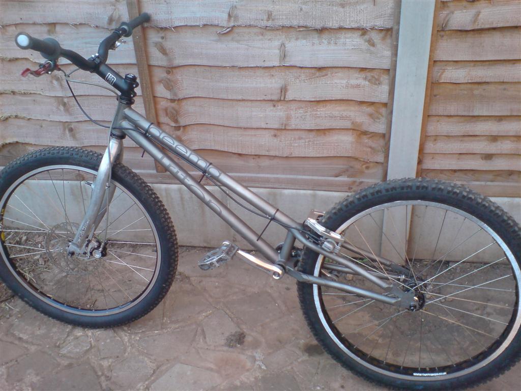

Its built and has been ridden, its light, its flicky, its so damn easy to ride :D

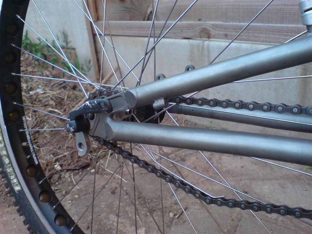

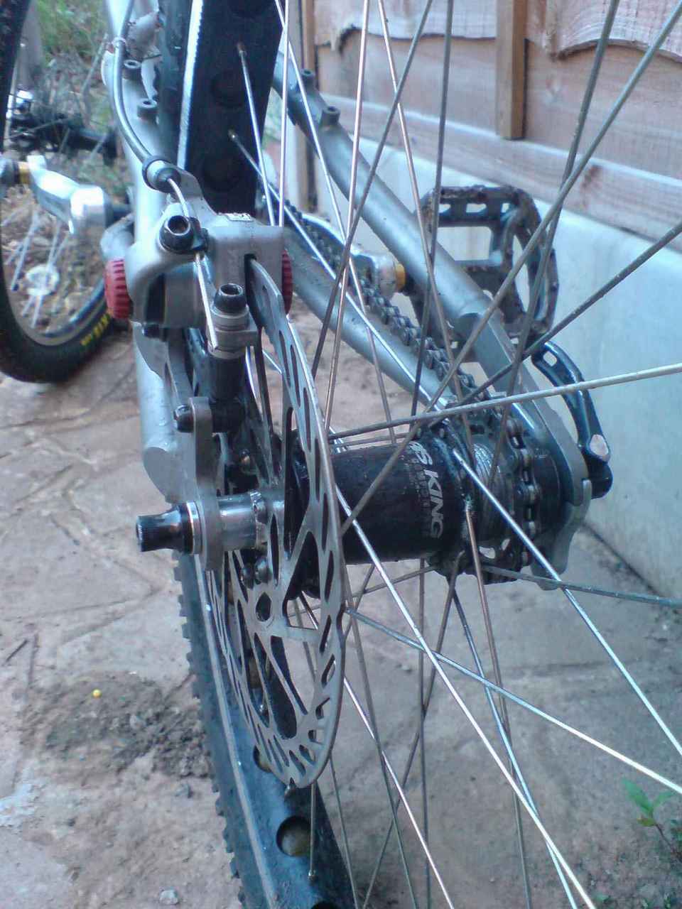

My only niggles are that the rear brake is too stiff with the 4 bolt control booster on and theres bugger all bite on the rear brake, going to test it with only 2 bolts through the booster to see how it goes. The chain tensioner needs some slight mods, mainly a shoe for the chain to run on, the plain spoke on its own has skipped off the chain a couple of times.
Complete spec is: -
Triton deema frame
BT f6 fork
FSA orbit xtreme headset with hope head doctor
Atoms oversized stem
Monty 221pr bars (extended by 100mm to 780 wide)
ODI roughneck grips worn to paper thickness
Wellgo MgTi pedals
165 Middleburn RS7s with heatsink cloud9 (18t) on a UN52 BB with a sram PC1 chain
Home made chain tensioner
Chris king disc go tech rear hub with 16t king cog laced into a tryall rim
Highroller 2.5 in slow reezay dual ply with dh tube
Hope xc font hub laced into a mavic xc717 rim
Larsen TT 2.35 in super tacky single ply with standard tube
HS33 slaves with RB ergo 1f lever, heatsink cnc reds, echo control booster and a water bleed
Hope mono trial 203 disk with a +20 adaptor

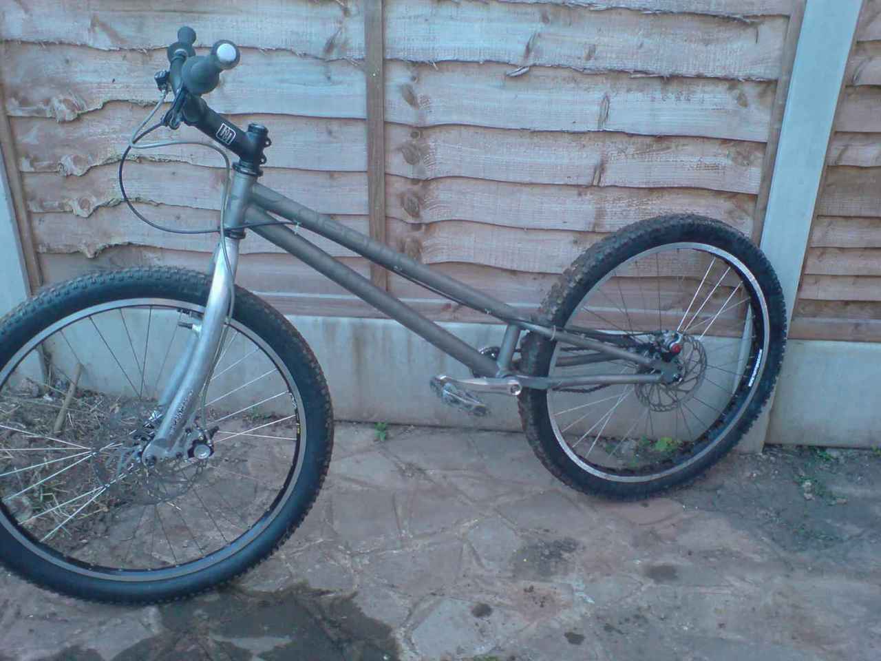

Complete weight 10.6kg or there abouts :)
Alot of weight (about 300-400g I reckon) could be saved on the rear tyre and BB if I went down to a single ply and a hollow axle.
Geo with BT f6 fork is: -
WB 1080
BB +30
CS 385
Reach 670
Frame weight 1.585kg/3.487lb

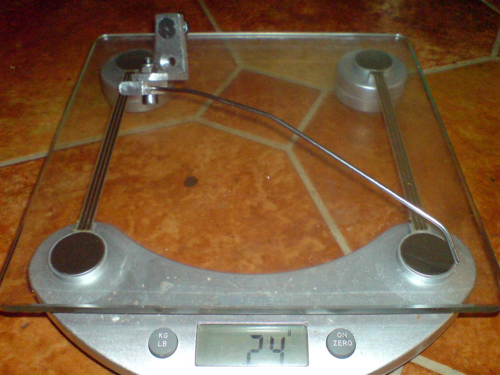

Homemade chain tensioner - 24g including all fixings :D

Shes now double disk and wearing the hope titanium BB :wub:
Total weight of the bike is 10498g :) :) :)
When the rear tyre dies I will put a schwalbe big betty on there and the weight should drop down to about 10.2kg :D
All of this without cutting/drilling holes, fancy lightweight bolts or much else specifically lightweight (well apart from the frame, BB and pedals spindles which are titanium >_< )
Excuse the crap phone photos :(

Im planning on rigging up my front caliper onto the back with the rear hose and lever from my santacruz, will give me some indication of how its going to work as DD. I can only run a 180 rotor max on the back, any bigger and it just catches the frame, will try it and see. Still in 2 minds between a mono trial and a BB7 for the rear, I love the feel, power and bite of the front hope - is the BB7 the same feel at the lever or is it spongier?
Ive not tested it without the booster yet, will have an experiment with it tomorrow; agree with you though it looks much better without it (also means I would be able to purge the only deng thing on the bike :D )

Im really leaning towards a 180 mono trial on the rear, whilst the BB7 might be more powerful I like to feel when the back brake has bitten, also the hope would seem to give more modulation :)

Got one on the front, main problem is I cant get more than a 185 disk on the rear without reducing the thickness of the disk adaptor on the hub which in turn may bugger up the caliper alignment.
The BB7 holds fine, the bite isnt as good as my 203 mono trial on the front but hey; I think Im also alittle too rusty and out of practise to be dealing with the spoke flex on top of all the other variables when on the back wheel - at least with the magura it locks and doesnt flex :)
