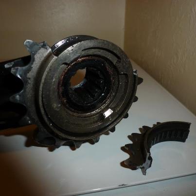

post-26113-0-19194200-1342551078_thumb.jheres my echo sl 2 and a half years old of pretty much every day riding
another one on its way :D

Although my SL's have never skipped on me, one of them cracked on the pawl carrier, and my current one seems to have lost half of its engagements.
