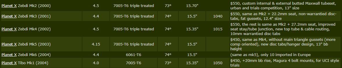

What do you think about the developments in geometries?
A 71.5ish head angle used to be the norm across the board; and still is on most static-oriented bikes, whereas the streetier side of things is steadily pulling steeper without finding an equilibrium yet, like we seem to have done with the rise in bb height in the mid 00's. Maybe there's avenues to explore by going steeper still in both ends of the discipline.
3 degrees will make a huge difference in term of reach-adjusted wheelbase. With the addition of shorter back ends and lower offset forks, it will affect a lot of aspects of riding and highlight how a PX Zebdi is so different from a Hex, despite their similar wheelbase (to be corrected? What did the Zebdi's measure in at?).
Given that, and approaching my build with a slightly more trialsy angle (meaning a longer stem), I've actually settled on a wheelbase for the Union not too dissimilar from the Hex, with some tweaks to mine and Andy P's current frames (+ JJ's shorter version and Martin Pretorious' longer version) to make it the all-rounder it's shaping up to be. Luckily these tweaks suit a streetier build as well too, and we've had some great input there.
As someone said in another topic about Jeff Anderson(?)'s negative rake (backwards) forks, to shorten the wheelbase with the same reach it seems there's more to consider.
