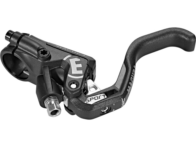

I’m very close to getting the last few bits for my Marino build, just wondering if anyone is running magura callipers and Shimano levers on their disc brake set ups?
im curious as to whether the love / hate flexi feeling of the magura is reduced when running Shimano levers?
I have a set of MT trail sports, and also have some Shimano zee levers kicking about... tempted to try it.

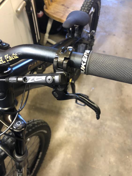

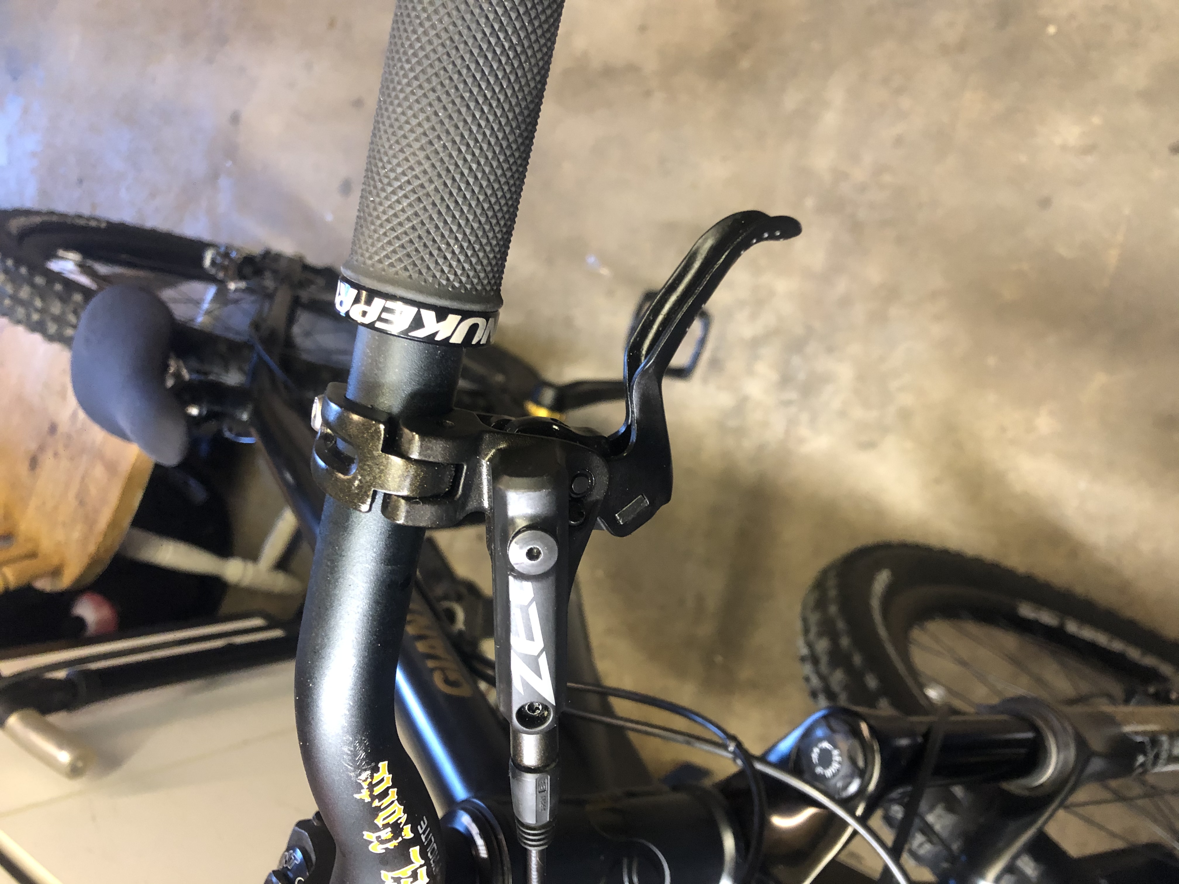

Yes, I can imagine them engaging pretty quick with the pads running so close to the disc. I do recall watching one of @Ali C vids where he mentioned the progressive power with the wave linkage of the shimano levers. After an afternoon in the garage I’ve got the bike built apart from the rear wheel as I’m waiting on the hub arriving. Ran the front hose through the steer tube, gave it a bleed - decided to stick with the Magura lever as it’s different to the MT5 and MT7 on my other bikes:
I must say it actually feels pretty solid, and the lever ergonomics are far better than the MT5s (albeit testing with the back end of the bike floating due to the lack of wheel haha).
So I’ll run these to begin with and see how durable they are, if they fail I’ll definitely give the shimano’s a go.

@Maintenance Justice haha yes it was! Another bike came with some shimano Deore brakes, so pinched the shroud and already had the rest :)
Initial thoughts are that it feels great. As @Mark W has mentioned the arch feels very different but I’m sure I’ll get used to it.
thanks for your time yesterday too

@Rip You still get reach adjustment on the zee levers, but HC3’s have more adjustment points making them more configurable.
Feel wise it really is down to preference. I’m yet to ride with them properly having only really played around on my drive, but I personally like the light feel they have, the firmness when the pads bite and most of all the quick lever return. I did come from a standard MT5 lever though.
I run HC1’s on my Marino which I absolutely love. I’ll report back after a decent ride.
