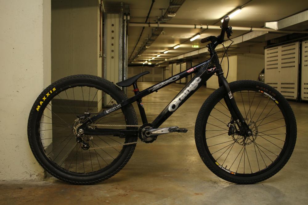

  9. Look sooooo nice Really nice neoretro build, I really appreciate. I build an Orange Zero like this, it was also really nice to ride.
