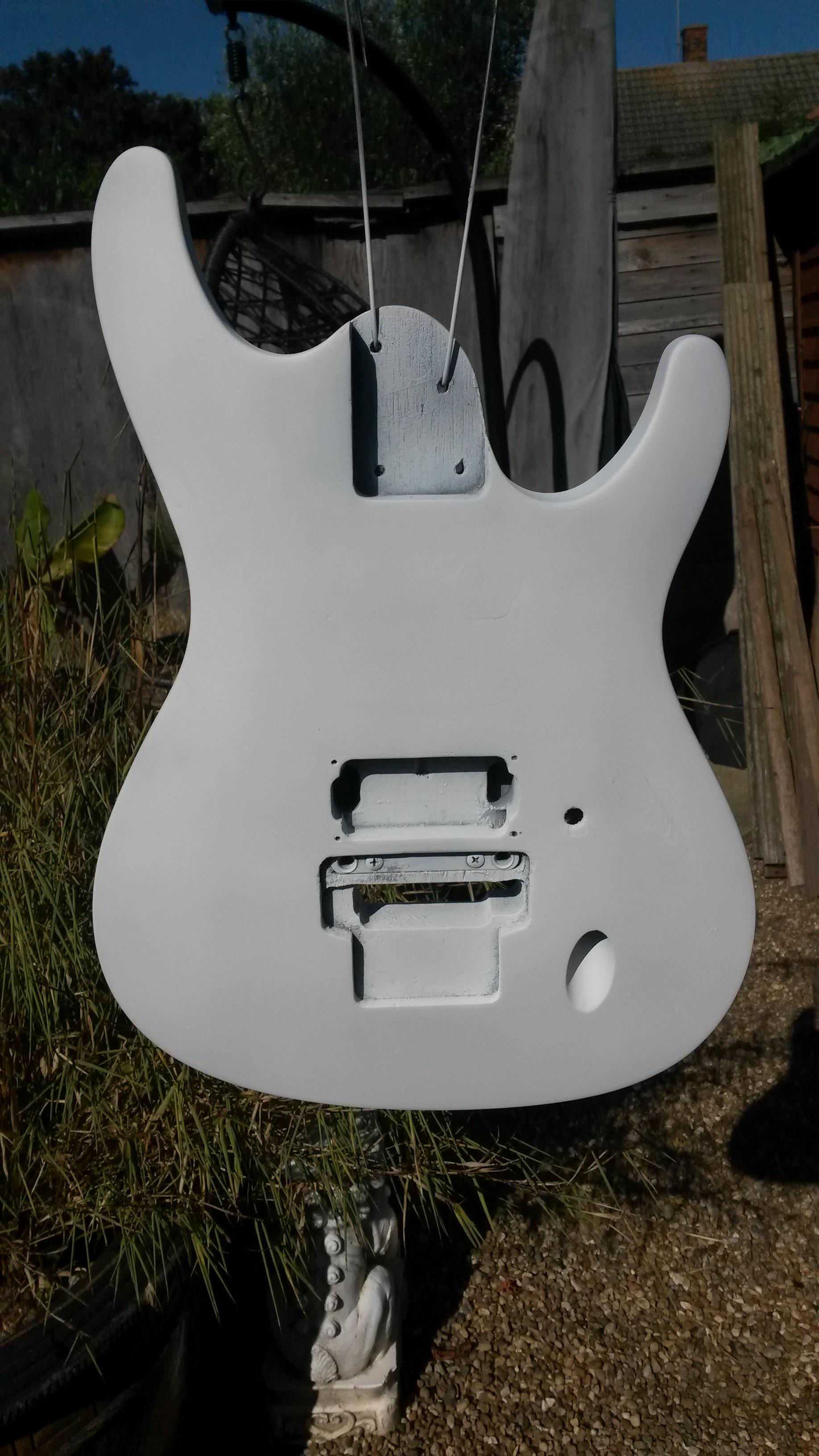

Bit annoying, got an Ibanez wizard 2 neck for my project body but the neck sits a good 3-4mm too high, is this a case off either 4mm off the body or the neck? I thought all the Ibanez cavities were the same but obviously not, I'd rather mod the body as it's only a cheap one, but can that be done without ruining the fresh paint at the edge? The neck cavity on my other two Ibanez RGs is deep enough to compensate for it. Ignore where the string is, that's with the bridge screwed way up past where it should be.

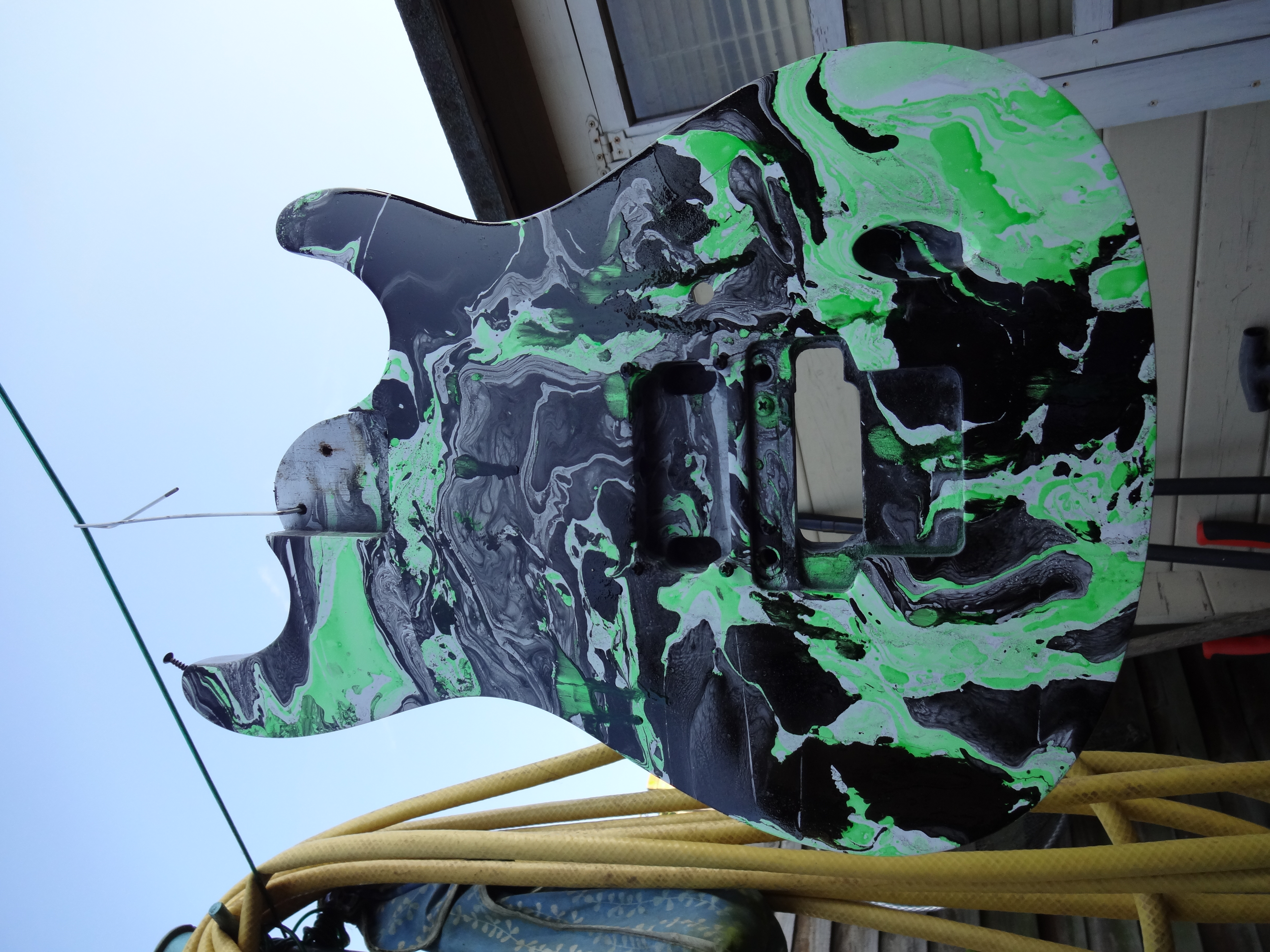

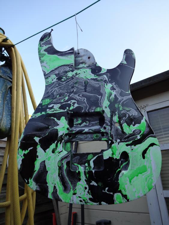

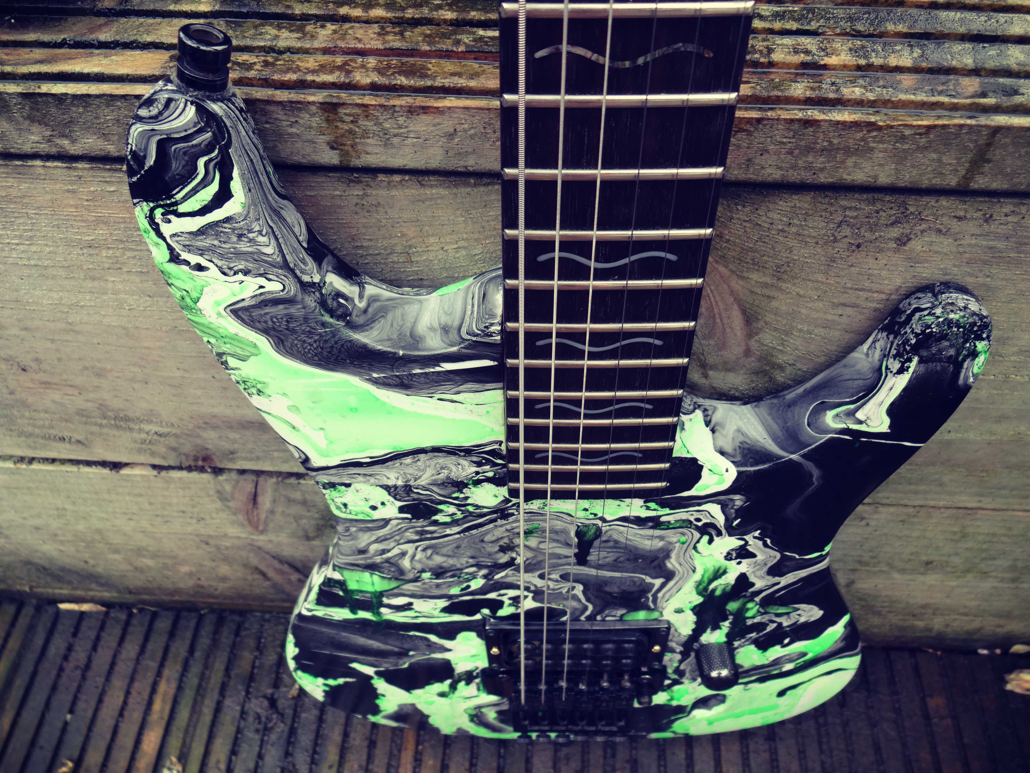

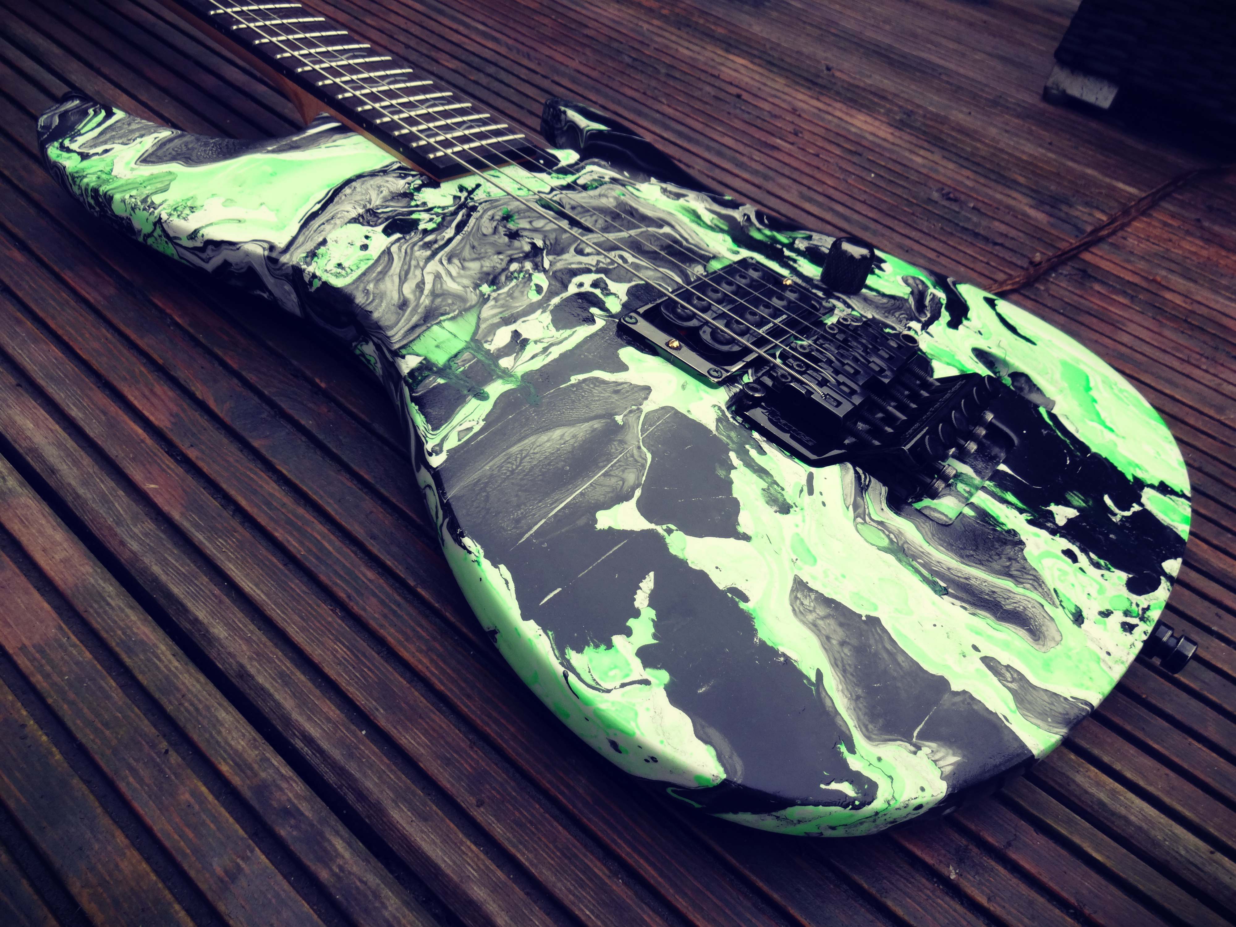

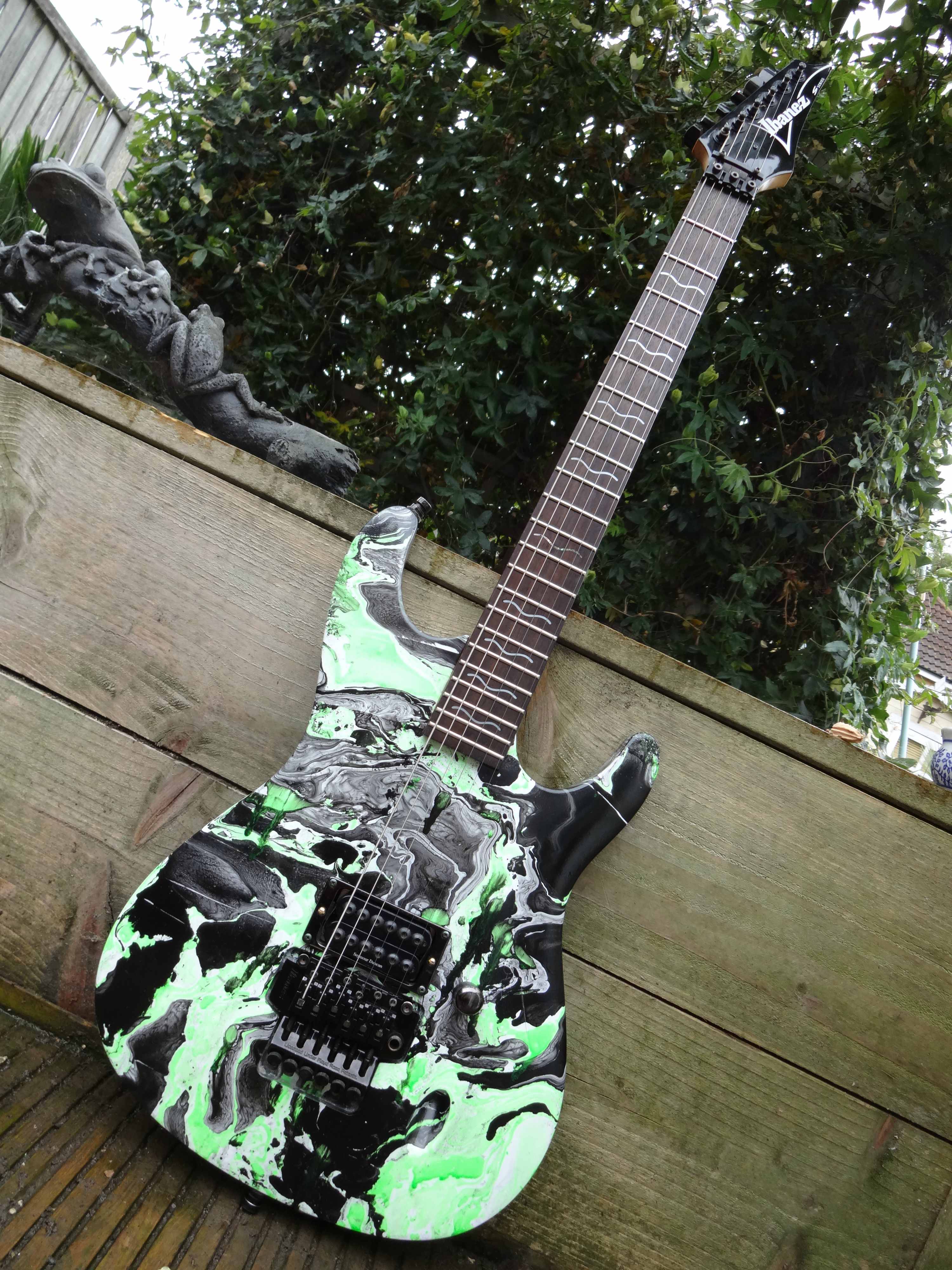

Yes, but I used Humbrol enamel model paints, I've seen people use spray but I think it's much harder to control, with paints you can put one drop in at a time and swirl it how you want it, it can get really complex, some people use heated water, borax crystals to break the surface tension, thinners to spread the paint better and probably more I don't know about, but I just had a go with cool water on a warm day outside. There are hundreds of tutorials on YouTube but everyone does it slightly differently, and the top guys are never gonna give away their secrets. Tried a different brand of enamel paint as Humbrol don't do some of the neon colours, and the paint just sunk to the bottom in lumps. I also tried mixing Borax but couldn't get it to dissolve so I had to abandon that. I'd definitely do some trial and error on a plank of primed wood or something worthless.

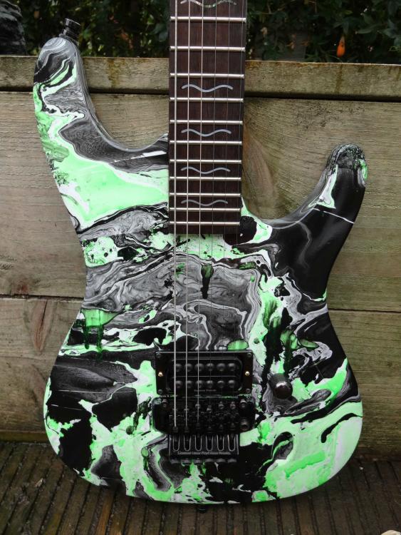

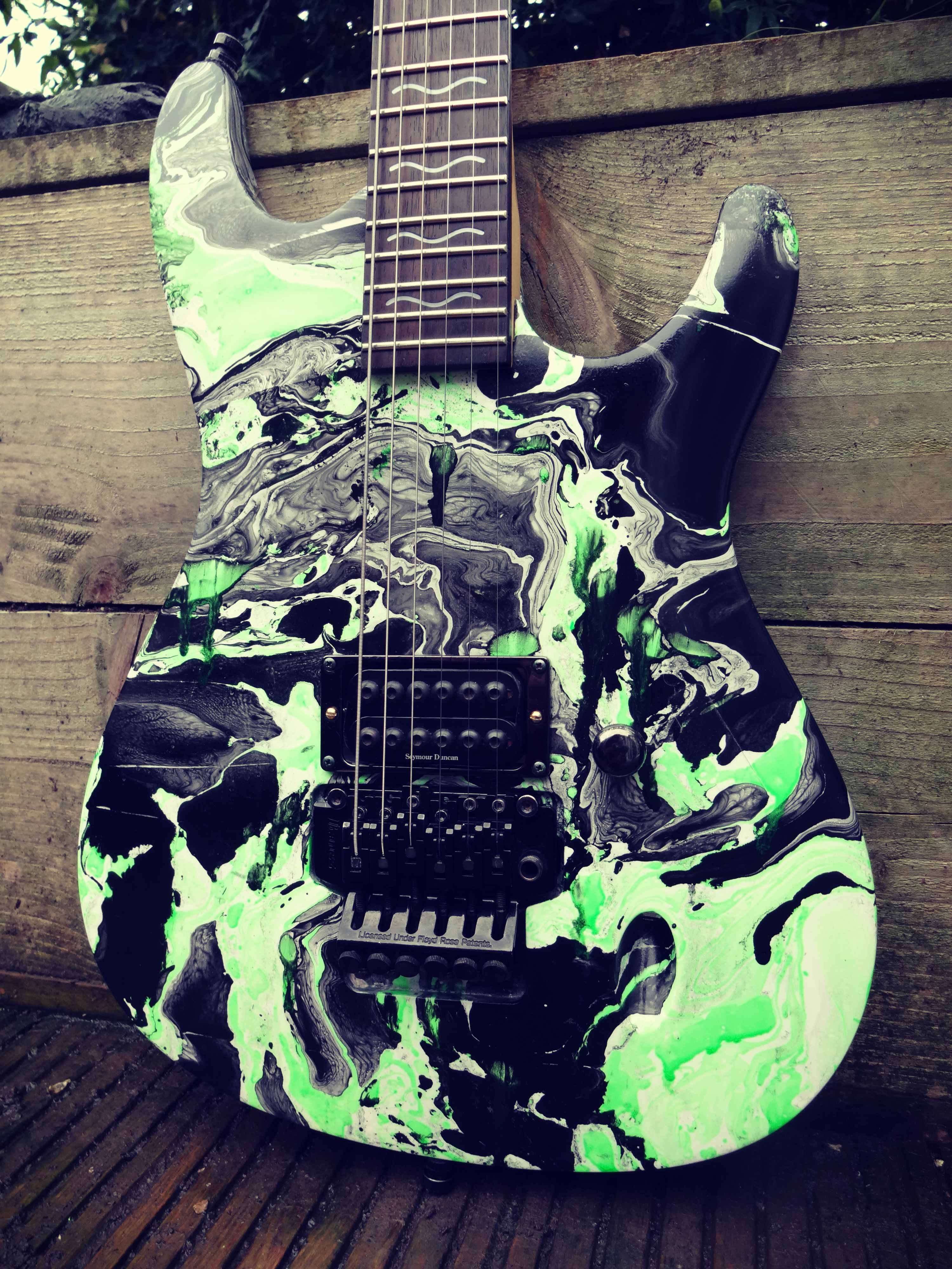

Cheers, I wanted a bit more green, and I got a couple of runs near the volume switch but it's so unpredictable, I think I used way too much paint on my next two attempts but I'm happy with this one. This is the dream....

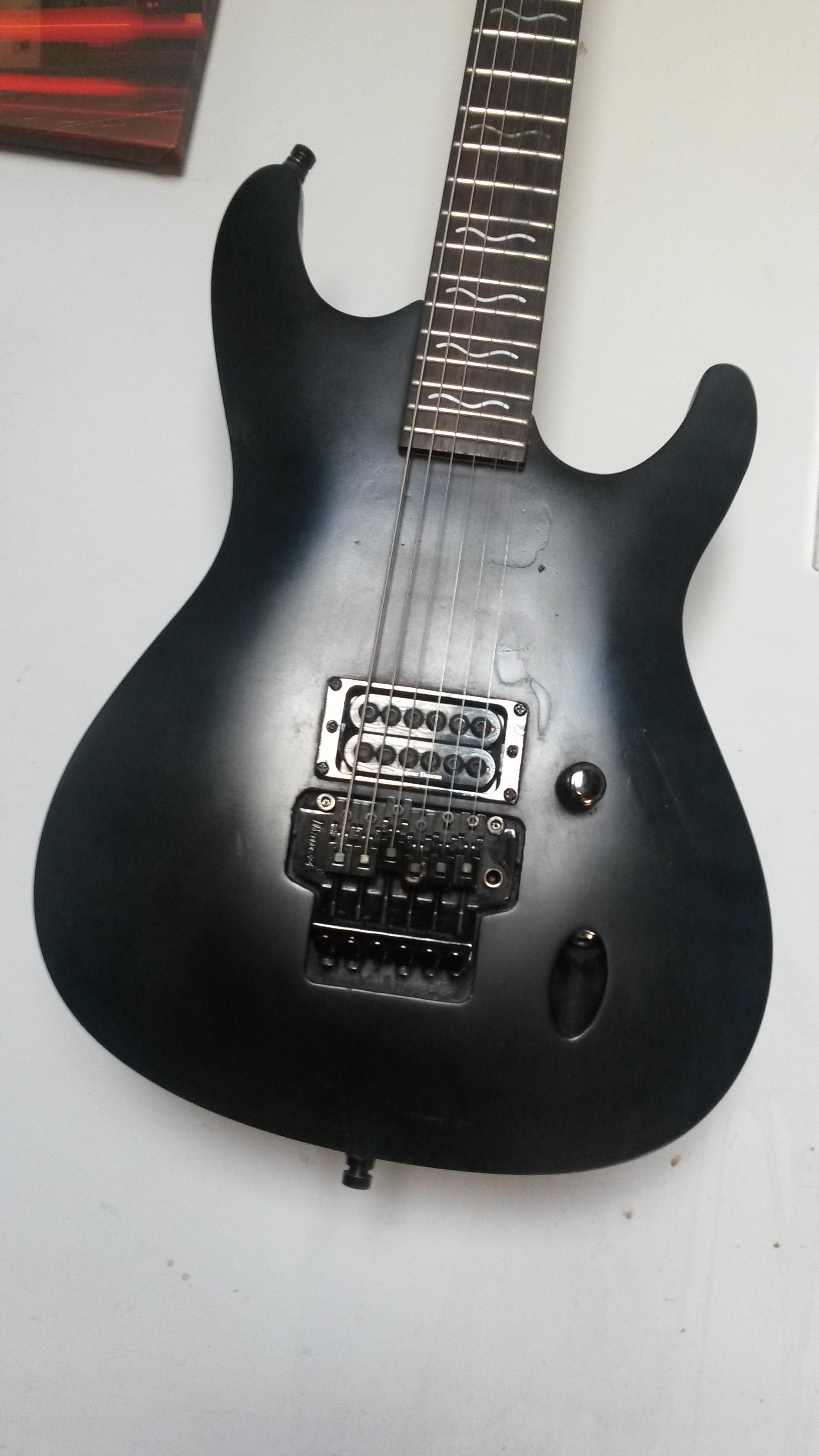

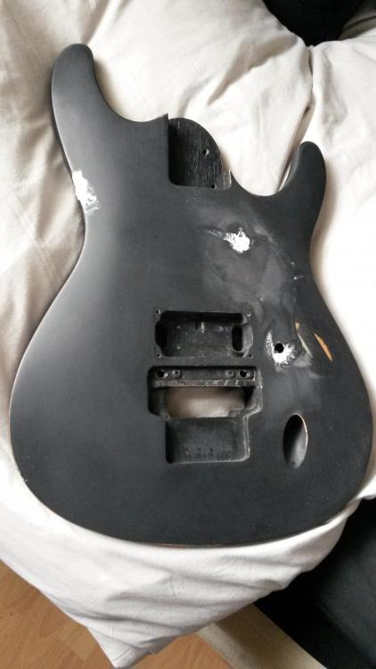

Bought an Ibanez S370 which was pretty tatty for £80, always wanted a swirl paintjob, so I gave it a go, turned out pretty good for a first try, but I tried two since which failed massively.
