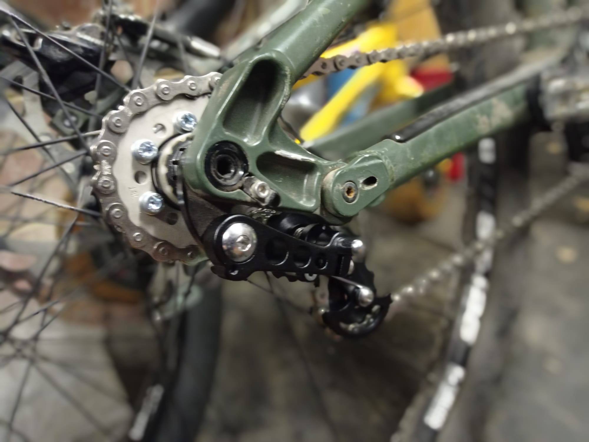

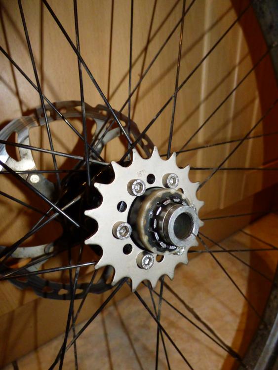

  16. And we're officially singlespeed! Got the bits waterjet cut this morning and all seems good. Turned the lockring on the lathe briefly just to tidy up the Dremelling but works perfectly . Chainline seems about right too which is good!

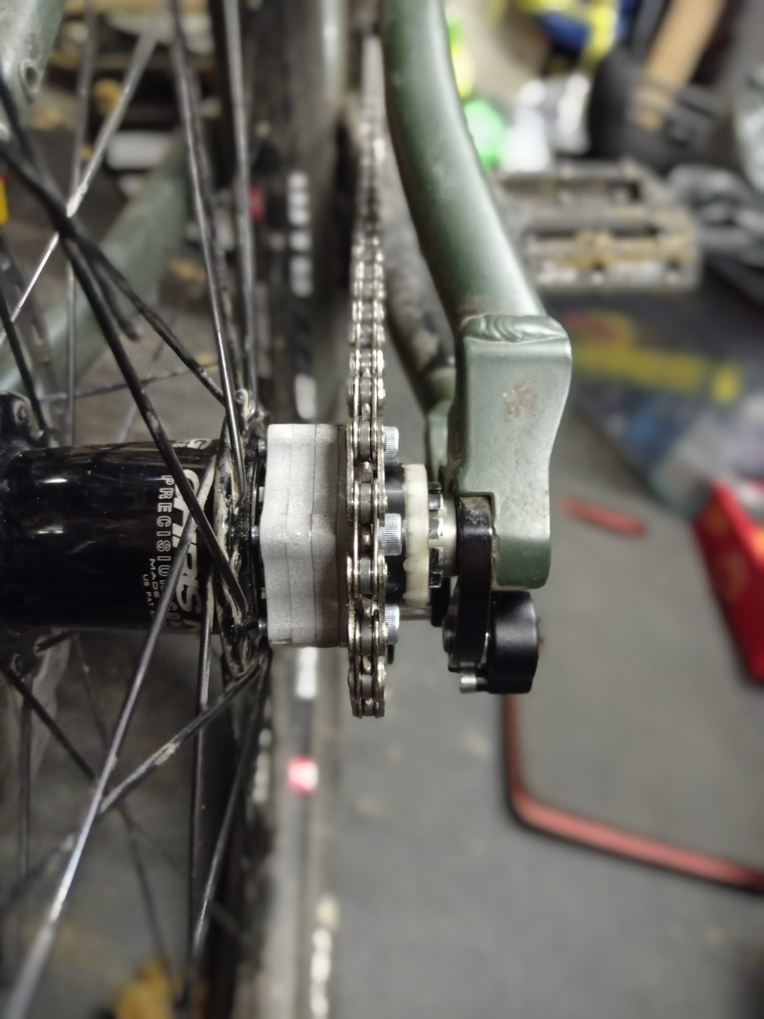

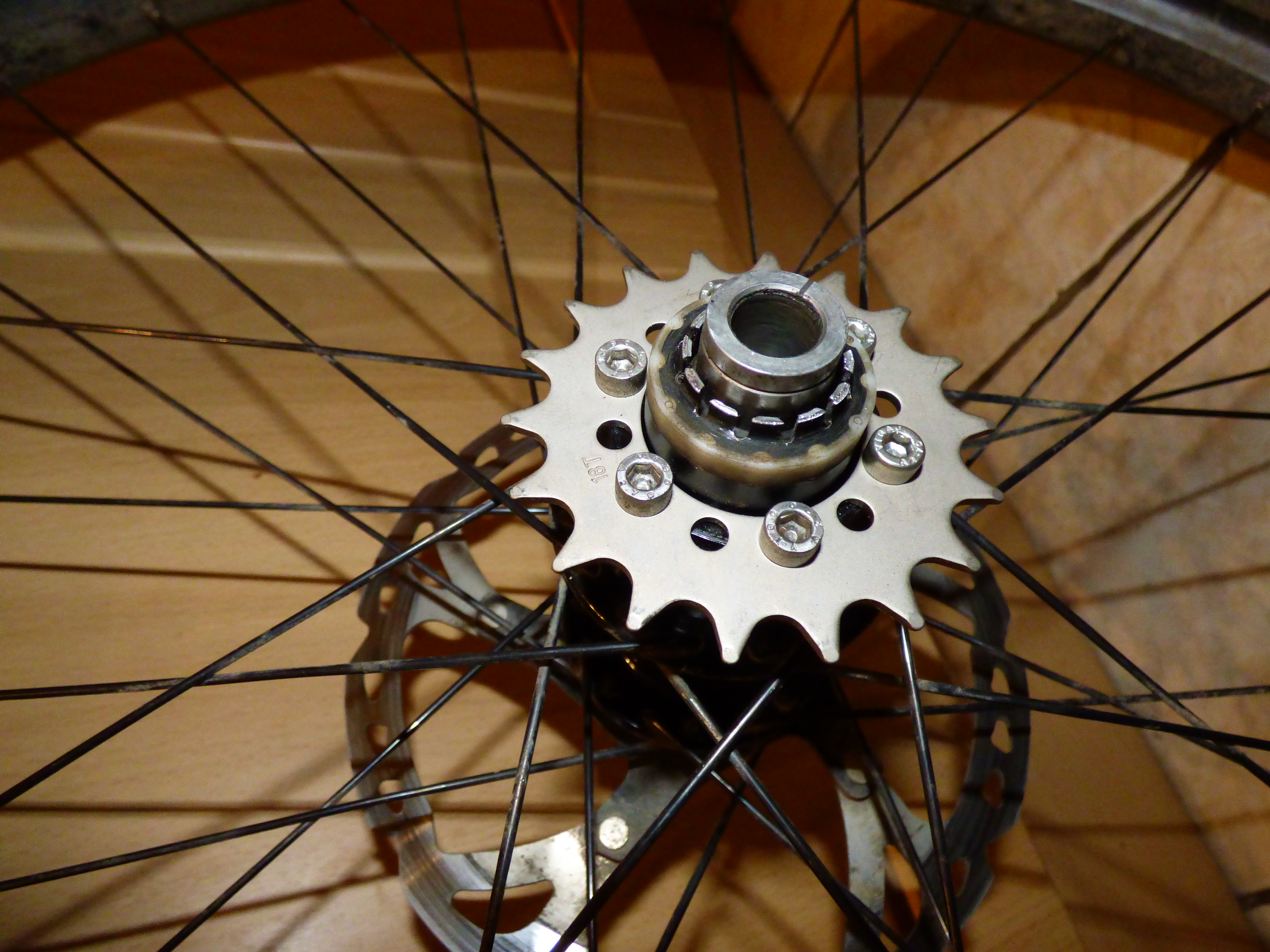

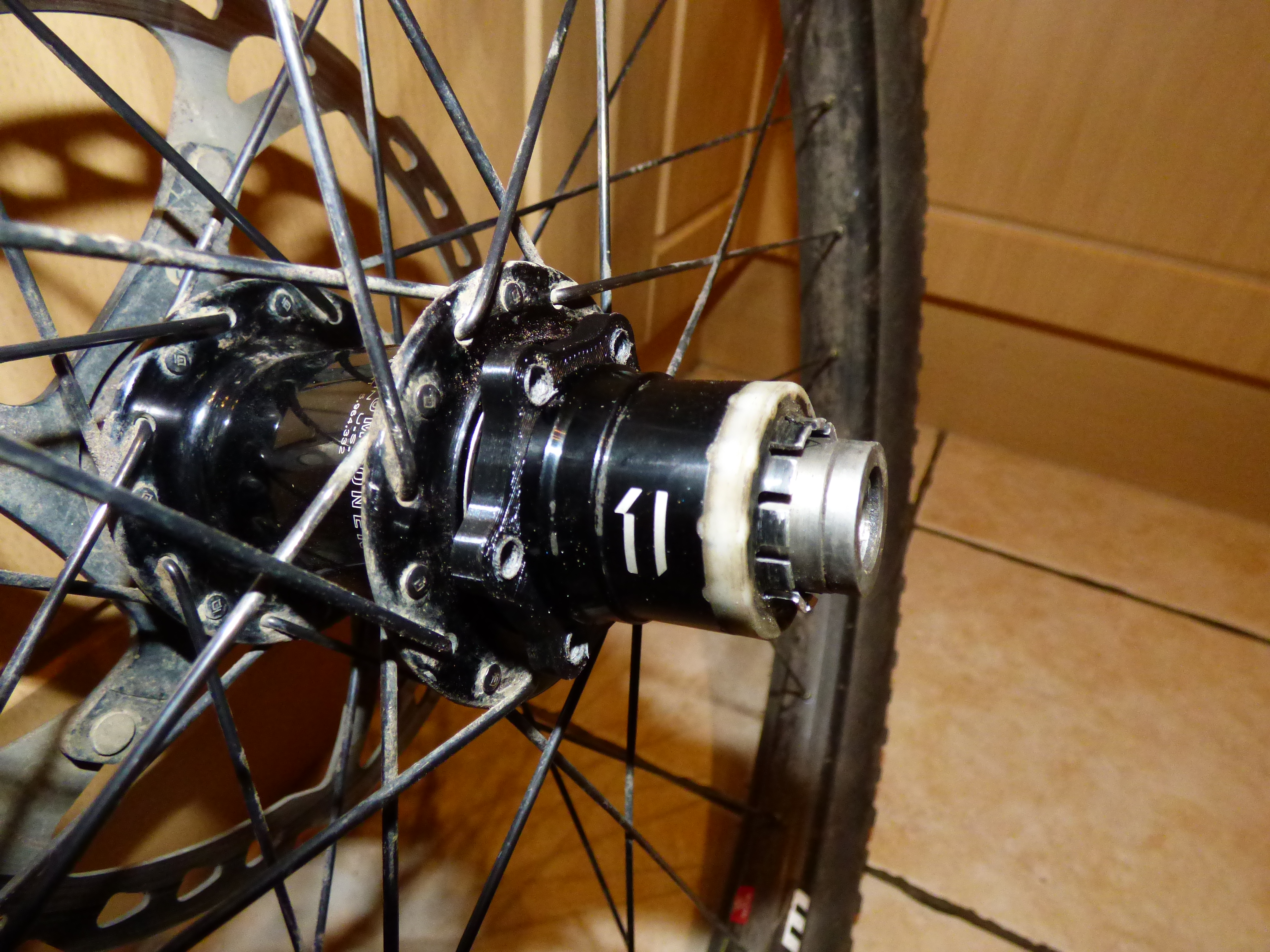

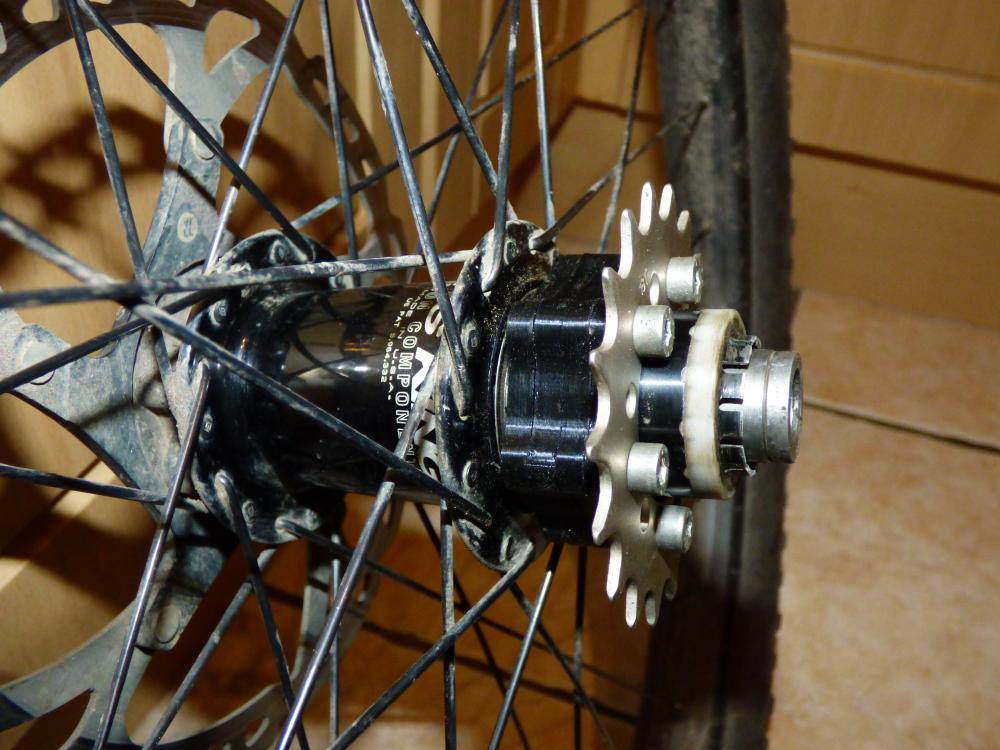

  19. Here we go! 3D printed test run. I bought a knackered XD cassette on eBay and whipped the lockring out of it (a bit more dremelling required than I anticipated but got there in the end). One 5mm thick HG spline spacer that the lockring clamps on plus three 5mm spacers with relevant sized bores gives the correct chainline and we're looking good. Will get the bits waterjet cut at the start of this week hopefully and get it together properly soon .
