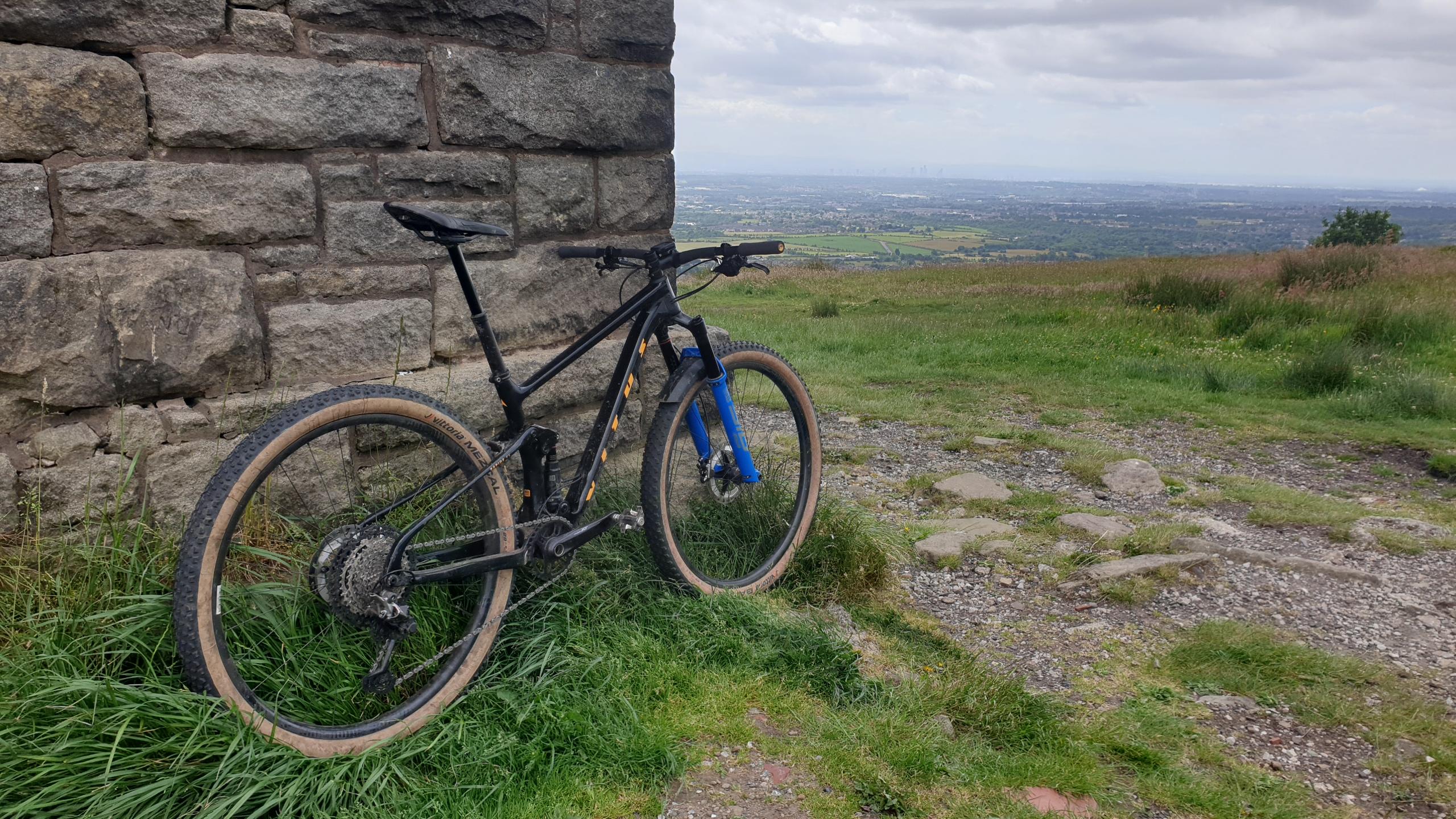

Did you try to add photo there Tom? Or just belatedly very happy for Luke? I've recently gone full XC whippet, bought lycra and everything. This bike is seriously easy to ride very fast. Technology: who knew?
