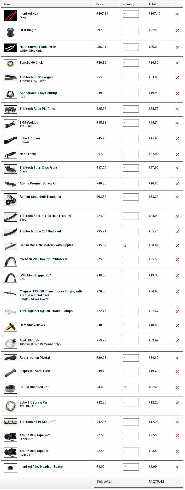

BOOM! haha it might be kinda off but gives you a rough idea of what you could build, remember that if your spending that much at once you can speak to tarty about the price!

I would say that build is a lot better than the standard £1200 Inspired 26" build.
