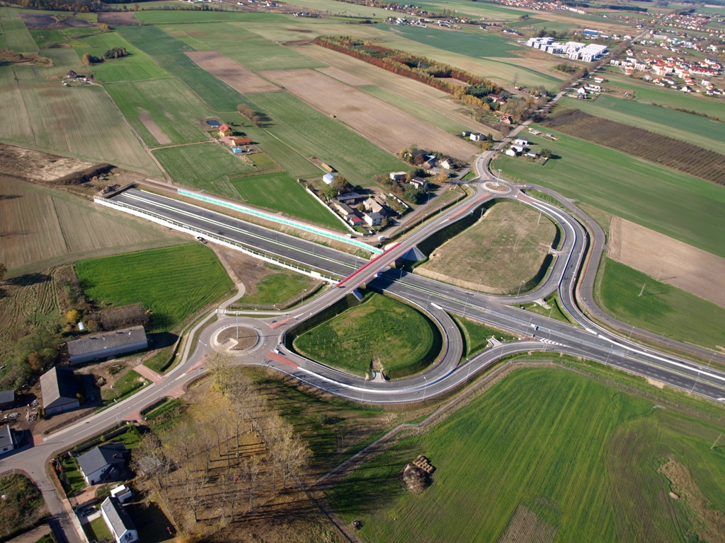

I drove along a new bit of the ring road today wondering why there wasn't any traffic. This is why:
It just erm... ends. The other part of the ring road also ends in a similar fashion, they can't afford to connect it up. I love this country, it's so silly. And the fact that it looks like a huge penis just makes it better:
