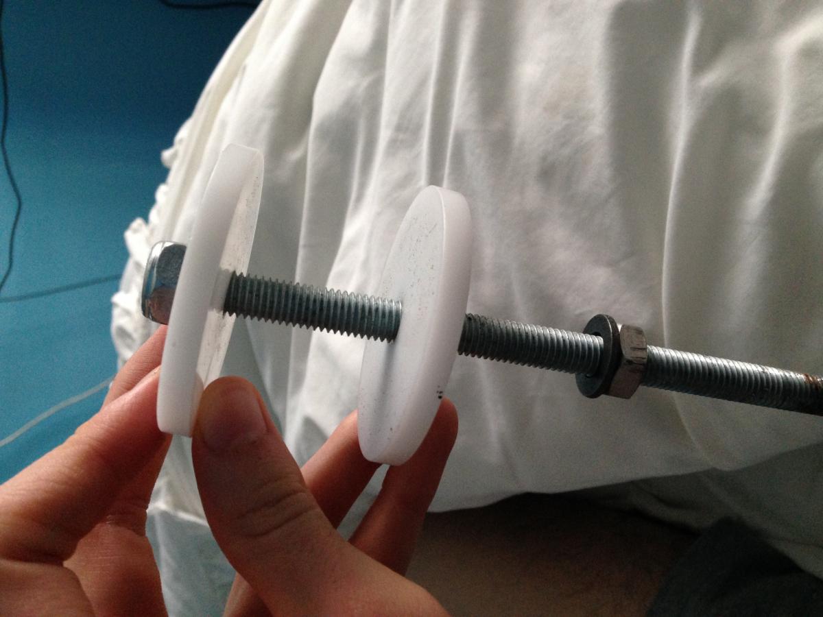

I have this one, because I couldn't be bothered to get all the bits. Worked perfectly the two times I've needed it, although obviously not workshop quality! Uses 50mm, so seems like if you're going to make it yourself that should do it.
Did that weird astroturf stuff on the faces of the plates wear off as quickly as I imagine it would?
It hasn't on mine, but I've only used it twice so it hasn't had much chance. I'll be stripping both bikes and making them all nice and tight this weekend because they've been neglected, so maybe it'll rip off then :) nothing a bit of non slip material wouldn't sort.

I would have just gone with a stack of progressively bigger washers, from the nuts and bolts container any man should have :P Doesn't matter what size the hole is then as long as they cant fit through each other..!
  • Like 2
That's what I did on my diy headset press, it works like a charm and I didn't spend a penny... ;p
My press consists of 2 pieces of 50x50x10mm flat plate, with a 12mm hole drilled in the middle, and a piece of m12 threaded bar with a nut welded to one end. Made by a fitter from work. Works a treat
