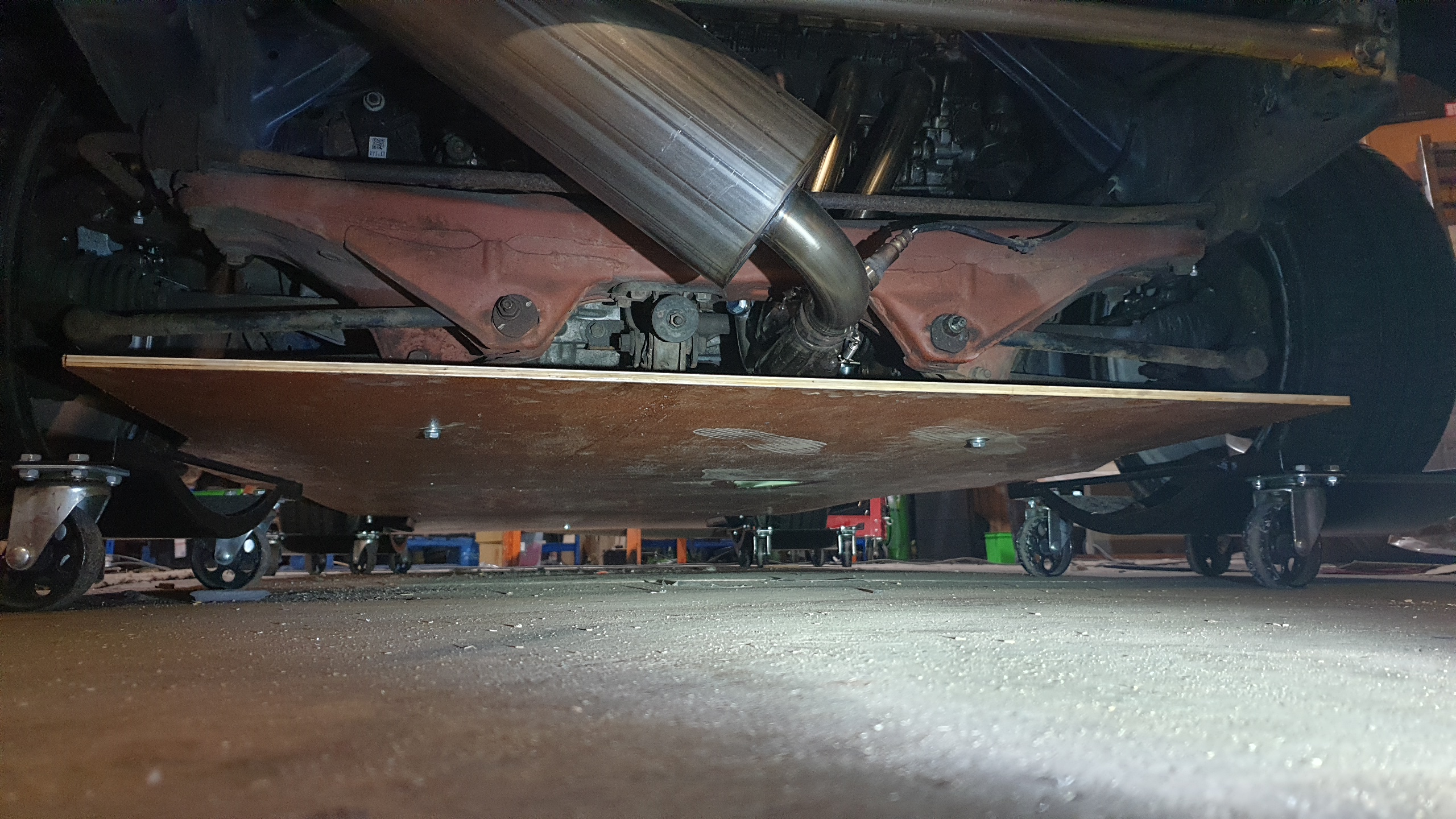

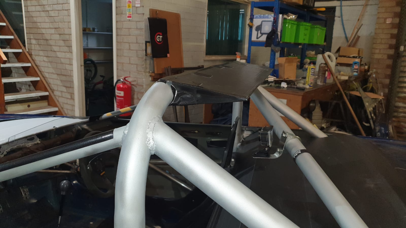

Well, the aerofoil thing flapped about like buggery so I ripped it off, and the steering wheel nearly fell off, but other than that... The aero works - surprisingly well. The car has natural understeer at low speeds (really obvious on the sighting laps), yet wants to swap ends at high speeds. It's also pretty fast in a straight line. It also appears my engine is a 2 stroke, as it burns oil and fuel in a 1:40 ratio. But who cares, it's a lot of fun! Upgrades planned: Mainly working the rear floor to sort the high speed balance. Found a great article (which I am guessing you had a hand in Dave? @monkeyseemonkeydo ) to help figure out the relevant geometries for a functional diffuser: https://www.racetechmag.com/2017/08/willem-toet-explains-motorsport-diffusers/ Obviously a car with marshmallow-like suspension is never going to have optimal aero, but if I can get the car balanced - even by reducing front downforce / adding some lift back in - that'll do nicely.

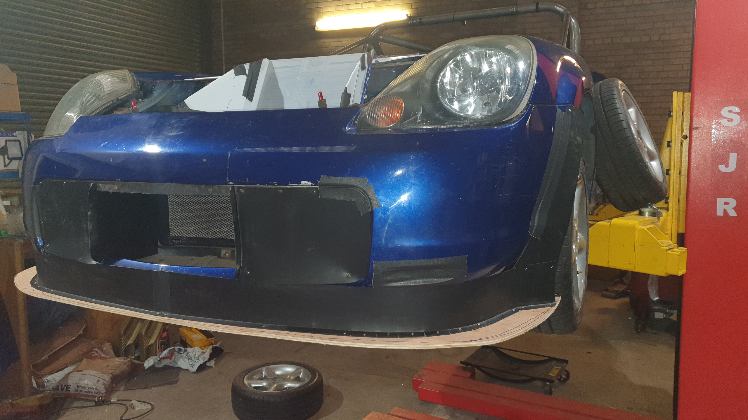

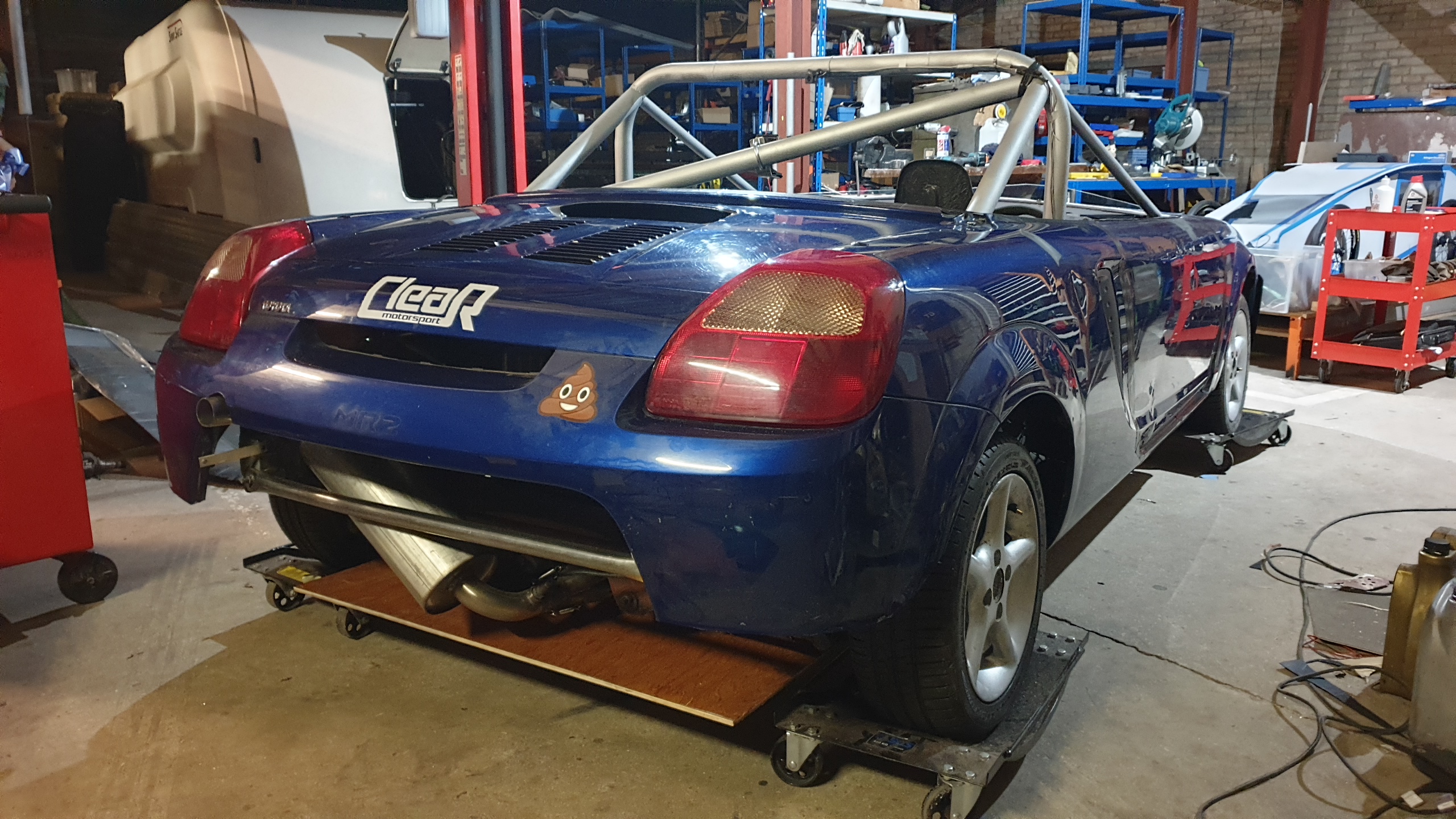

And some stupid aero bits from this morning... By my reckoning, just this will be enough to improve the top speed of the car by 3mph!

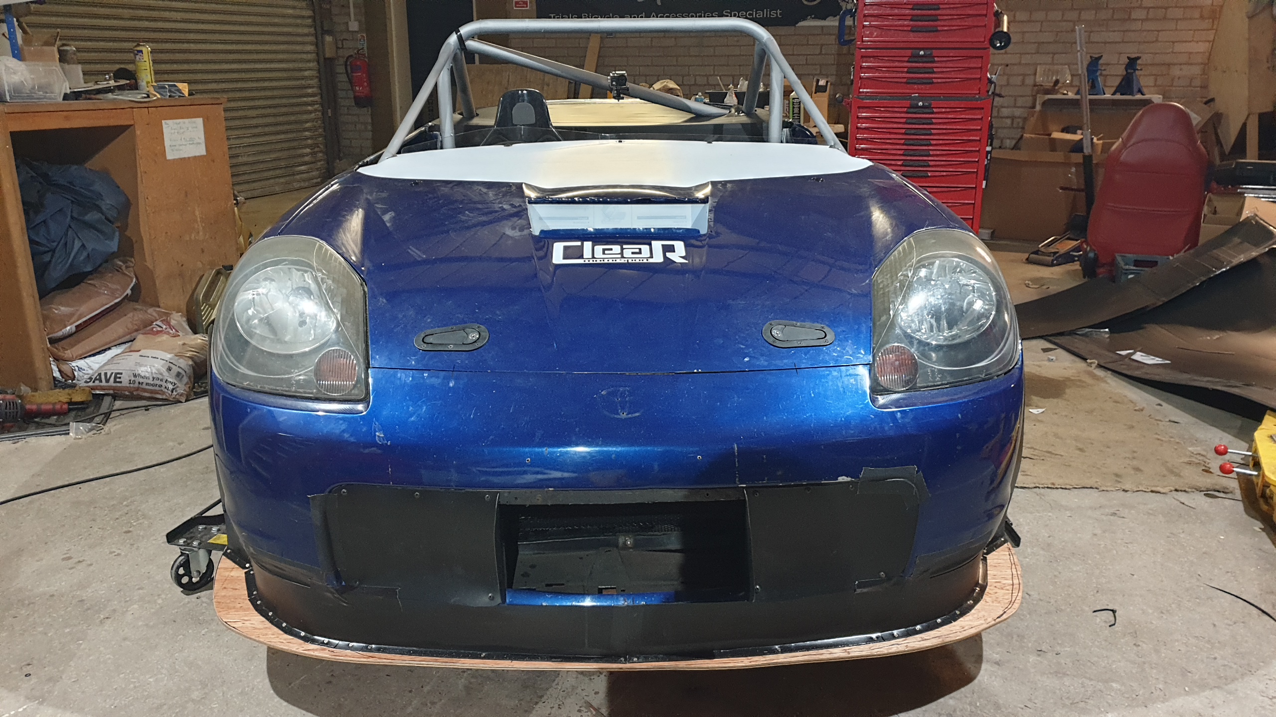

Papers in the post Seriously though thanks for the heads up and link to that article, some good stuff on Speedhunters. I've not looked there before as I've not been bothered with making the car look like it crashed through a branch of Halfords, but will do going forward. The car is actually pretty much ready for the first outing now which is Saturday all being well, and I did vent out the bonnet just not as extreme as some solutions! The rad is left as standard but ducted in and out, so I'm hoping that will reduce drag a fair chunk. A few pics... Now pretty much bang on 750kg, which will do me. Gut feel is that I'm going to need a rear wing to balance things out, but we'll see... Maybe I'll try and go full McLaren Elva sometime No wind in the face at 70mph, apparently!

I reckon you could make a good 5% improvement, perhaps at the expense of aesthetics though - have a look at EcoModders forum for ideas!

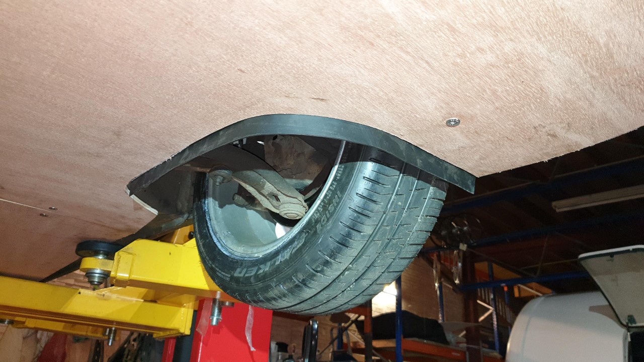

Found another paper that agrees with the one Dave posted above, not the same results exactly but a general significant decrease in drag from fitting the tabs / deflectors / whatever: http://publications.lib.chalmers.se/records/fulltext/250512/250512.pdf (page 18 onwards). Note this study uses seemingly less wide tabs, and only fitted to the front. I think I'll shoot for about 40mm, spanning the width of the tyres, fitted front and rear. That brings me to another question... the wheel arch pressure plots in the paper above, after adding the wheel tabs, seem to suggest the pressure above the wing is much higher than below it. In which case, would running vents at the top of the wing have the opposite effect and allow air to enter the wheel arch area? Or would louvres / Gurneys sort this out? Appreciate it is a case by case basis but just thinking out loud... Rowan, I've seen some stuff on enclosed wheels / solid hub caps in my link above, plus this vid below. In short it can help drag but at the expense of brake cooling:
