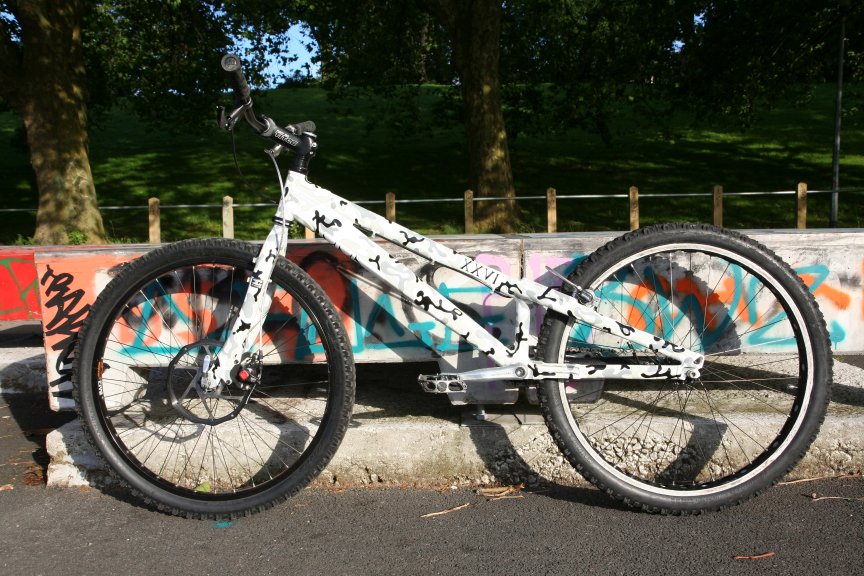

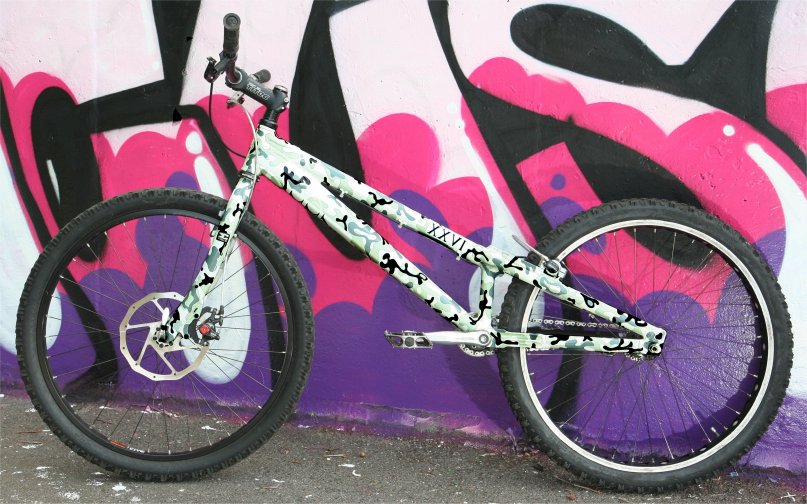

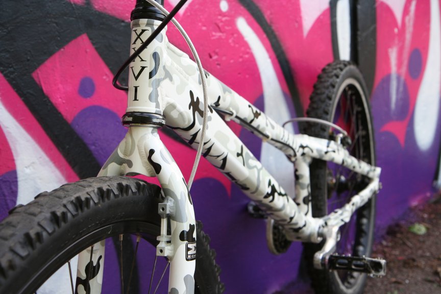

You already have the base coat so it s agood starting canvas. Theres only about 20 grams of colour on there plus the clear coat. Get into it!

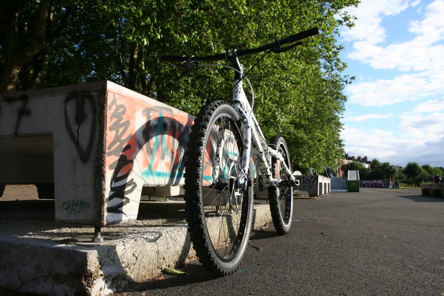

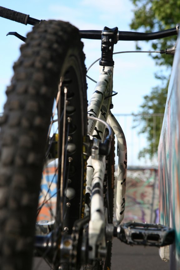

Yes well it is camouflage... I know what you mean. Cheers for all the comments guys, am glad to see the end of it to be honest. When I closed my eyes to go to bed each night all I had was an image of camo. It'll be scratched up pretty soon but i'm expecting that and it shouldn't show as badly as if it was one solid colour. XXVI is just 26, no other reason other than to break up the camo a bit (Monkey Boy I may be old but not TWICE that yet!) Pictures taken In Victoria Park over Knowle way. Not a bad park with a few different bits to ride as long you get on with cider drinking chavs 'sharing' the skate park. Yep, next to the railway lines. Updates from previous build are MOE BB and Middleburns. Braided crossover on rear and removed my booster/crossover protector.
White base coat was done with pressure pack. the camo was done by hand. I estimate about 20-25hrs of work. Comments welcome. Edit: Last picture added to try and show a bit of contrast.
