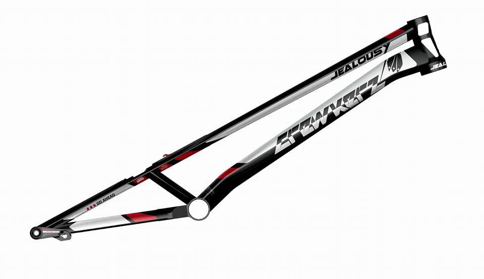

Dear All,
The new Crewkerz Jealousy 26'' will be available in some weeks, here the first view :
http://www.facebook.com/crewkerz/photos/a.685190994901662.1073741830.239827509438015/866308793456547/?type=1&theater
3 sizes (S, M & L).
through axles, AS30, Tensioner, Tapered,...
More informations coming soon.
We are ready to hear your point of view (positive or negative)
regards
Christian
post-32097-0-27583300-1438008348_thumb.j
My first impression is that looks smart as f**k. I've always appreciated atomz and crewkerz stuff for it's apparent quality and unconventional ideas. Not conforming to a norm is always a bold move, especially so in a small world like biketrial.
Quick question though...
AS30 is the BB standard where the bearings a press fitted into the frame like an echo, but using much larger dia. bearings, in conjunction with an axle that comes out like a BMX 3 piece / hollowtech style (instead of being fixed in by the bearings like the Echo/Zoo! system), is that all correct?
Instead of BB30 which has tapered cups in frame, and resembles an internal headset turned sideways?
Edited by CC12345678910

Ah ok. So I had some of the details right, on some parts I was horribly wrong though!
Again that crank system looks really smart and beefy.
Is there a way that some sort of spline to thread adapter could be made for these cranks, to allow the use of a screw on sprocket?
As it is, If I was in the market for a new frame, this would be the dealbreaker, since I would have to give up using a Pro2, and I would actively avoid anything that would force me into using a freewheel.

We use shimano splines on these AS30 crankset. You can use Hope rearhub with thruaxle and splined (Shimano splines) sprocket instead the Freewheel on the crankset.
The last year, Jack Carthy used this combinaison.

Do you think that might have something to do with you only mentioning the name and graphics of the frame for the past week, and not giving any other details? You've been highlighting the fact it's called "Jealousy", coming up with hashtags for it and so on, but you haven't given the geo or any other information for it so what do you expect?
If you just post a drawing of a frame with the name and graphics, people are going to talk about the name and graphics. They're not going to talk about geometry they don't know, etc...
