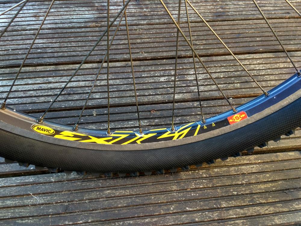

What have we here then? Looks like a set of (2.2"/2.4") Mountain Kings
Well these are a little bigger than the Arcade wheels. Hope QR skewer needs to go.
Not a common rimset these days
Classic...

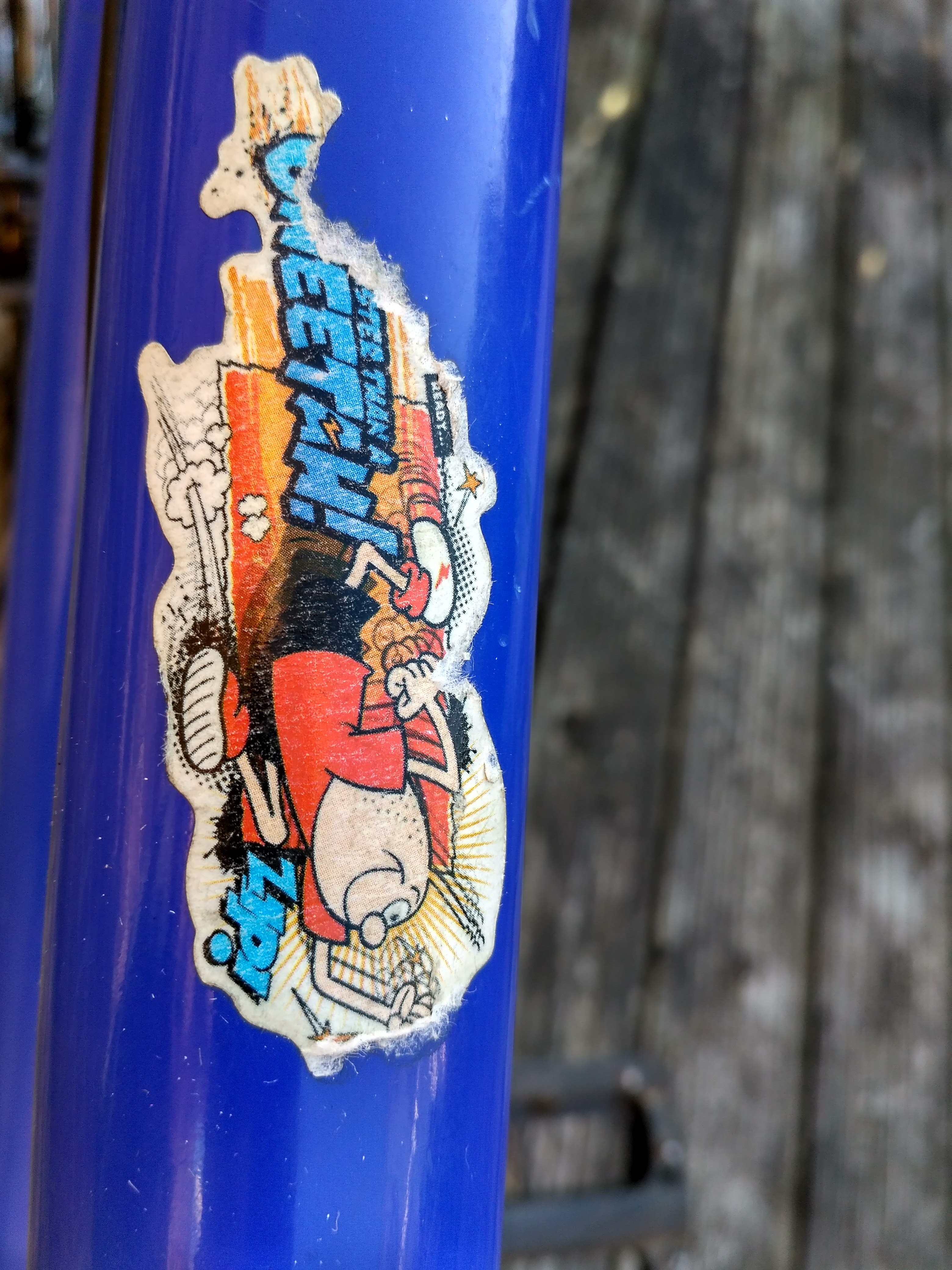

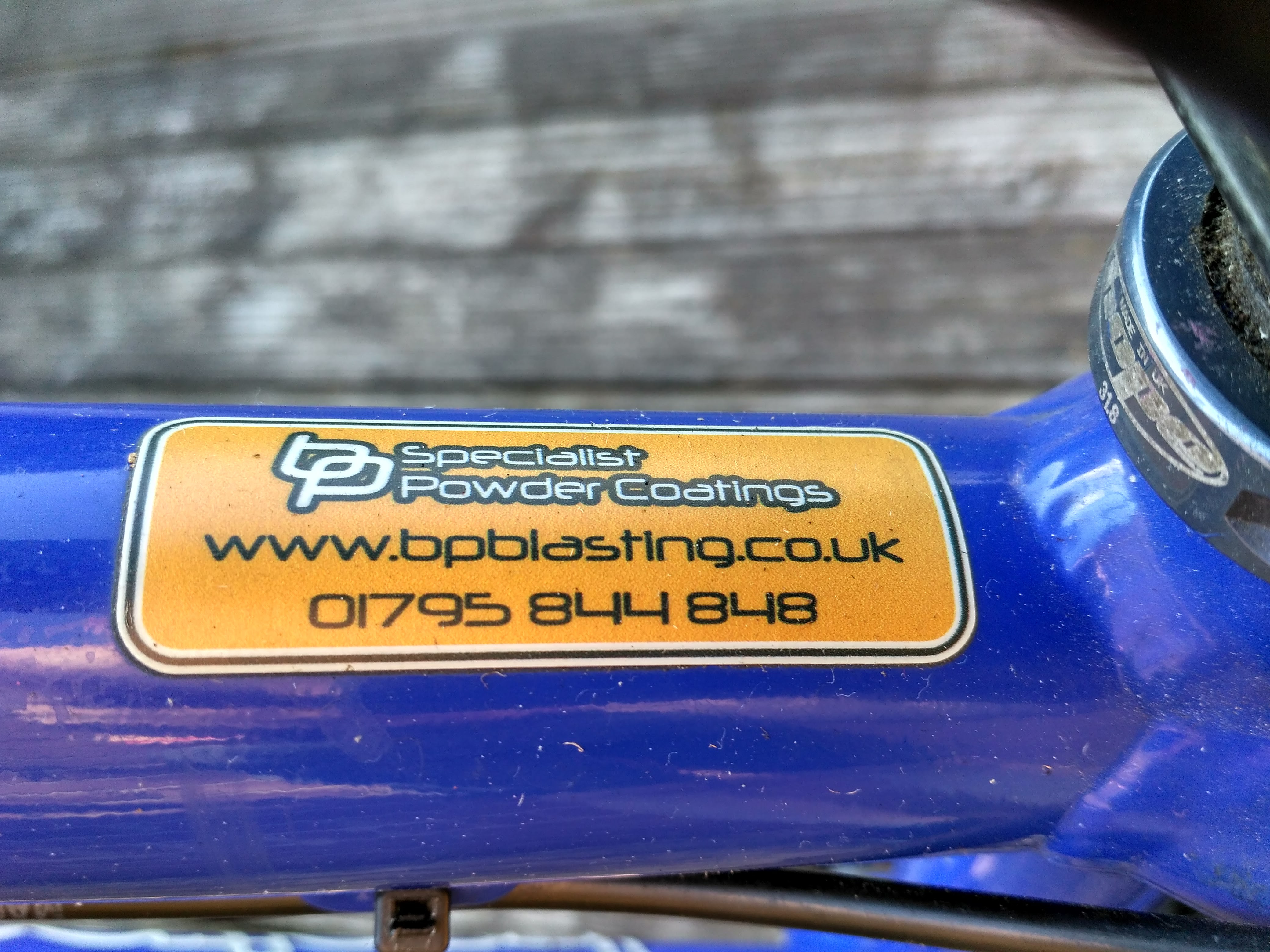

Pulled out the rest of the box's contents. Not too sure on the stickers but that's an easy fix. These guys have done a thorough job of the coating, though it's taken a bit of abuse so if I end up hanging on to it perhaps I'll give it a fresh coat

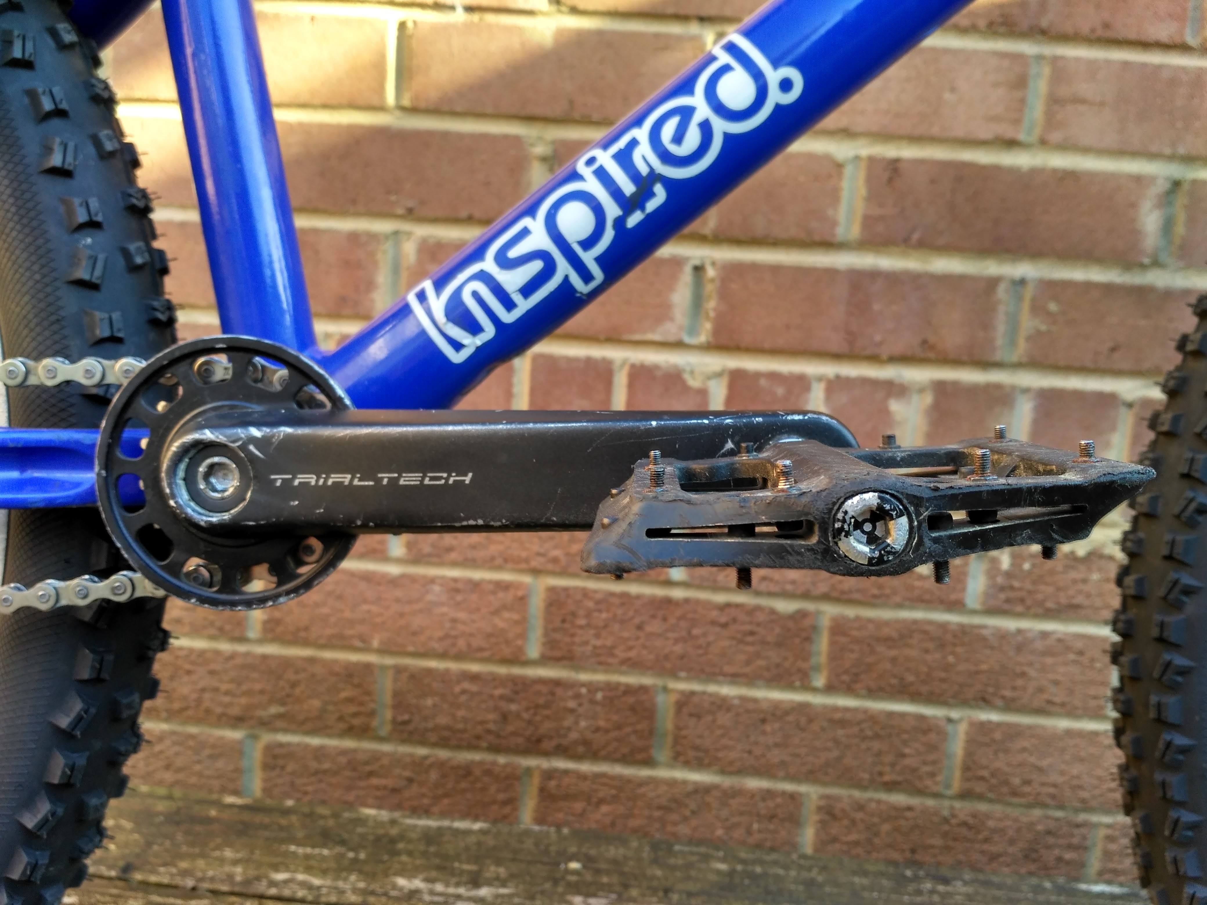

TT crankset, 16t, plastic Nukeproof pedals. Gratuitous downtube dent.

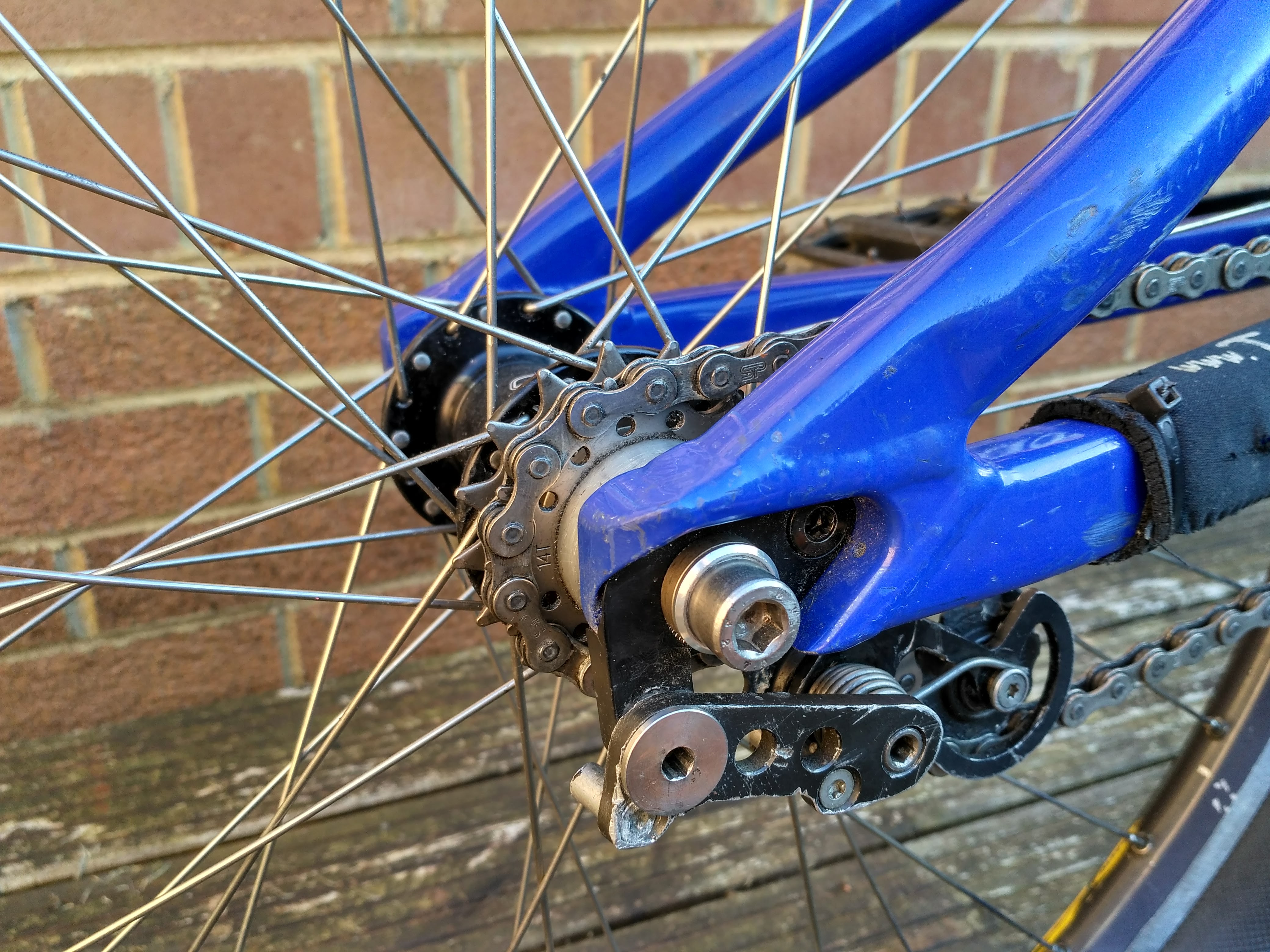

Rear end's a Pro II, Rohloff and (narrow) 14/(wider) 16t sprockets. Will rectify that at some point.

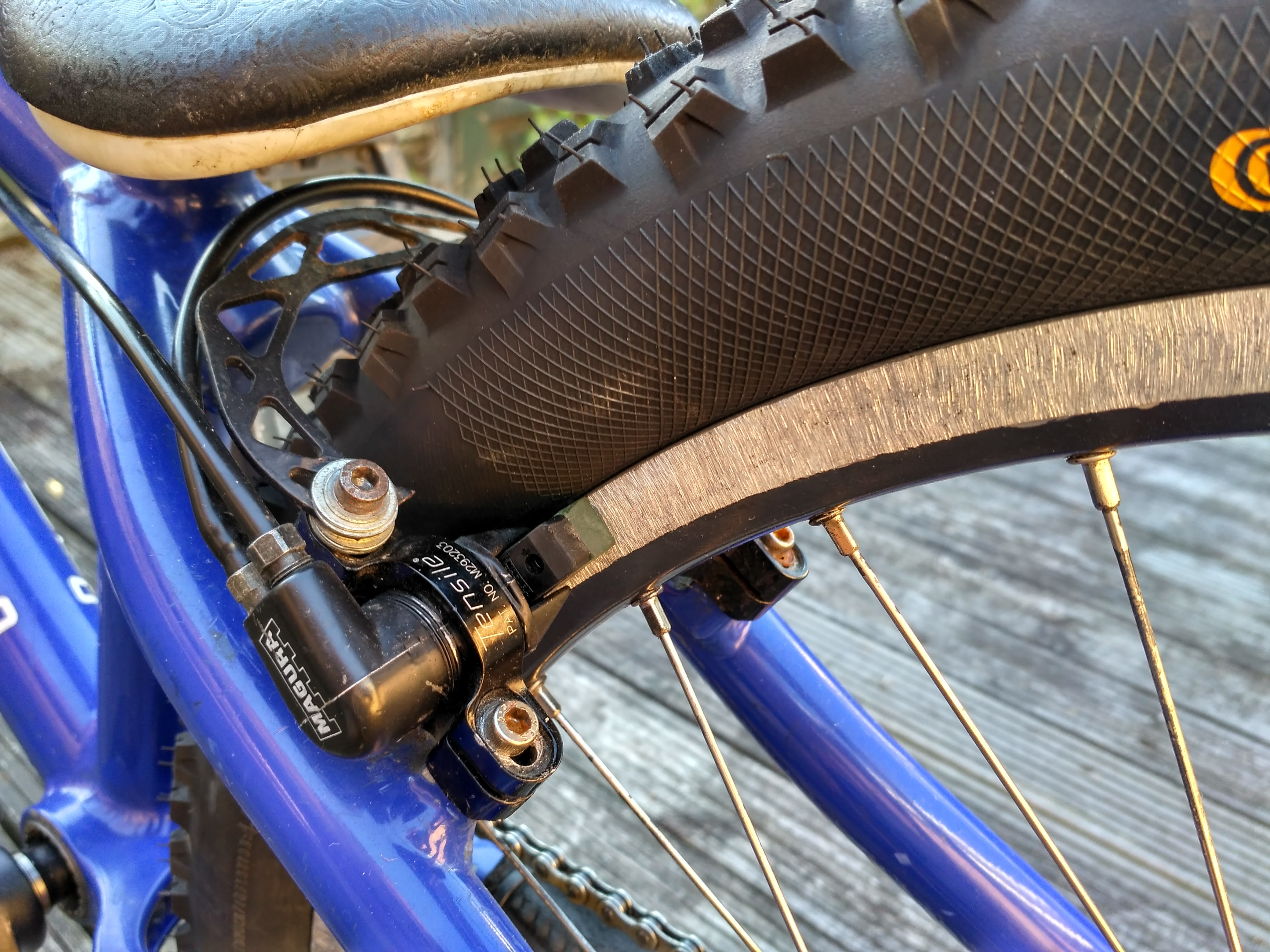

Rear brake is an '05 HS33 on (real) Cousts, old school booster and Tensile offset mounts. Harshest grind I've ever owned, though still significantly less abrasive than most folk seem to run.

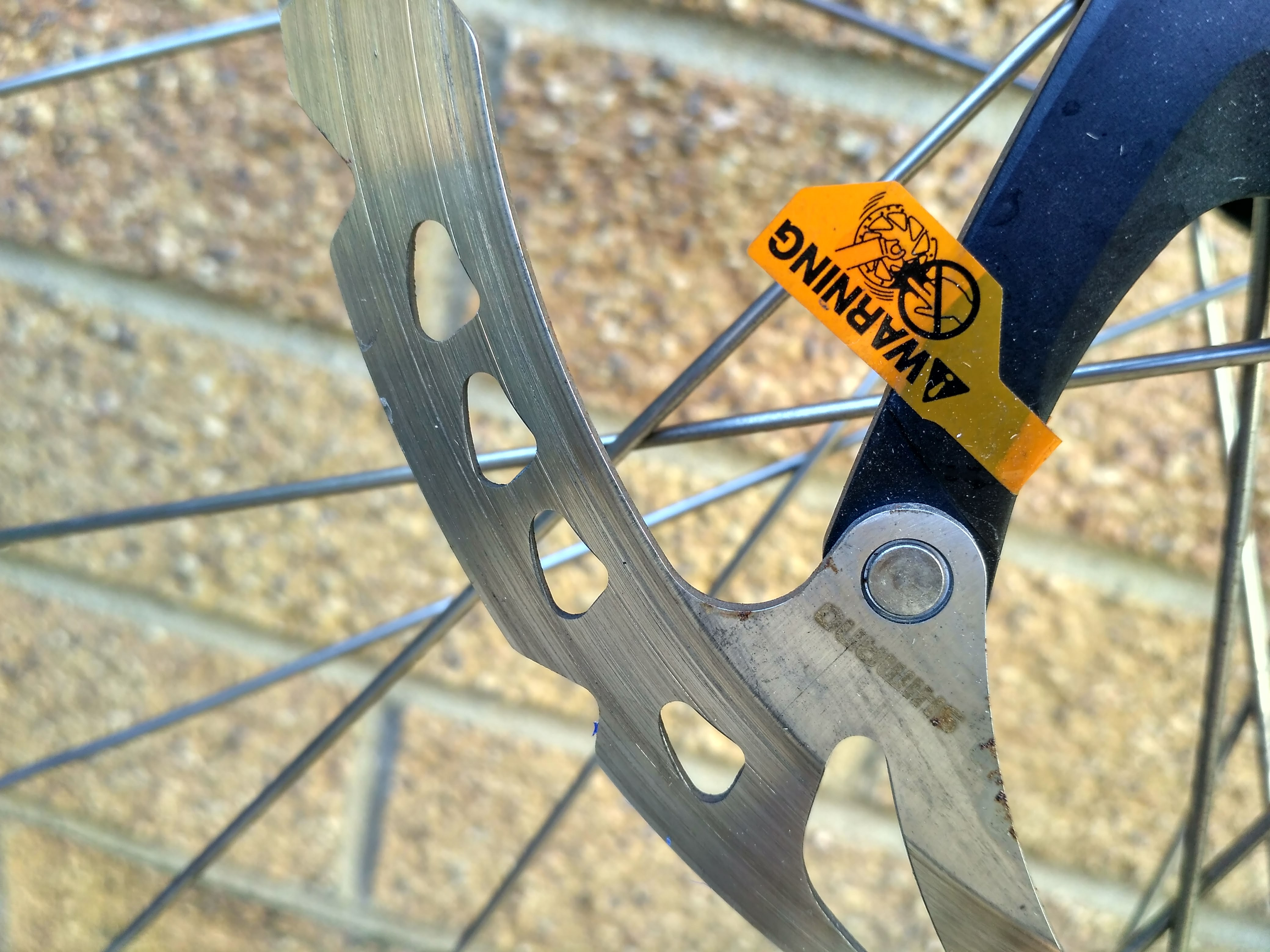

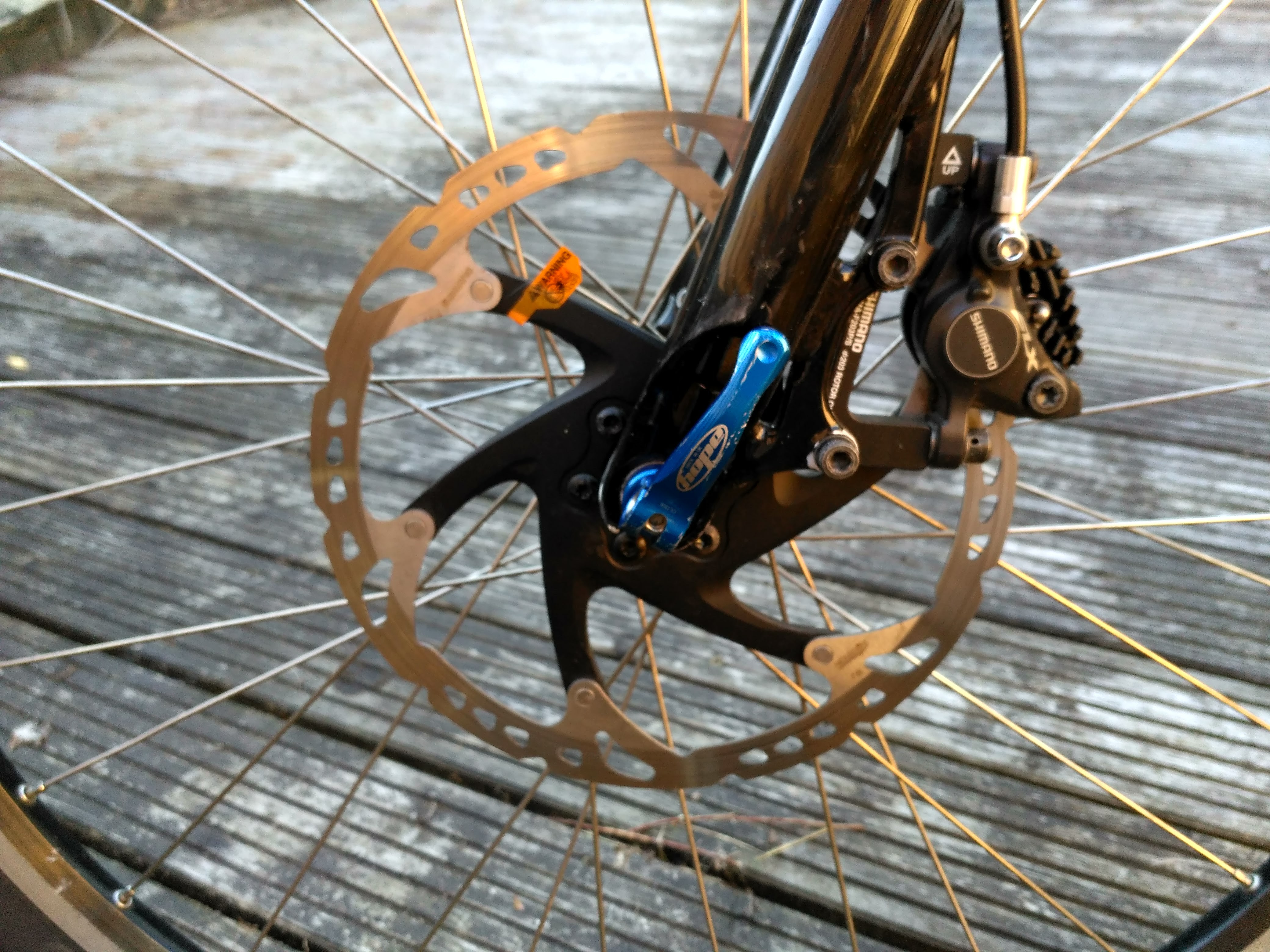

Front brake is an SLX. 203mm is nice to see, but this might get swapped out for something a little more suitable.

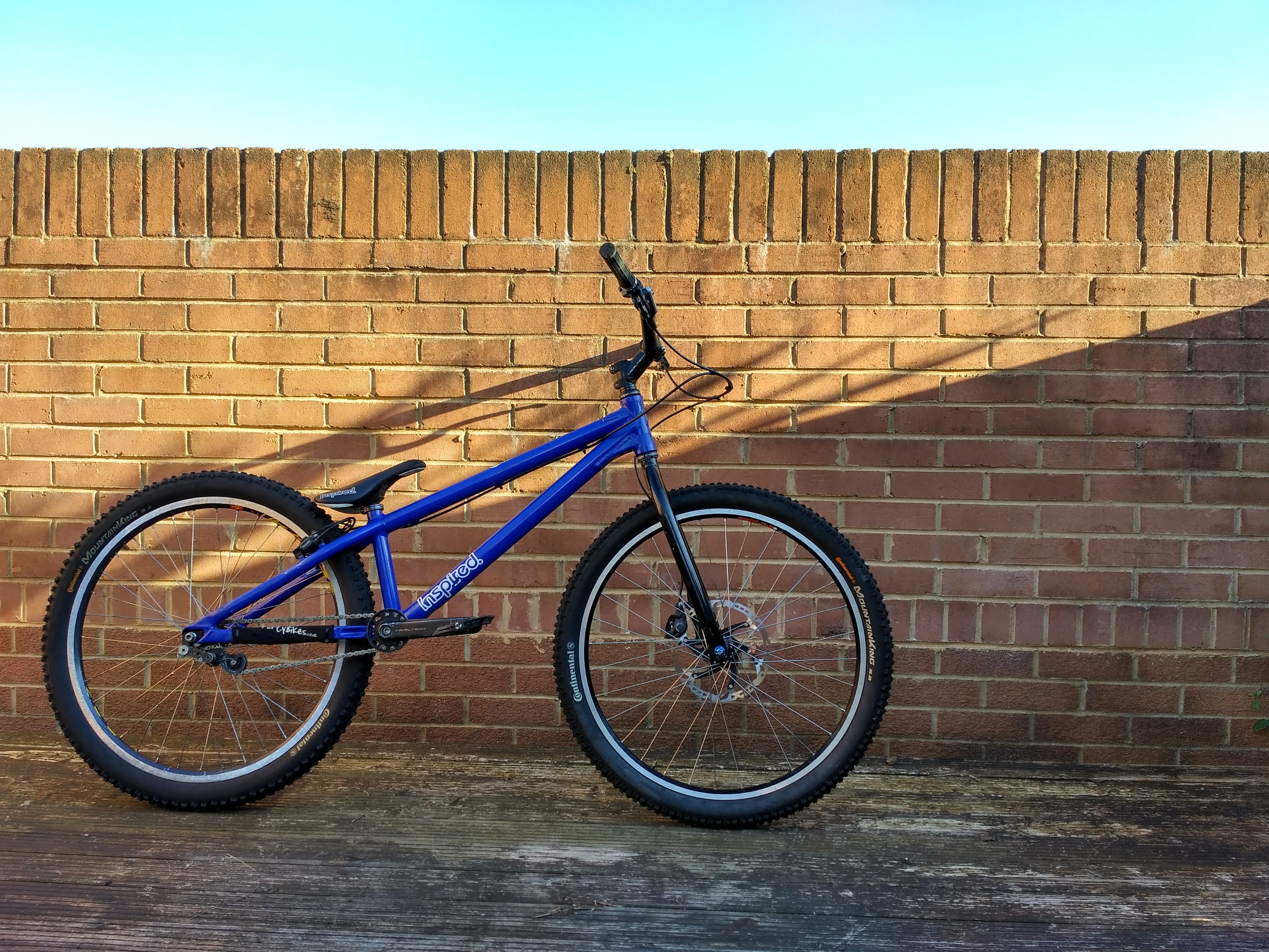

And for anyone who's not quite pieced it together yet
Had a very quick roll about on the decking at home. Brakes need to bed back in and need to sort out the gearing, but the bike feels far more capable than I do so that's good.

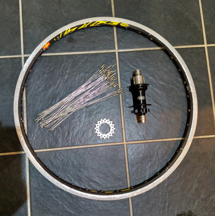

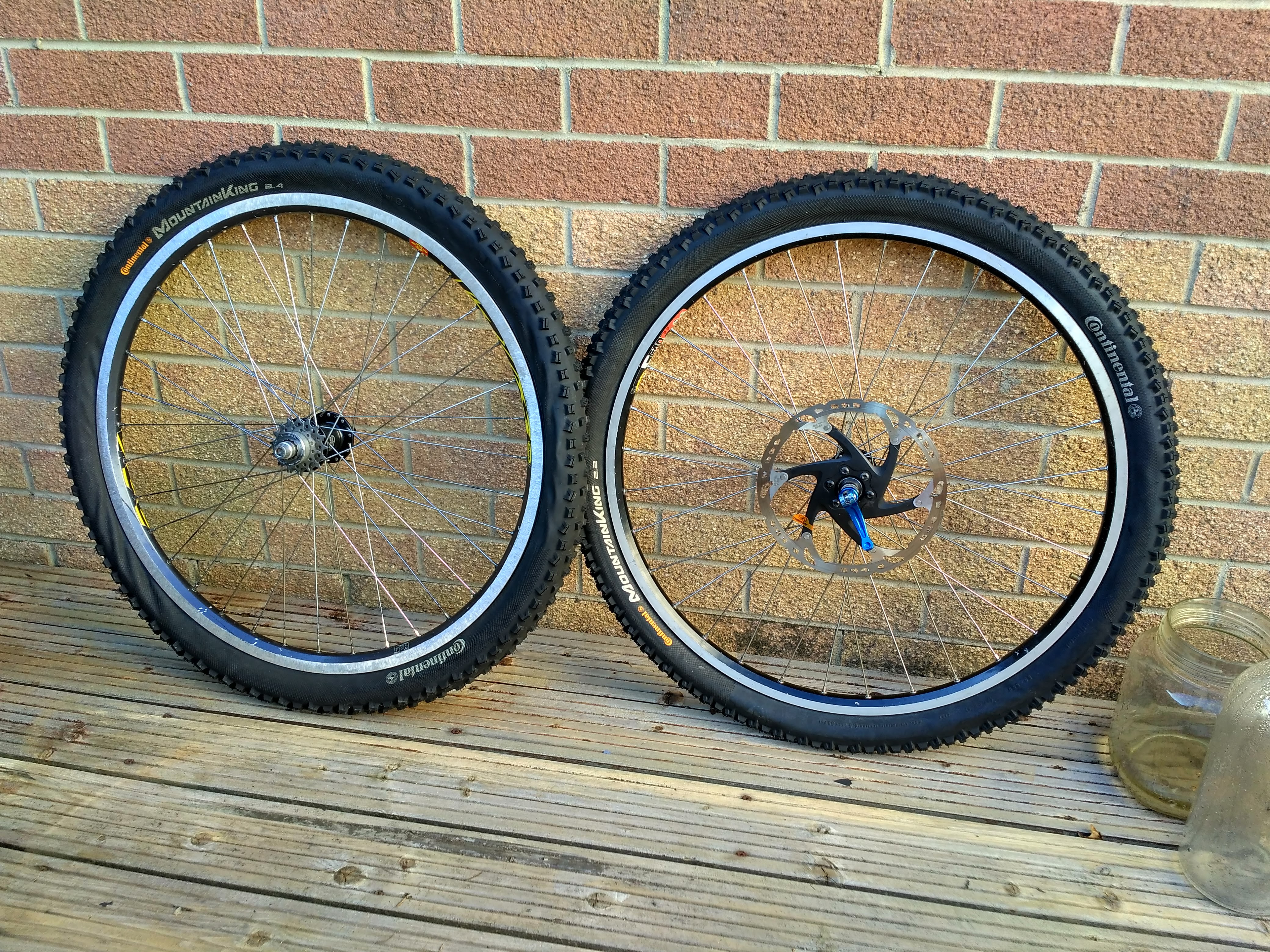

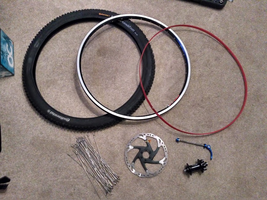

New rear rim and front spokes inbound at present, so I've stripped down the existing wheels and cleaned up the hubs ready to rebuild.

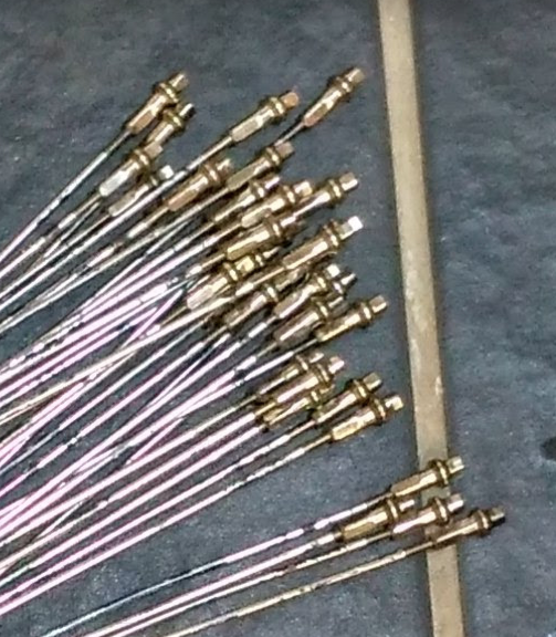

Nips were a little different to any I've seen before. Had the same square profile above the flange of the nipple as below. Not that you can get a spoke key in there on a double walled rim anyway.
Whoever had built these wheels up had used a lot of nasty red (permanent) threadlock. Can't say I'm a fan of that idea, and certainly won't be doing the same this week when building up the new rims.
Also, turns out the previous owner had actually been running 16:16/16:14, but with a narrow 14t sprocket so I'll throw on a chainring and an extra spacer to put that right. 20:16 should do the trick, or maybe 19:16 for hoppier stuff - minor difference. Probably just go with whatever I can find cheap so if anyone's got a spare screw on 19 or 20t sprocket let me know!
As a result of incorrect spokes, I only currently have half a wheel's worth I can lace up so I now have half a front wheel stuck together.

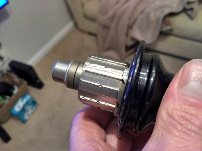

Also gave the freehub body a quick buzz with a file as the previous owner had been running a narrow sprocket which had dug in. There were actually a number of marks as you can see here, so either the cog had been moved about a bit or, perhaps more likely given the regular spacing, there'd been a narrow cassette on here at some point.

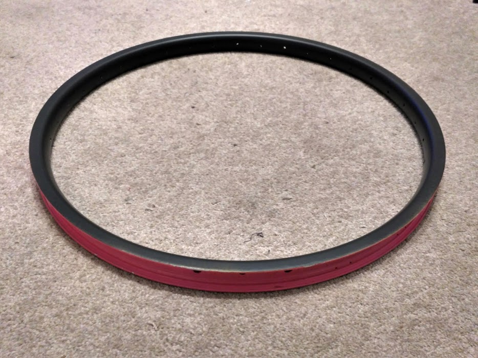

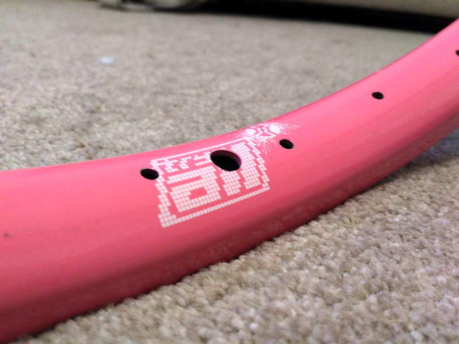

Rear rim arrived. It's a 36mm wide, undrilled TryAll. I don't really remember these from yesteryear and can't find much mention of them online either, which is a tad strange but should suit the Hex pretty well. Was in two minds as to drilling these rims but can't be fecked.
Unsurprisingly, I am introducing it to this:

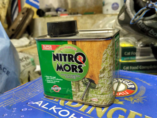

Perhaps less surprising still is the fact that "New and improved", "faster", "super strength" new formula Nitromors is just as shit as I remember and doesn't appear to be touching the sides... :P
Edit: I roughed everything up with coarse sandpaper prior to applying Nitro. Have now wiped off and given it a buzz with a flap wheel, see if that helps.
  • Like 1
If it hadn't been sat on the shelf already I wouldn't have considered it. We also found some old Wilko own-brand stuff in the garage when we moved in 3 years ago, consistency of water, which I tried. It was more effective...
If I need to buy anything I'll get Starchem, or take up TB's generous offer of sharing his fluids (Y)
Didn't grab many photos, but I was an impatient f**k and just stripped the paint from the rim with a grinder :lol:
Have since smoothed it out, filler primed it, and given it an acceptable coat of matte black which matches the DV fairly well which is cool. Interior left pink for laziness reasons. Both wheels now fully built - need to give them a quick tweak in the bike to ensure they're running straight (they're close by eye, but I've not used a stand or anything so they'll need a minor touch to be rear-brake-suitable I'm sure.

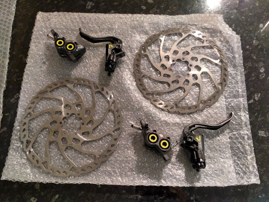

Brakes I bought arrived - managed to pick up a set of MT7s for less than a single new MT5. Only minor issues being they don't have hoses, and being an older frame I can't run one in the rear which would have been nice. May chuck a vee on the rear, not sure. Current plan is to hang on to the spare MT7 and perhaps run them on the MTB down the line, but we'll see. may end up selling one once I've got them both sorted. Oh, and a set of 203mm rotors too. Nice.

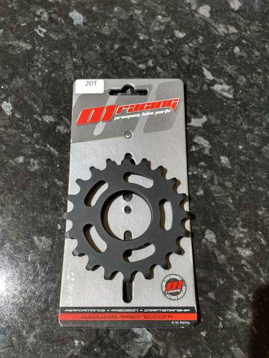

Oh yeah, chainring turned up too. Going to give 20:16 a whirl, see how it feels then if it's a touch too high throw on either a 19t front or 17t rear to fine tune (Y)

Brake lines appear to be cut at the caliper but unscrewed at the lever, and I only have what's in the photo. New hoses inbound so easy to sort either way :)
