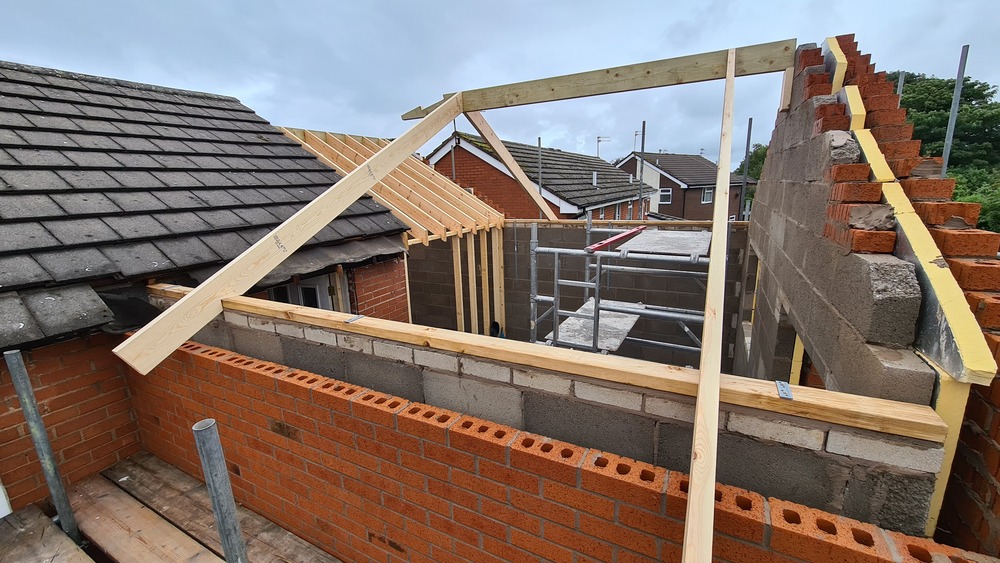

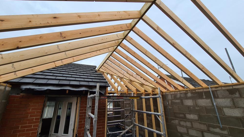

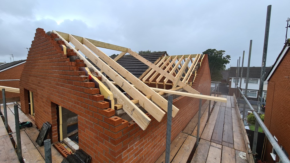

I'm pre empting building a big man shed at the top of the new houses garden so been trialling making the roof trying to get my head around measurements and bird mouths cuts etc. Finally got it the other day. Got to try out my new tool imported from the land of the free.
10 hours ago, isitafox said:
I hate doing them, especially when you've got to do two or three in the same rafter.
Always mess at least one up every time, doesn't help doing it on a 100yr old farm roof built from allsorts though! :lol:
Sounds like a pita!
What I struggled with was determining where the birds mouth should be. When doing the basic pythag and working out the hypotenuse of the triangle, then transitioning that measurement to the location on the actual birds mouth. It's hard to explain without going into loads of detail. Got it in the end though
  • Like 1
Sounds like something CAD would really help with. A couple of angles and a few dimensions would, I imagine, give you the answer you need for any conditions.
  • Like 1
I've done bits and bobs on roofs in my time but this was the first substantial one I've ever done. It went a lot smoother than I thought it would.
If you're putting measurements into cad i think you'll struggle. Every piece of wood is different and nothing is straight. You've just got to do the best you can.
I did everything myself with help from my dad and his mate passing things and holding things etc. Made a few mistakes and got a few things wrong but it works. It's water proof and hasn't blew off in the winds we've had recently so I'm happy with that.
  • Like 6
Ah fair enough. I was just looking at the practise example Dann showed and reckoned CAD would make that easy but looking at your pics I can see it wouldn't be that easy!

Oh yeah of course. To get the theory of it cad might help. In the real world you need to make adjustments and sacrifice.

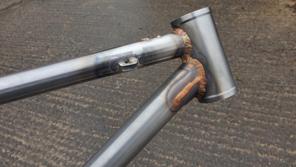

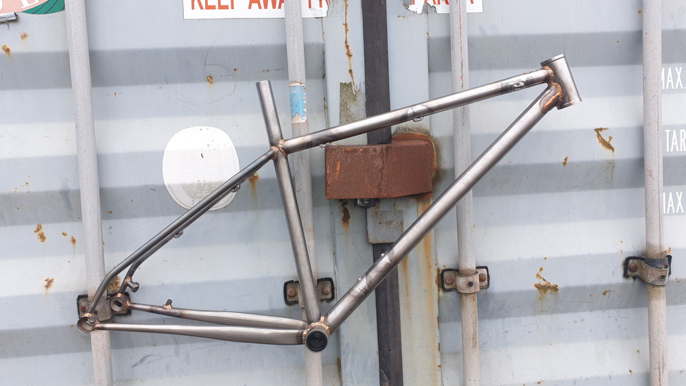

Frame is done and ready for a coat of boiled linseed oil :D

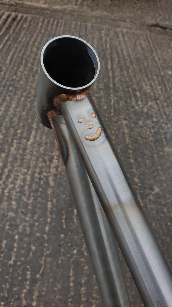

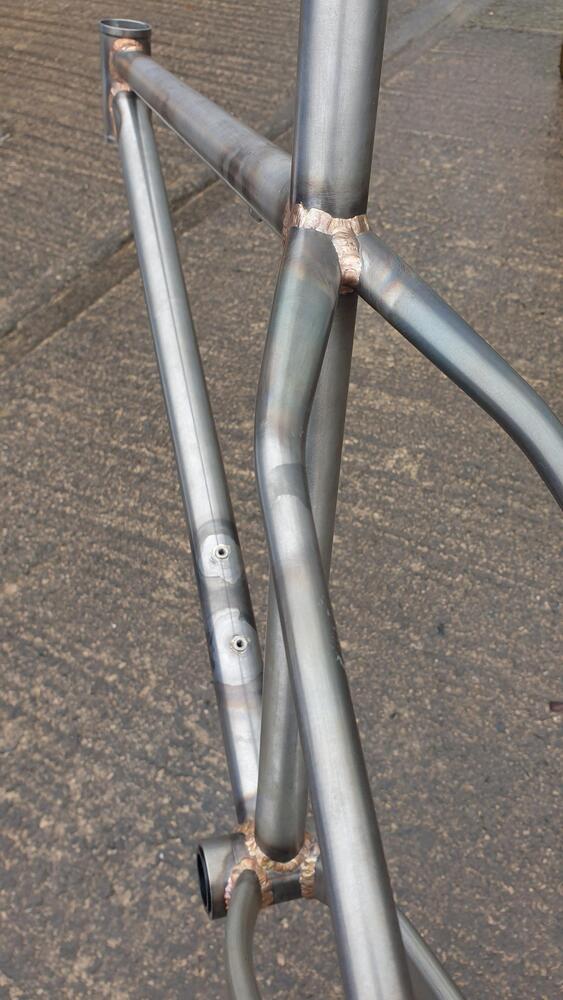

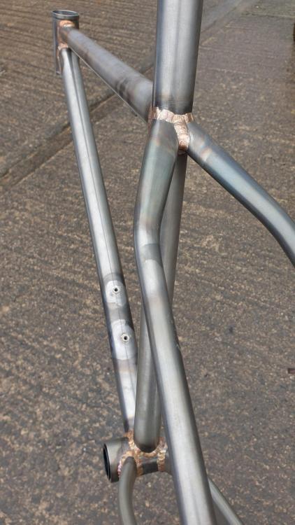

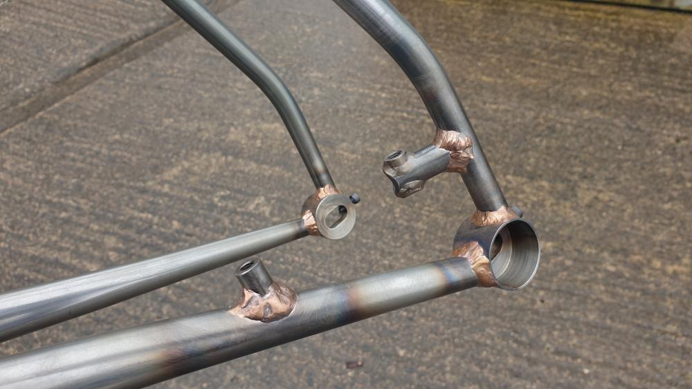

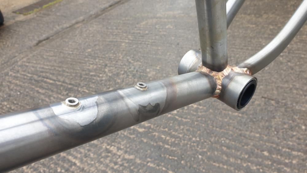

I love the colours and imperfections - they could all be buffed out, but they all tell a story. The bosses / mounts are brazed on with silver. Ended up just under 2kg too. Can't wait to ride it!

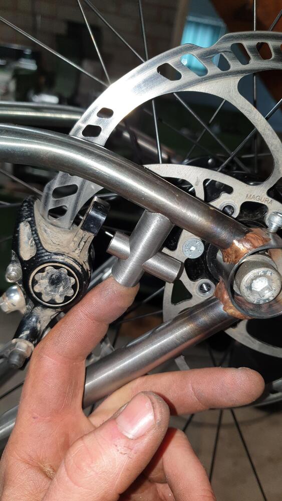

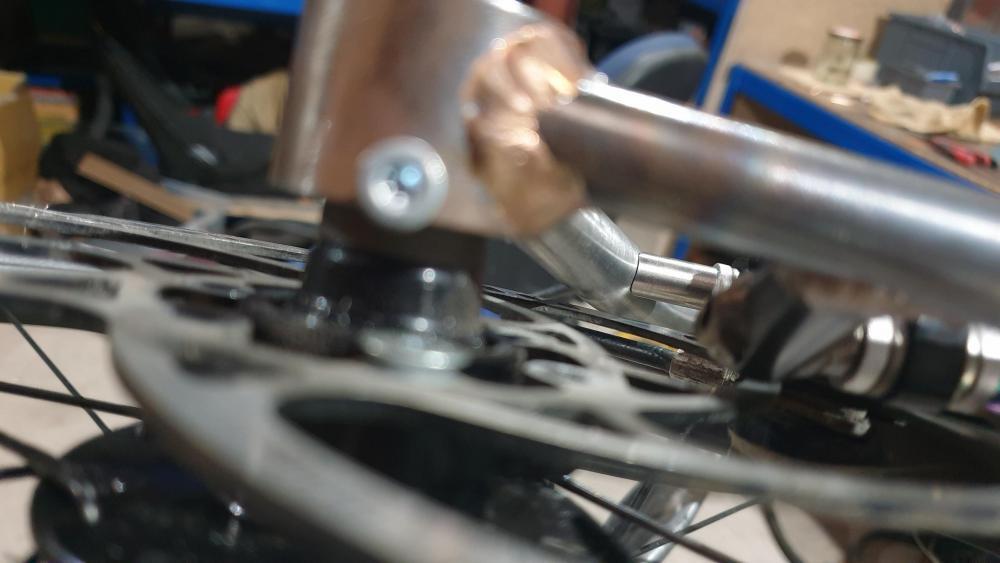

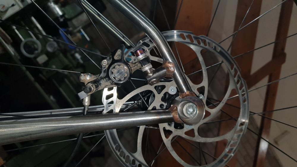

Curious about the rear mount though. Will being mounted like that not introduce marginally more flex than if it was mounted... I don't know the word... "Circumferencially"?
It looks like it will be pushing downwards on the end of a lever, rather than pushing downwards directly into a post.
Looks an awful lot nicer! And if there is flex, I'm willing to accept the quantity might be academic rather than a real issue.
My 20" frames with no seats or brake mounts were 2.4kg and 2.1kg.
<2kg... Butted tubing is awesome! :lol:
Edit: Are you doing any heat treating?

Have to admit the rear mount didn't really turn out as planned / was a slight afterthought. During the build I realised my skills with really tight joins were lacking, so the original idea I had / saw wasn't going to fly.

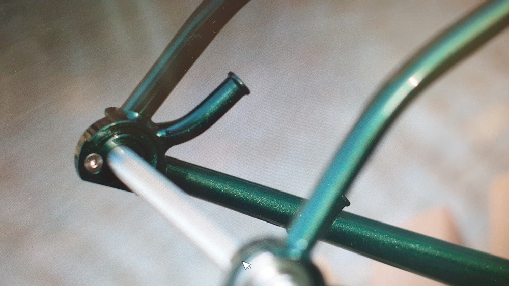

I also thought about using a front Hope RX4 caliper on the rear (which would have gone nicely flat along the chainstay) but bitched out of spending the cash :lol:
2020-hope-technology-rx4-flatmount-front
Due to where the caliper ends up, and most of the forces being 'forwards' (this will only see very mild amounts of trials), I figure the 'stand-off' is mostly in tension and the caliper itself becomes a stressed member / brace. Worst case, if it is all noodle-y, I can stick a proper brace in there.

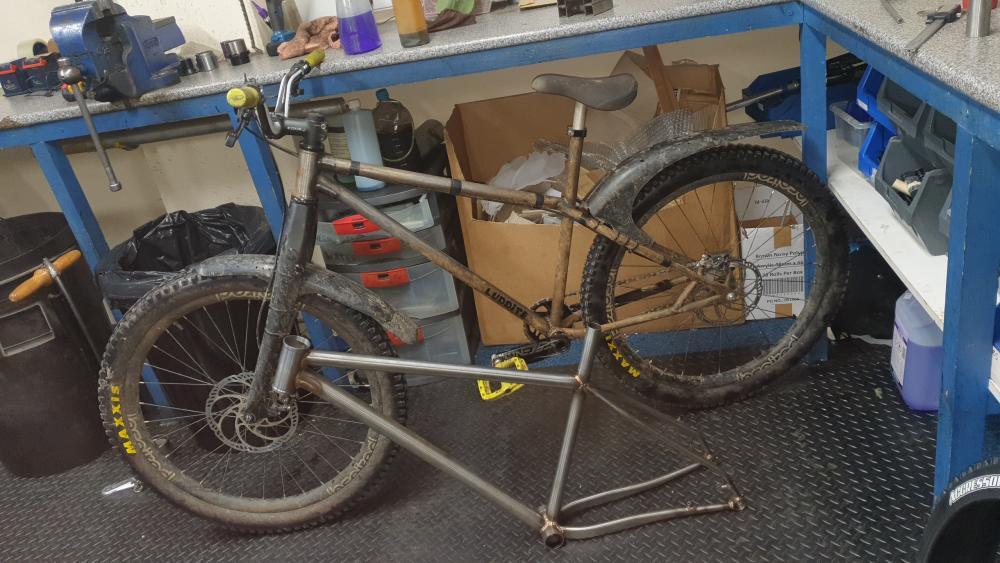

Haha, yeah butted tubing is a lot lighter! The last frame I did of similar design was nearly 3kg!
Heat treating - nah. In theory it would increase the strength of the frame by a significant chunk, but finding someone to do it will be tricky and from the joint testing it's already going to be a lot stronger than the last frame which has done ~ a year (albeit with 4 re-welds, ha).
It looks a lot more forces-reasonable with the caliper in place. Pulling away from the tube instead of flexing it downwards. Without it, I'd mis-imagined where it would all sit.
It's a shame heat-treatment is so inaccessible, but I guess it's forunate that steel isn't weak un-treated. Any thoughts on whether cracks at the edges of the fillets are any more or less likely than when welded and un-heattreated because it didn't get as hot so didn't soften as much or whatever?
Your testing above makes it fairly arbitrary if there is any, but theoretically?
