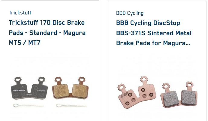

If you're using an MT5/7 caliper, the trickstuff 170s are great pads, but I still prefer the BBB BBS-371S pads over everything else. The BBBs last a little longer than the trickstuff, but it's the connected pads with the retaining pin hole that's the key. I use retaining screws to hold the pads and not the split pins the pads come with, but this setup basically eliminates any pad movement.  The trialtechs are great pads too.

The Trickstuff power brake pads wear faster than standard pads, the rotor wear faster too, at least in Enduro or DH use. For our discipline, there might be a difference, but not a huge one.

I use the EBC red pads on my MTB as well as my Hex but I see they only come in the MT7 style so I skipped those for now. Nice to know the seperate pads might not be a problem if I need to go that route. For now I ordered up some of the BBB pads Swoofty mentioned so I'll give those a go.
