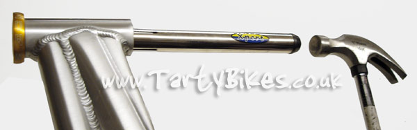

Spark plug socket-or as large a diameter socket as you can fit throught the headtube. Attatch to a fairly long extension bar and tap away working round the cup. once one cup is removed, rinse and repeat for the other one.
Don't use your favourite socket though :P
Im with the munn, spend a couple of quid on one of those proper job's and you'll have to stick it in the headtuibe, and simply whack it as hard as u can.
As has been said you risk flaring the headtube pushing it out side by side wth a screwdriver. Im really not a fan of bodges anymore.... especially when you could make one of those tool's yourself without much hassle.....seat post?

good to see someone (Tartbikes) has a decent priced rocket. might get me one o those.

They're called Crown Race Setters, Park do a nice one
