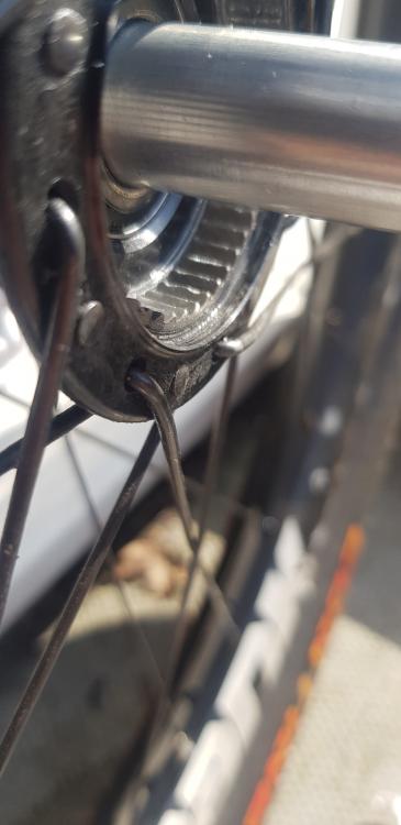

				Hope pro 4 ss trials and stripped ratchet ring thread
Sandbugg replied to andrey-p's topic in Trials Chat
I had a pro4 do this it was just after (like 2 rides after) the ratchet ring had been replaced by hope cos the pawls had chipped and mangled the ratchet ring teeth they changed the hub shell for me my hub sometimes misses a tooth / skips under low load like when I set up for something as opposed to putting the power (of which I havent much of) down As for the thread on a 2 vs a 4 the ratchet ring is a larger diameter on a 4 I belive so they can put more teeth in there -
