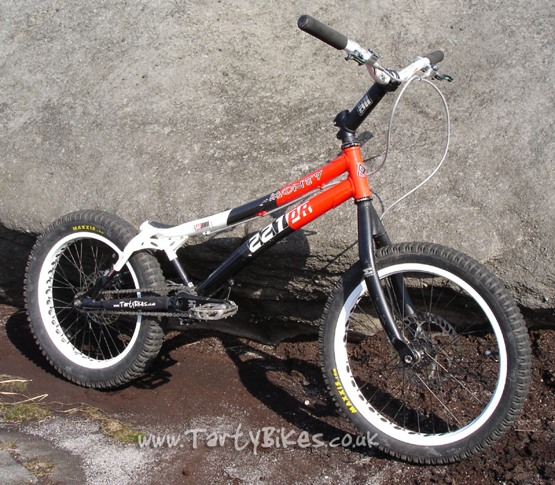

Just some updated pics of my bike... didn't wanna waste the great light today!
Side view.

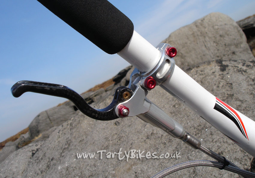

Pro Bolts and Carbon Lever Blade on both levers. Ti caliper bolts too.

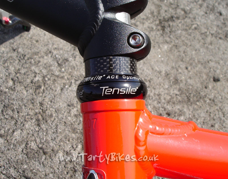

Tensile headset, carbon spacer, Ti steerer clamp bolts.

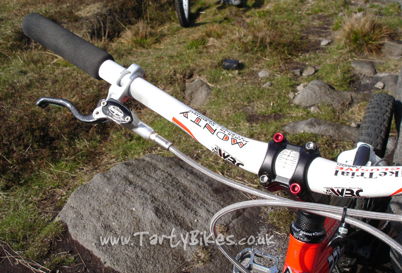

More Pro Bolts, 221 Ti White bars (you were right people, they're looovely!), Ti/Alloy Pro bolts in front stem clamp.

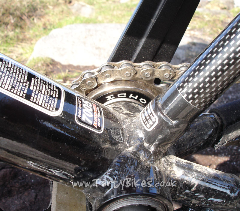

Echo freewheel (modified to 108 engagements).

Hows the tensile headset? im really considering one! it basicly a modified king like it expresse's in the topic in the news section?
also is that not a standard enco freewheel then? how did u modifie it to 108? just put a ENO / try-all teeth onit?

The headset has been great so far, as said in the news topic its pretty close to a King, no troubles yet anyway!
Freewheel mod: perfectly reliable for my riding, not particularly easy to do. It clunked a couple of times when bedding in but nothing at all on my last ride. It involves using 2 short, 2 medium and 2 long pawls (instead of 3 long and 3 short). I had to very carefully grind (file wouldn't touch them) a couple of long ones down, measuring with digital calipers to get them exactly the same length. The shape you need to make them is a little tricky too. Work on both ENOs and Echos. Obviously from a professional point of view I can't recommend anyone else tries it though :turned:
Despite carefully chosen parts the bike isn't actually that light, around 22lbs I think... which is why it annoys me when people claim their bike is 19lbs or whatever!

I was dubious about the Monty bars due to them being quite narrow and having a lot of rise/sweep, but I'm actually in love with them now! They seem to have made the bike feel more nimble and the shape just feels 'right'. Wouldn't mind trying 1/2-3/4" extenders in each end though...
