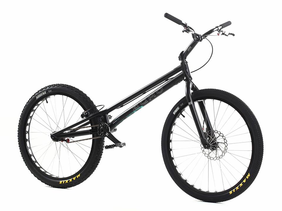

  10. Echo has started using EchoBIkeUSA's FB page as their primary page, and their USA distributor, is the admin. He is actually a super nice guy and easy to work with. I'm not sure how it works outside of the USA, but here shops order from a distributor in LA who gets freight orders from China and then ships them to the individual shops. It works well for since there are only a few (3 I think) Echo dealers in the USA and freight shipping items to LA is slow but very cost effective. The distributor was also running EchoBikeUSA as an online shop for awhile to sell direct to the American public, but it never really got past a website without products, and looks like that effort has stopped. The fb page now points to Echo.Bike and Echo.Bike points to the FB page, with the only artifact being the page is @echobikeusa on facebook even though it's renamed Echo Bike. Yes to the 2 piece crankset! They also need an update to their rear rim. I bent the sidewalls within a few hours on 3 different 26" rims, if they make it an h or I-beam shape it'll help keep the sidewalls stiffer, and the cutouts aren't the best shape.

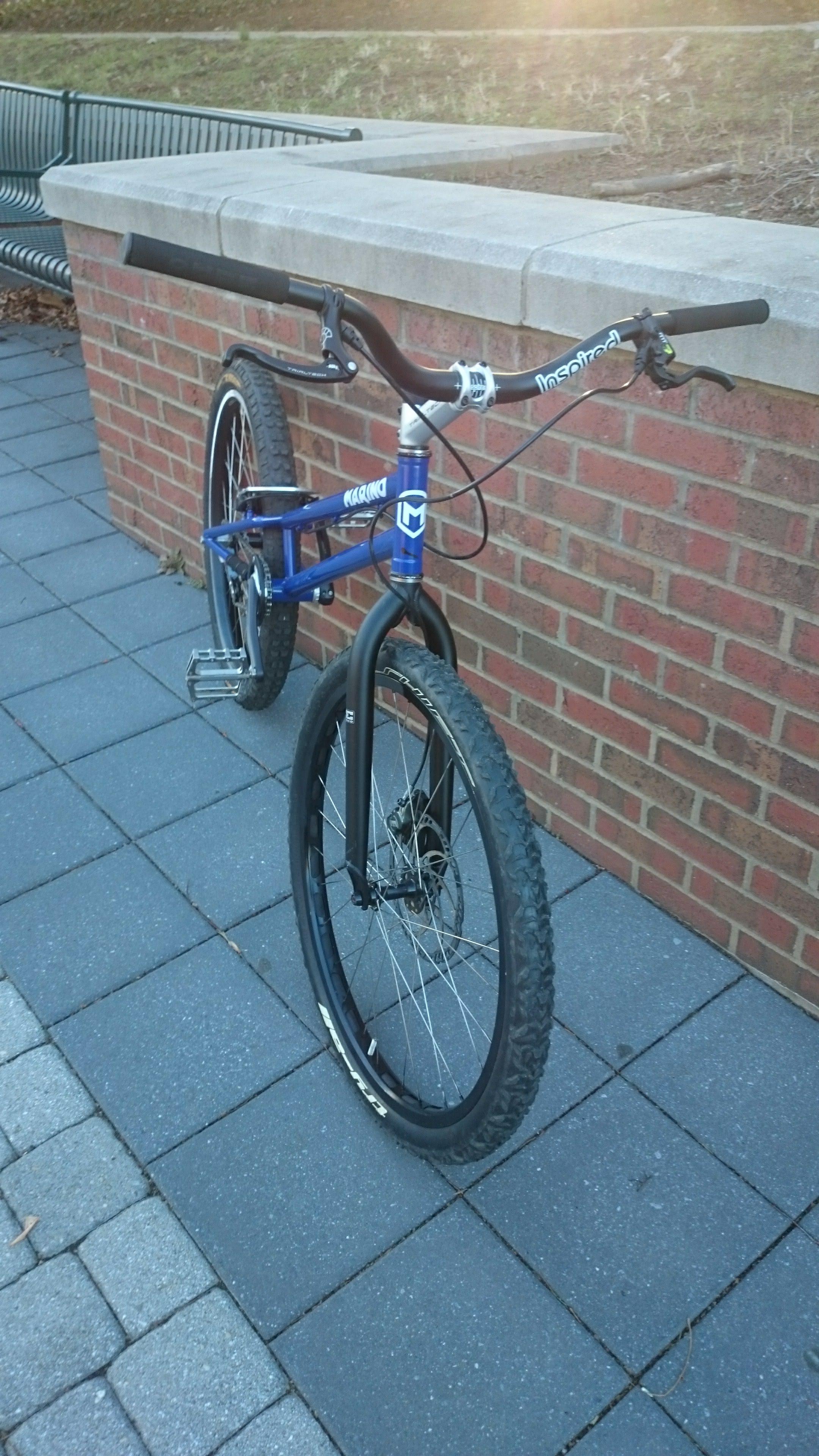

  21. Recently I got my Marino 26" frames back. (I have two identical frames, one in blue and one in red). The blue one is the fun build, so here it is. I'll update this thread as I make some changes to it. Geo is 1060, +80, 377, with a 73 degree headtube. Reach is 680. Either you think I'm crazy and the geo is just dumb, or you look at the numbers and think "hey, that sounds like a lot of fun." The long reach allowed me to go with a 130mm stem right off the bat and felt good. The goal is to have something that is more flickable and fun than normal modern pure bikes that still feels decent on rear wheel moves. The shorter wheelbase and slightly shorter chainstay make this manual nicely (not that I know how). I've got to work up some confidence on bigger rolling bunnyhops, but it should be nice. With the super high BB it still does rear moves and sidehops decently with the bars rolled back into a less visually oppressive angle. I liked the idea of MTB cranks and a hope hub on a pure bike. It took a bit more modification / grinding than I would've liked to get the cranks to work. Having the rim brake slave cylinders made the clearance super difficult and I had to sand the pads down to almost nothing and take about 1mm off the back of the drive side crank. At some point when I have some more funds, I may try a boost crank made for a 83mm bb. But so far this setup is AMAZING! It feels so stiff. Front Magura MT7 and rear Trialtech are a super nice combo. The Magura is working like crap since I moved it over, the disc mount must be at a slightly different angle or something. So far the rear trialtech Carthy rim is pretty nice! I love not seeing cutouts and it feels super stiff. The coust pads on it are a amazing. The rear heatsink tensioner is a bit sloppy looking. Originally Marino said he'd be able to fabricate a crewkerz style mount, but then wasn't able to figure it out in the end. Maybe at some point I'll weld one on myself (bonus of steel). Due to the gear ratio on this, there is just a lot of slack to take up. Maybe using a half link would help. I can put a hanger on it and just go with an old school two wheel tensioner too. At some point I will go rear tubeless on this bike. But right not it is fairly cold and my tires just feel like crap no matter what so I'm not stressing it. Tire clearance is a bit of an issue, I had to trim a couple center knobs a mm or two to get it to stop rubbing. The Inspired Arcade bars look incredible, but I am going to try my Crewkerz bars on my next ride. Between the 73 degree head angle and the streety bars, the front end felt so different it was hard to get used to.
  22. Nice! I may give it a try. My slx cranks are on a Marino with rim brakes. I had to shave my pads down to almost nothing to get the cylinders to clear.
  23. So there are a few topics on here about chaining clearance issues with mtb style cranks. Recently I spent a considerable amount of time with an angle grinder to get some slx cranks to work. Would cranks for an 83mm BB and a few spacers fix this issue? My frame has a 73mm BB, so two 2mm spacers in each side and then 2 of the 0.5mm axle washers per side and that'd work...right? Or am I completely missing something
